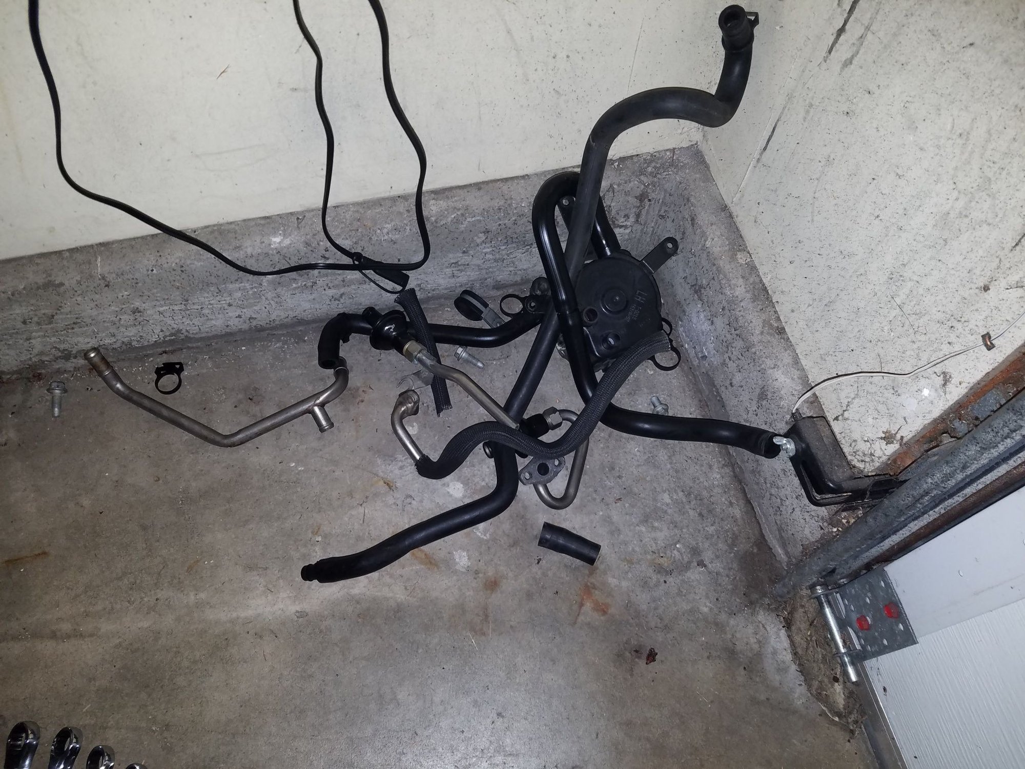

I pulled out the entire system, hoses, check valves (two) and the pump. Plugged the vacuum hose, pulled the relay and tuned it out.

I pulled that bolt with the intake on and engine fully assembled otherwise just for the sheer challenge of it. I don't recommend it to anyone. It was not worth it in the end. You can have the intake off the car literally in less than 10 minutes.
IIRC everything weighed out to exactly 10lbs for those that care.
