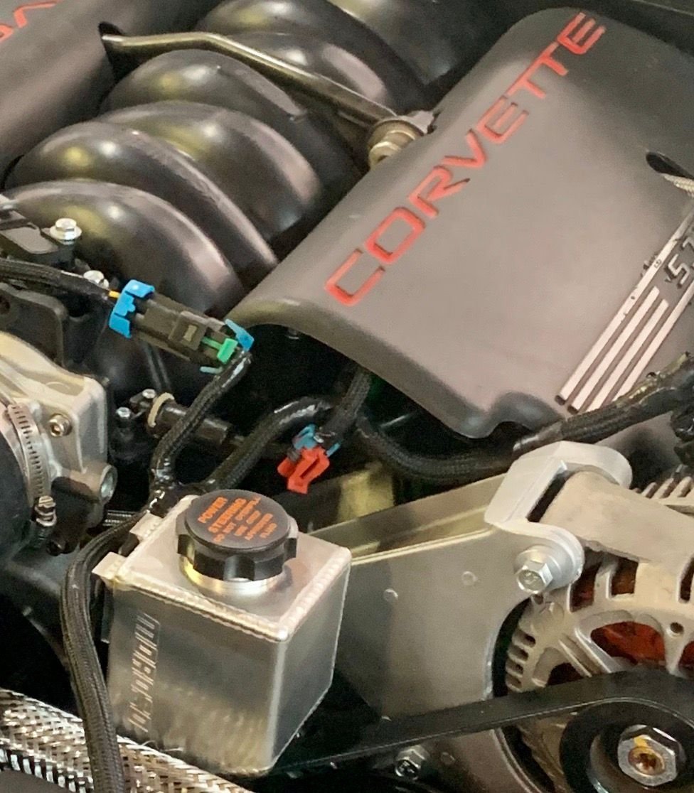

Ok so I have installed a Dorman LS2 intake and LS2 throttle body (silver blade) on my LS1. After using the two adapter harnesses for the MAP and throttle body control I have a left over plug on the original harness?? It is blue and pinkish in color and is on the drivers side of the harness. I have everything plugged in that corresponded to a plug and this one has no where to go. I have removed the smog pump and air inlets. Am I missing something here??

have a pic of it?... sounds like it might be the evap solenoid plug

Right above the power steering reservoir

I did remove the smog pump and inlets

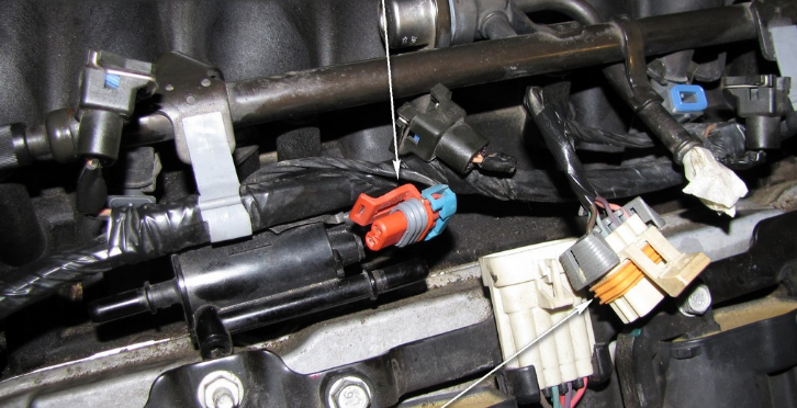

not my picture but pull your fuel rail cover off and check this, goes to the evap solenoid

Well...if that is it Im gonna be mad at myself....I have looked all over this thing but didnt check that when I put it back on

Welp Im an idiot...that was it! Thanks a bunch!
