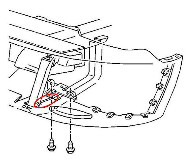

Did you finish the install? If so, did you have to cut a slit on your bumper on the bottom side, where the square holes are for the skid plate bar? I'm afraid this might be the only way to install the bumper so the skid plate bar doesn't "push down" on the bumper. My paintshop finished installing my new bumper but they warned me about this and showed me the old bumper had the slit cut whereas the new GM replacement did not come with the slit cut. They didn't want to cut the new one but I'm afraid we're going to have to because it just doesn't look right from the bottom.

Not completely finished yet but almost. I have the exact same thing, old one was cut and new one is not - yes you do need to cut it like the old one

I personally find it so odd that the GM genuine factory replacement front bumper needs to be cut to make it work. Why would GM not have this pre-slit from factory then? Could it be that maybe the bumper should've been installed simultaneously with the skid plate bar to slide the bar through the square holes of the bumper?
PS: After analyzing the skid plate bar, there is absolutely no way in hell to install the bumper any other way properly than to cut the slits. It came out perfect after the slits. The good thing is too that you can cut the slits on the bumper after installing it, in case you forgot to do it beforehand, and carefully accommodate the two folds over the skid plate bar.

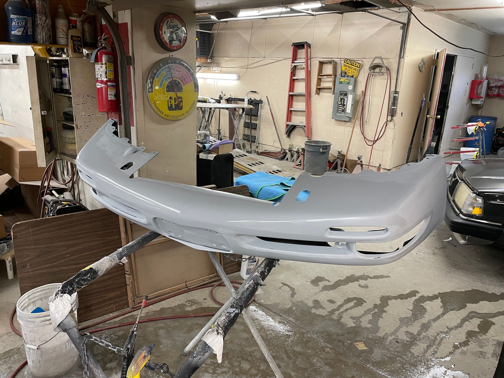

Just got done priming an OEM bumper - I'm glad GM keeps it 1pc - much easier to sand, prep & paint. Slice at assembly or before base coat with a sharp utility knife! goes right through the plastic where there are grooves on the bottom side.
