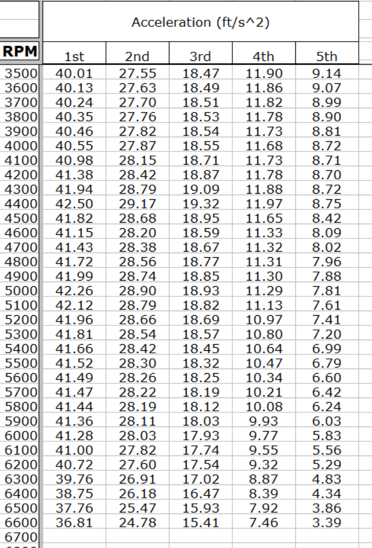

No. When torque is reduced power is also reduced. And thereby acceleration. There are mathematically bound together.
Ok. Here is a table showing acceleration for a car similar to a C5. More power with similar gearing. You can see that at every shift except maybe 4 to 5 you will loose acceleration after shifting. When gears are so far apart this will happen in all cars.
