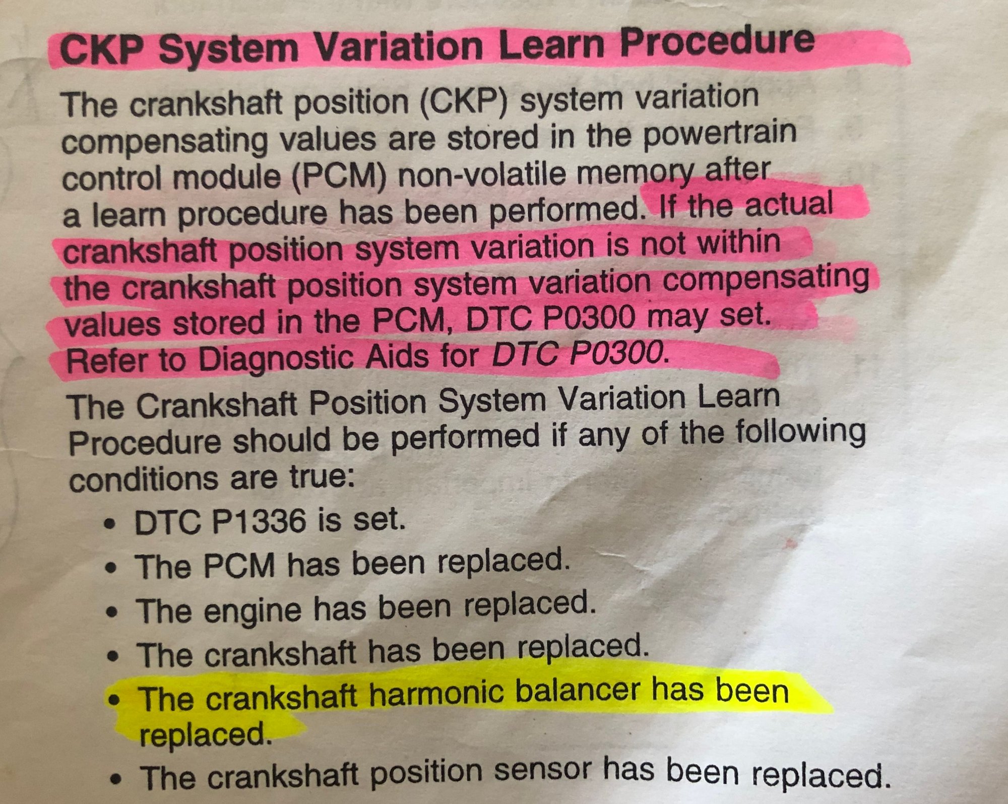

When changging that seanor you MUST preform a " crank angle sensor relearn procedure " anyome with a TECHII or simillar device or tuning software such as HP Tuners or EFILIVE can do this for yoiu It may not be your issue but it is a must when changiing cam or crank sensors

What evidence do you have to support that it is a “MUST”? I know several different people that have successfully changed both cam and/or crank position sensors without having to do a relearn. Just curious because I was under the impression that it wasn’t necessary.

OK you two !!...there is nothing that says you HAVE to do it but as you can see it’s right in the FSM...not really for the cam sensor as the crank sensor because that is the sensor the PCM gets its info for misfires...it’s looking at both amplitude and frequency of that Crank Sensor (Hall Effect Sensor) if you have ever seen what the waveform
looks like on a scope.
