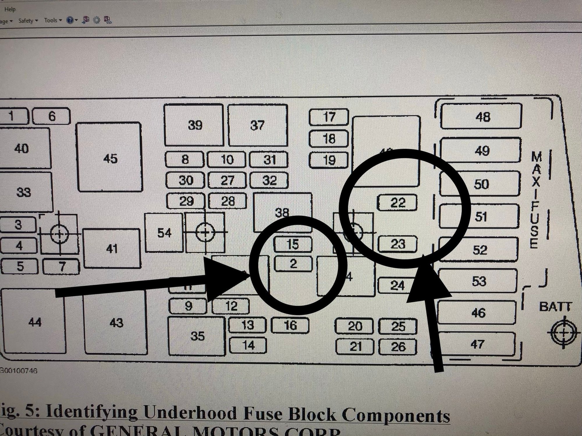

i have a 98 coupe and want to turn off the DRL's i pulled the number 2 fuse (22) and when i started the car it ran like it was hitting on 3 cylinders i double checked to see if i pulled the right fuse i put the fuse back in and the car ran fine...please help

Don't know what you meant in your statement..." i pulled the number 2 fuse (22)" ????.....you pulled 2 or 22 ???....fuse #2 (approach lights) is the one you want to pull NOT fuse 22...fuse 22 is an injector fuse which powers the fuel injectors AND coil packs !!...no wonder it was running like crap...you were running on 4 cylinders !!

c5 Diag thank you so much for for your info i read the number 2 on the schematic and thought that was the one...this is the greatest forum on the web !

pulled that fuse and it worked just as you said however my goal was to run the foglights as DRLs but in order for that to work you have to turn on the parking lights which defeats the purpose if anyone can help me with that that would be great thank you in advance

SUPER !!!...good job !!...always try to go by the fusebox diagram when looking for these fuses. Have a great weekend !!
