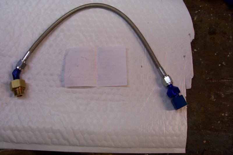

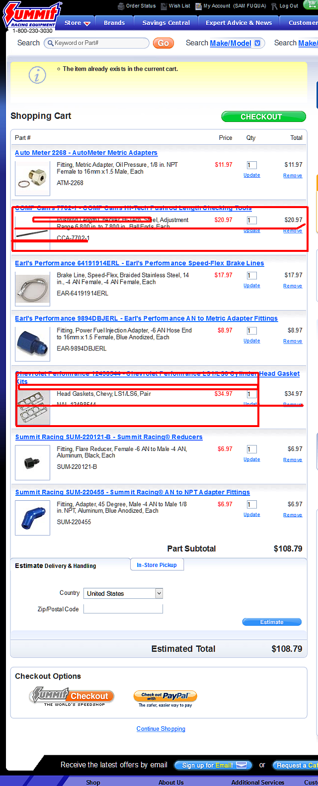

The guys already mentioned the oil sender relocation kit and seat track fix. If you do these yourself its should be under $100. I just did the oil sender relocation kit from parts that another member listed on this site from Summit Racing. You do have to remove the intake manifold, but its an easy job and will be much easier the next time the sender goes bad. The other thing I would suggest is searching the window regulator "whack method" My window stopped working and this method got it working fine again. The just tend to get stuck.....Now this was a free fix so it was nice...Good luck

OPS relocation parts list you will need from Summit racing..

Sweet, definitely going to try the "whacking" method! And I might just do the sender relocation, makes sense I suppose! Thanks for the help guys.
