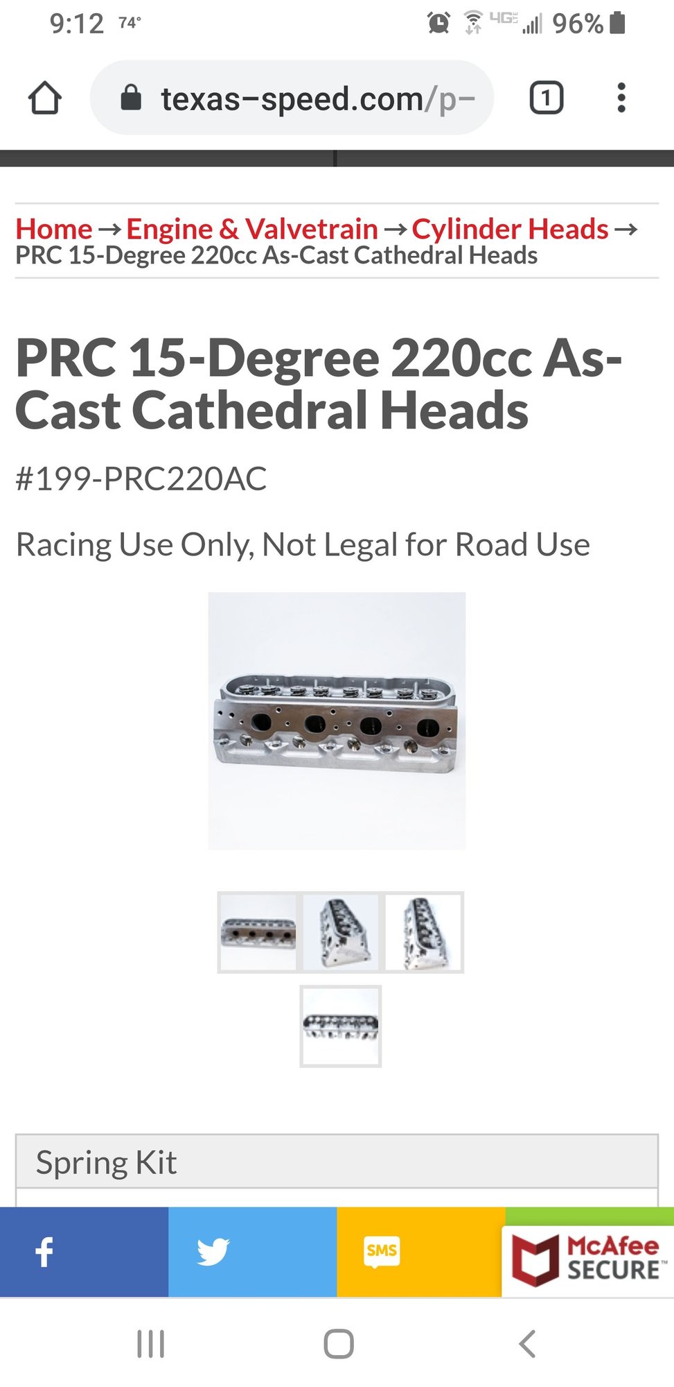

Anybody running these on their C5 with a 6 speed manual. Doing Cam and long tubes and I am considering using these heads after talking to the Texas speed consultant. Says they flow 310CFM@.600 lift. $1500 Shipped.

The heads also have much larger than stock valves.
2.045" Intake / 1.600" Stainless Valves
I read a thread where a guy at TSP put them on his C5 Z06 and picked up 30rwhp
Because the cylinder-filling on our smaller bore engines isnt as efficient as say an LS3 (which has similar head flow numbers to the PRCs) I wouldn't go too crazy of a cam, and try to get the 60cc combustion chambers for higher compression for my particular use of my car. If you go with too large of a cam, you'll run into clearance issues with the pistons, even though I'm sure it'd be happy to rev out that far with less compression.
