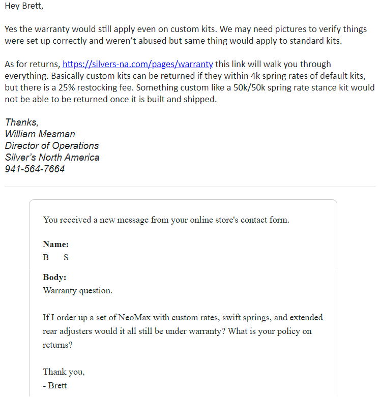

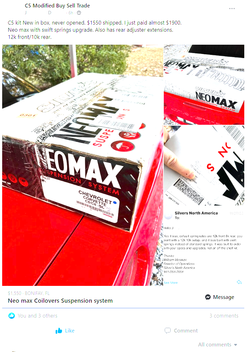

Today in a C5 Modified Buy Sell Trade ad I saw a guy selling a brand new upgraded kit which he paid $1,900 for (Great pricing), now selling for $1,550 (a steal if someone is looking!). Silvers NeoMax using upgrades Swift springs in in 12k/10k rates which the primary vendor site suggests for Drag / Auto-X use.
It appears to have been shipped five weeks ago on 11/15 and also appears to have the manufacturer's branded tape intact on the box. Brand new in box springs to mind if you pardon the pun.
I wouldn't think anything of it except that it has an attached e-mail dated 11/29 (well within ANY typical return date range) from the manufacturer's Director of Operations, North America - a Mr. William Mesman - where it appears to politely inform the buyer that a return cannot be effected because they only accept returns on stock springs with stock spring rates. This infers that Silvers as a manufacturer will not honor returns for anything not base model.
We as consumers spending big money must then ask the question: Will Silvers honor warranty coverage on anything not "off the shelf"?
This is important when the primary vendor offers 11 variants of the kit (22 if you add the option of Swift Springs) beyond off the shelf status. That number MIGHT be higher if the extended rear adjusters are interpreted by Silvers as not meeting their definition of off the shelf.
Food for thought. If this helps JD get his full money back - awesome. If it does nothing other than raise some manufacturer awareness.... maybe we're due for a dose. Or maybe that manufacturer needs to improve their customer service. They could take a few notes from their vendor who typically bends over backwards for his Corvette clients.
Note: I did edit JD's full name, FB profile image, etc out of the screen capture and associated saved images.

Turns out the bigger issue is a 25% restocking fee.
Silvers says they will warranty custom orders.
Both sound fair to me. Good.
