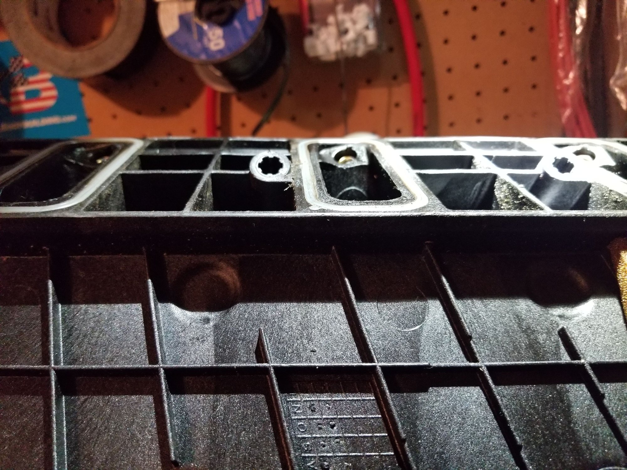

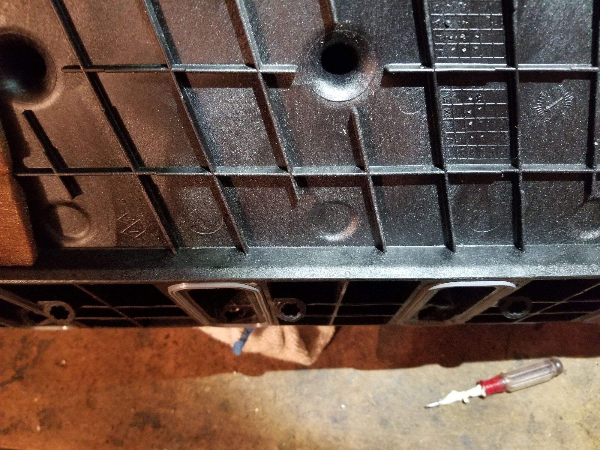

I had the same problem and found my intake gaskets were not sealing before and after!
