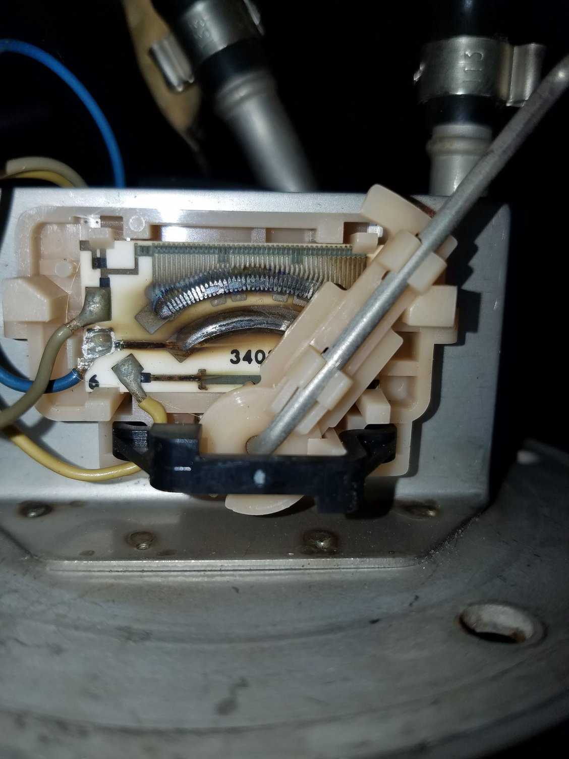

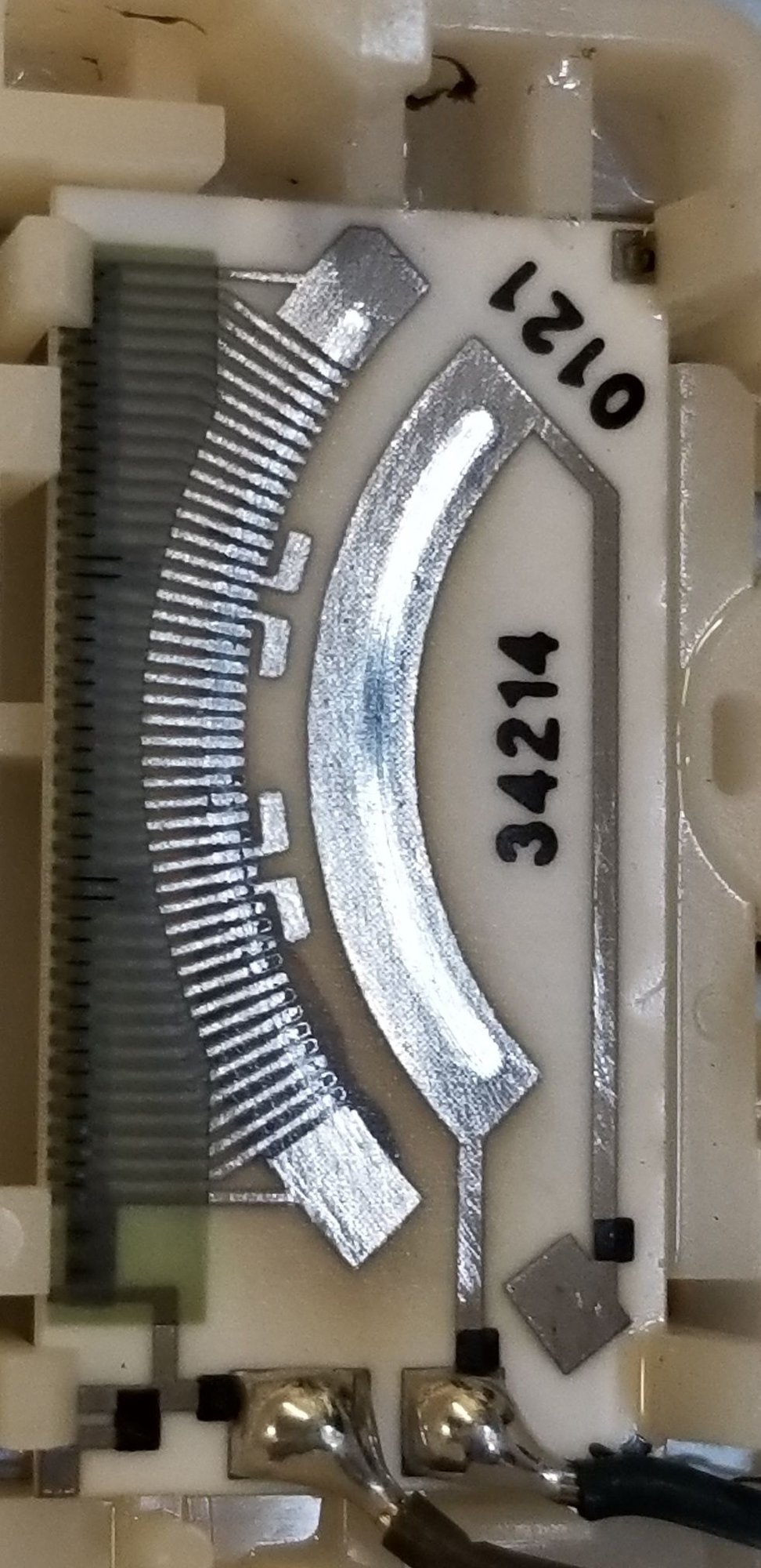

Almost every tank this past year has thrown a P1431 code and sent the gas gauge to zero just after passing half-tank, so I was aggravated enough to tear into it today. I had already run the tank down to the last 2 gallons, then pulled the passenger side wheel well liner, fuel tank shield, and removed the sender for a good cleaning. The float arm removed pretty easily by removing a black plastic retainer. I used both a pencil eraser, then a light emery paper to remove the 18 years of buildup from the contact surface. The two electrical "pucks" on the float-arm side did not need much attention.
During the test drive after assembly, the passenger tank reading was a rock-solid 0.71V compared to the variations noted last year. Hopefully this 90 minutes of cleaning will solve the issue for a good many years.
If you're thinking about trying this, run the tank down pretty far, and jack the back end up high to prevent fuel leakage when removing the sender. An empty gas tank with fuel vapors can be more dangerous than a full one, so keep it ventilated.

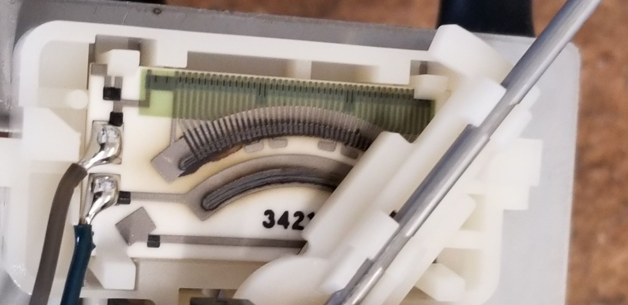

Just to toss this in there. If it looks like this don't waste your time. After 8 bottles of techron i gave up. LOL
