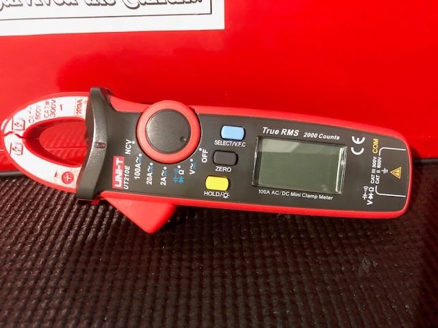

A weak fuel pump can give you the stuttering and misfiring due to a lean condition. I would try cleaning your MAF if you haven't done that yet. If you get a hold of one of these amp clamps (pictured and I don't think Harbor Freight Tools has made it to the Islands yet) you can clip it around either the power or ground wire at the pump and read the pumps current flow...easy to do OR use the ammeter setting of your multimeter if you have one and place the leads between pins 87 and 30 of the fuel pump relay with the key ON...most multimeters are limited to 10 amps but if your pump is weak you will see a low current flow...I believe my pump draws around 5-6 amps...you can try cleaning the ground G401 inboard of the left rear tire...it would suck to change a pump and continue to have the same issues !!...check those codes !!
