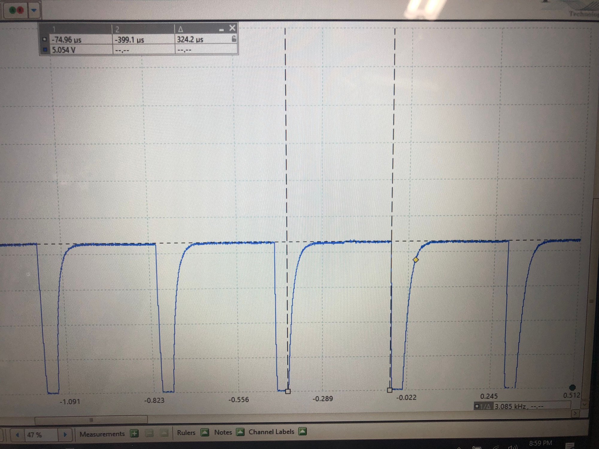

What color wire are you reading the 12 volts on ??....MAF has 3 wires and 2 for the IAT sensor....with sensor unplugged you should have 12 volts on the PINK wire...5 volts on the YELLOW wire and close to ground on the BLACK/WHITE...if you read 12 volts with positive lead of DVOM on PINK and negative lead on BLACK/WHITE your power AND ground are OK if you read battery voltage (12 volts) !!...with the connector plugged back in you should read less than 5 volts with key ON probing the yellow wire to ground with the DVOM...can't remember the exact number (mine was 4.95 volts) but it should not be 5 nor 0 volts !!...if your DVOM has a frequency setting that is a good way to check the MAF sensor with engine running !!...you should be around 3000khz at idle....this is my MAF sensor using a scope...it is a digital 0-5 volt square wave !!
THIS IS WHY YOU ALWAYS CHECK THE WIRING BEFORE REPLACING PARTS ESPECIALLY SENSORS !!!
