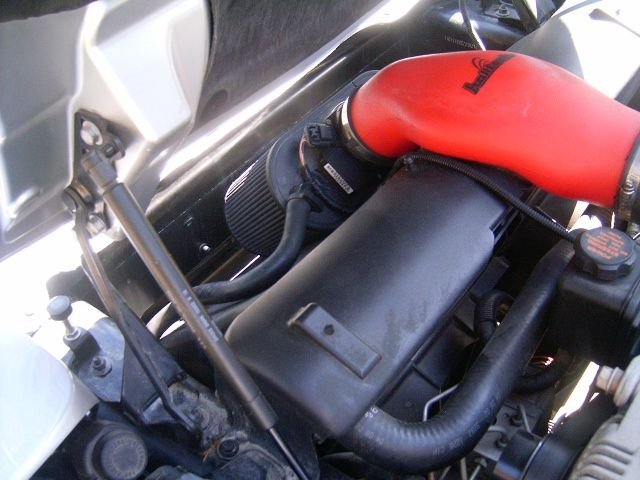

Thanks, first time sending pic., hope it works.

That's aftermarket, maybe K&N hard to tell. You can clean that one, look for instructions on K&N site (assuming that's what it is). To install original stock filter you will need the factory air box.

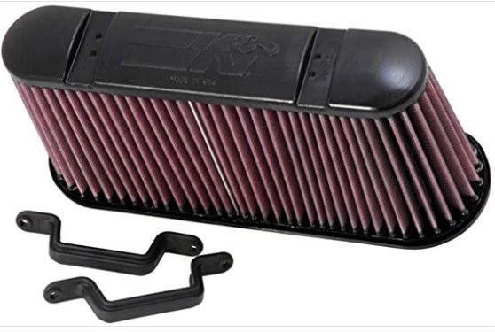

"Name Brand" filter will have their name on it, remove it and take a look. K&N claims their's is good for 50K miles, if you clean it properly. Some filters are oiled some are not, need instructions from mfg.
This is for a C-6 but similar

IF you do have a K&N filter on the car, the filter will have an embossed logo on it (per the pic). Most auto parts stores will carry the K&N Filter cleaning kit and there will be instructions for the cleaning process and re-oiling. It's real easy to clean the K&N filters but be careful when re-oiling! The oil will be in a spray can so just use a very light coat. Too much oil and it will get sucked up into the intake and cause running issues.

I'm pretty sure that this is a Hallteck stinger air cleaner.
