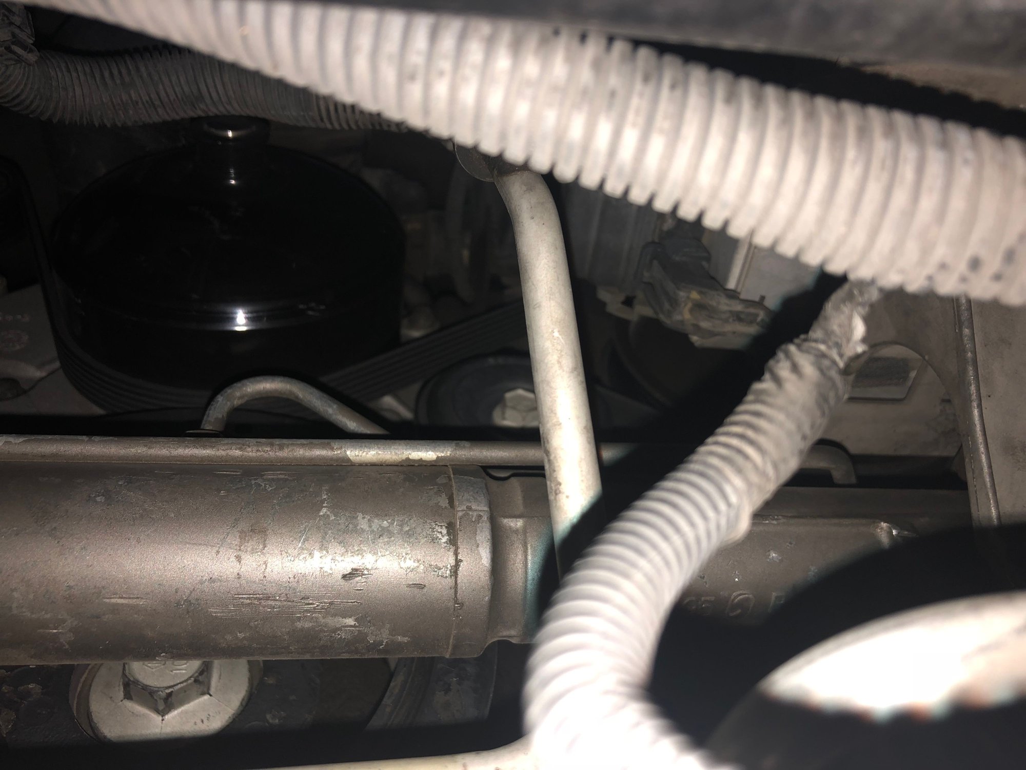

Thank you for the reply! I believe I kid diagnosed it with a power steering leak cause it appears to be the high pressure line right where the metal tube meets the rubber

Well, that's probably not any more fun than a coolant leak, but at least you're on the way to solving it.
