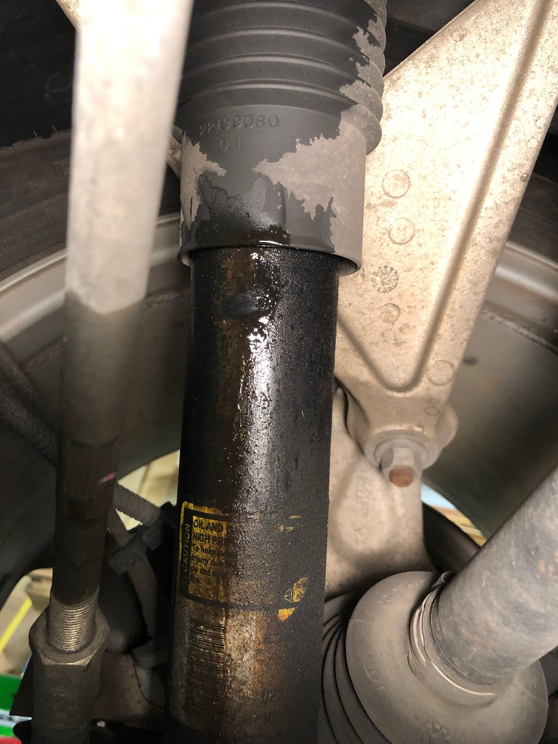

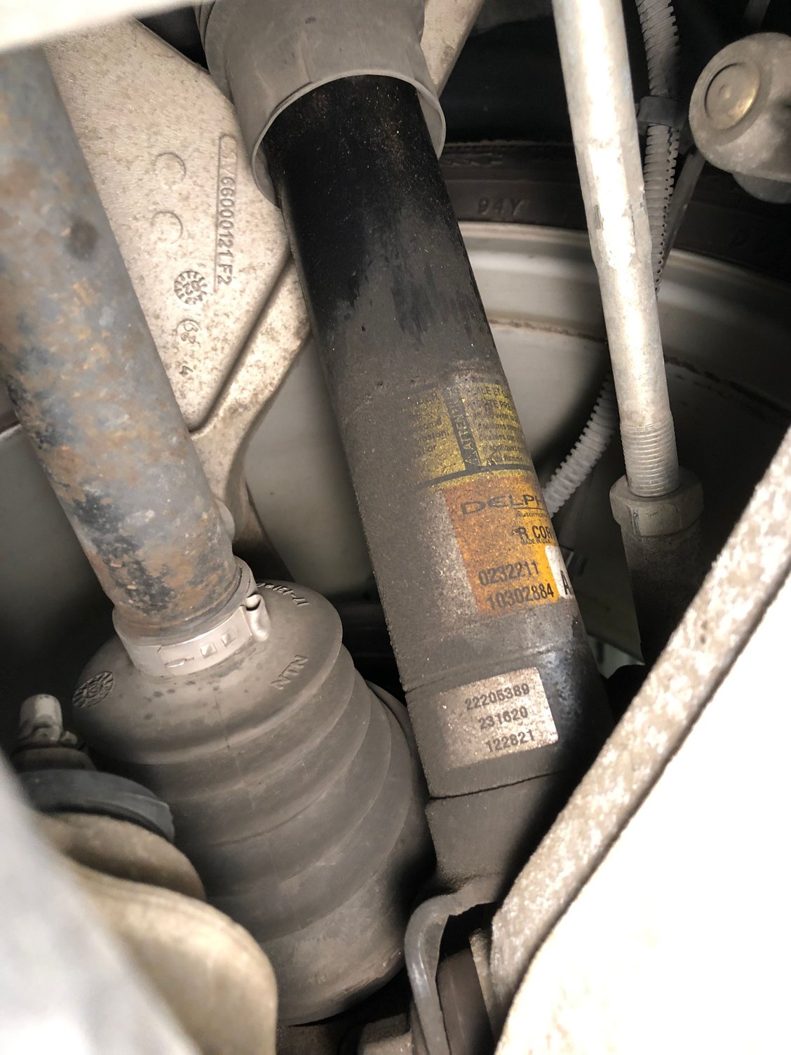

Got under my 03 Vert today for the first time since purchase about 3 months ago. The driver side rear shock has a pretty significant leak. This is the F55 selective ride control system.
Based on the photos, do I need to look into replacing this shock? My intention is to keep the vehicle 100% stock, so I'll bite the bullet and shell out for a replacement F55. Do they need to be replaced in pairs (or, God forbid, on all 4 corners at the same time)?
Driver side rear
Passenger side rear

Yes, absolutely needs replacement. And you can replace just one, but chances are the others aren't far behind.
F55 shocks are obnoxiously expensive and poor performers, but you do you.

I replaced mine as they were needed.and the rears are not as expensive as the fronts. You should be around $350 to $450. They are not as uncommon as they once were so the price has come down somewhat.

How is the leaking shock affecting the way the car drives. I have the F55 and my rear shocks have started to leak. The ride seems not to be affected so I have not replaced them yet. The lifetime warranty maybe makes it worthwhile to replace them now and may be good insurance.

Definitely rides a lot harder - the leak in that shock is significant - like dripping - so it was definitely time to replace. The other 3 are a little damp but not really leaking yet.

The thing about leaking shocks is that they rarely leak suddenly. Unless damaged externally, what you get is a slow degradation until eventually seals don't hold properly. This often takes 50-100k miles. You've been feeling a shock that gets worse and worse for fifteen years - gradually. When you swap to a fresh set, you'll feel an immediate difference. Of course, even more so if you swap to a different set.

Completed the replacement of the leaky F55 shock last weekend, not a difficult job at all - just obnoxious trying to compress the replacement shock so you can fit it in place.
I believe the ride quality is considerably better than before - especially given that it was the driver side rear shock, which sits right behind me. I think it was worth the expense; others think it's a waste of money. In the end, I'm happy so that's all that matter to me!
