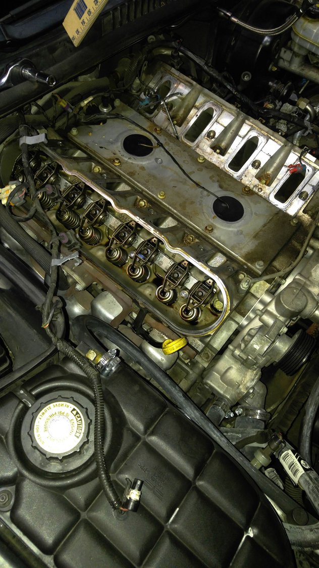

Its time! I replace the plugs last thursday due to 3 of them being caked will oil. It was not we but enough for the plug to not fire, 2 days later the same 3 plugs had oil contact but not as bad.
Im assuming the seals are foul and who knows what else until i take it apart.
The question here. Is where can i source a good set of valve seals and springs but with stock specs? No point to dump money in a cam and head job since i will swap to ls3.
Also any input of parts to be replaced while its open.

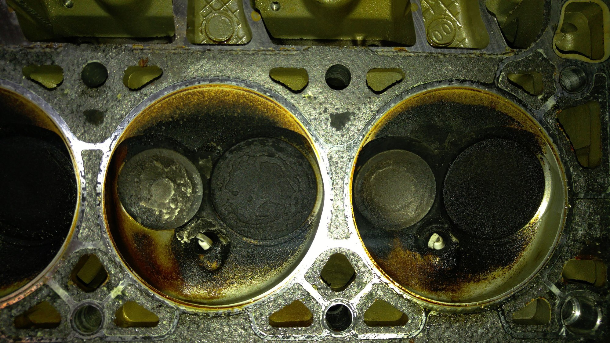

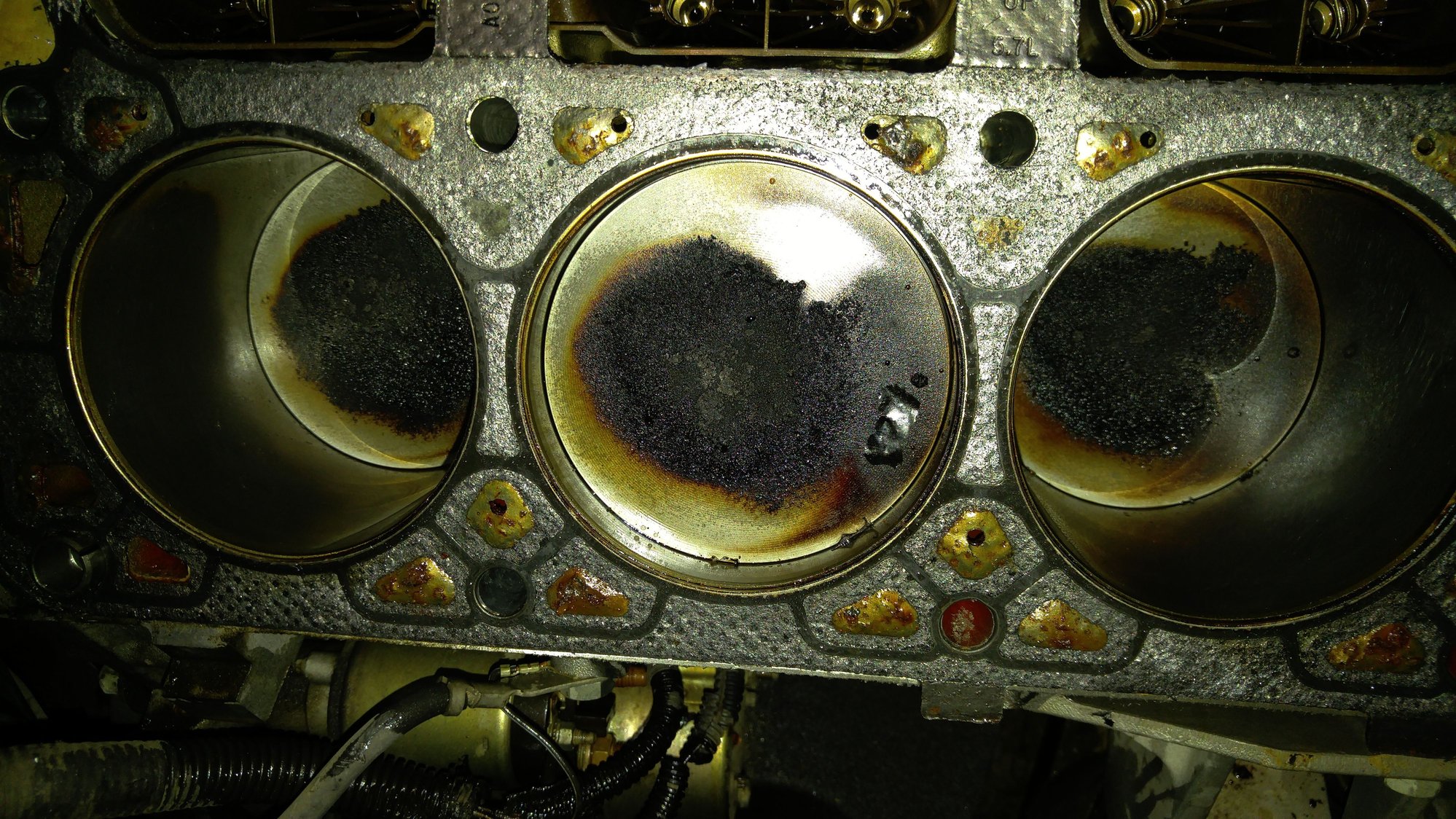

Pistons dont look bad

Update: The valves to have a small leak as expected and a rebuild will cost $285 for both.
