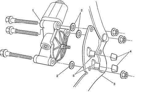

This behavior is typical of missing or damaged rubber bump stops (No. 4 in diagram below). Even if they look fine to the naked eye, they might be scored too deep. You might need to replace them (4 per side). You can get them here.
In addition to that, there is a TSB addressing those symptoms that calls for shimming the driver's side motor (No. 2 in diagram):
