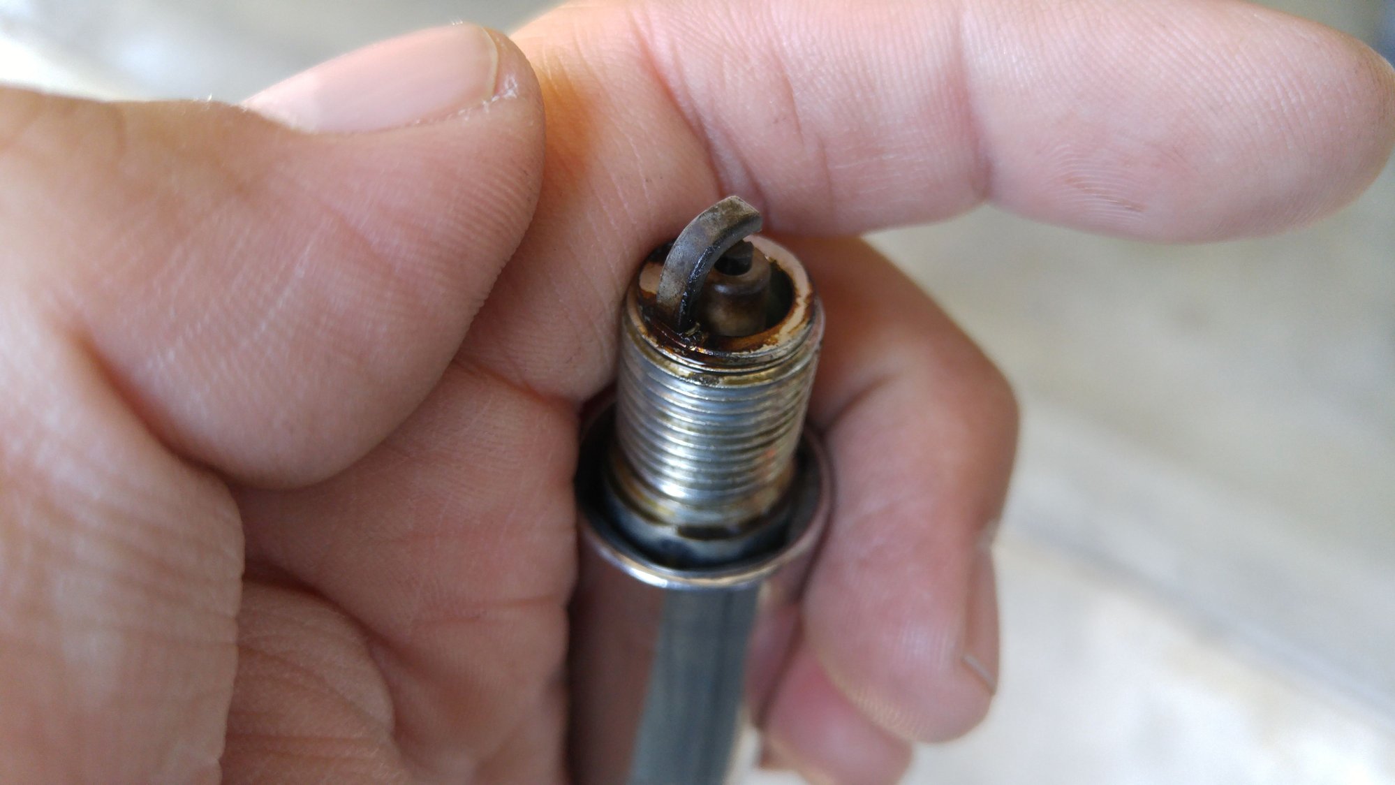

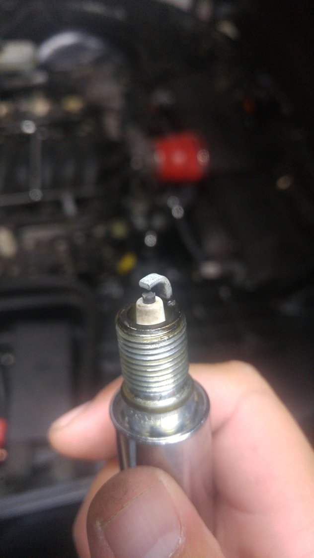

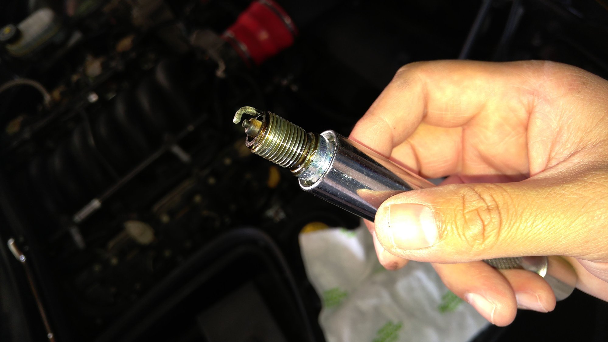

Let me start with just showing 1 or 2 plugs.
Engine specs: STOCK 100% stock tune so far
Engine duty: DOUBLE, daily driver and high speed runner.
Same plug
Same plug
I've had a few worse but bare in mind plugs last a few months for me. Also this is a very recent swap and 1 week later meaning right this very moment, 1 rear o2 sensor has failed.

the replacement looks normal, the ones you took out look like sh*t... looks like there is oil on the threads as well, does it use oil or smoke?
The condition of the replacement was only 4 days after the one that looks like sh*t. I'm thinking it had to do with the o2 going bad.
No smoke unless i punch it but happens every now and then, yes it uses oil but not enough to say "time to rebuild" thats why im rebuilding the heads and excited to see what they look like and i know its very bad. I'm thinking the valve seals are wasted but then also thinking the piston rings are almost done.

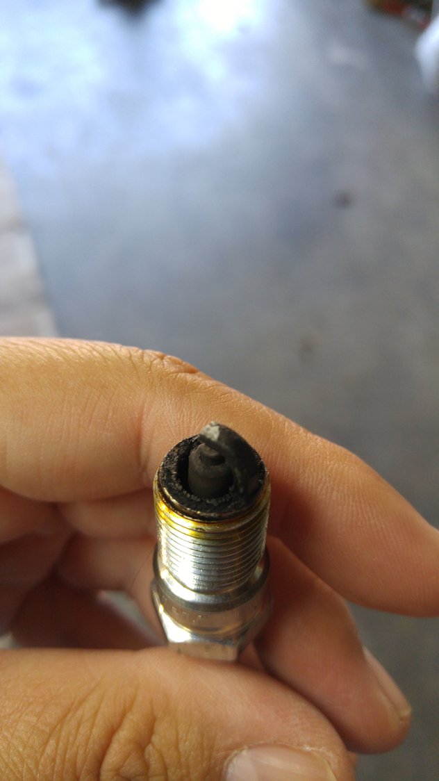

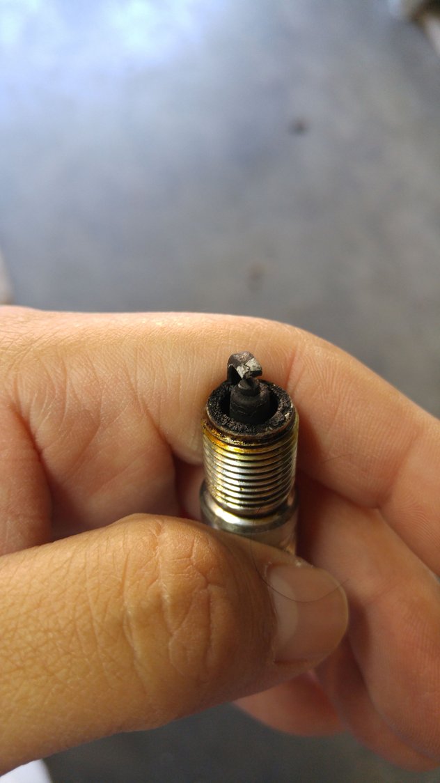

New pix: spark plug hole # 2 cylinder and plug. You can see the oil on the base of the threads from the plug. I have a total of 3 plugs that foul and is getting worse, these 3 plugs are being sprayed with oil and i have an odd smell when i punch it.No sign of any oil leaks around the heads

Well its done. After only 60 miles on the new plug its done.

So what are we getting at here? you showing us dirty spark plugs because there's an internal engine issue?

Title of the thread says it all but now onto a new thread for a rebuild.
