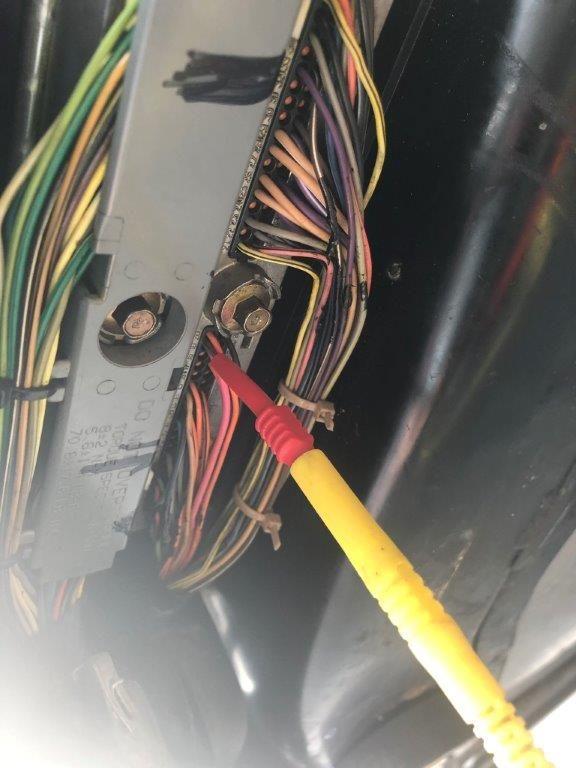

The P0327 is the front knock sensor so if you replaced the sensors and harnesses already without having to access Connector C112 again behind the intake manifold I'd backprobe the wire at the PCM using T-pins (pictured and you can pick them up at a craft store or use a sharp needle) and see if you have some "AC" voltage (less than 1 volt) with the engine off and probing Pin 51 (dark blue wire) at the PCM C1 connector...you may have some wiring issues between the replaced harness and the PCM where the wire terminates at !!...there are 2 connectors at the PCM...C1 and C2...you will have to pop off the gray cover to backprobe the wires...if you squeeze the ends and pull down the cover it should release on that end (pictured)...be careful or you may break the 2 tabs on each end...with the DVOM set on a low scale like 2 volts with AC selected tap on the engine block as in the video and see if you read something...the other sensor wire is a light blue wire at Pin 11 on the same PCM connector...if you don't feel comfortable doing this I'd suggest taking the car to a shop that does electrical work !!...I'd erase the 0327 code and see if it comes back when the engine is started but before you turn the engine OFF and see if it shows as a "C" or current code...it should NOT because the engine has to be warm, engine RPM between 2-3 thousand and above idle !!
