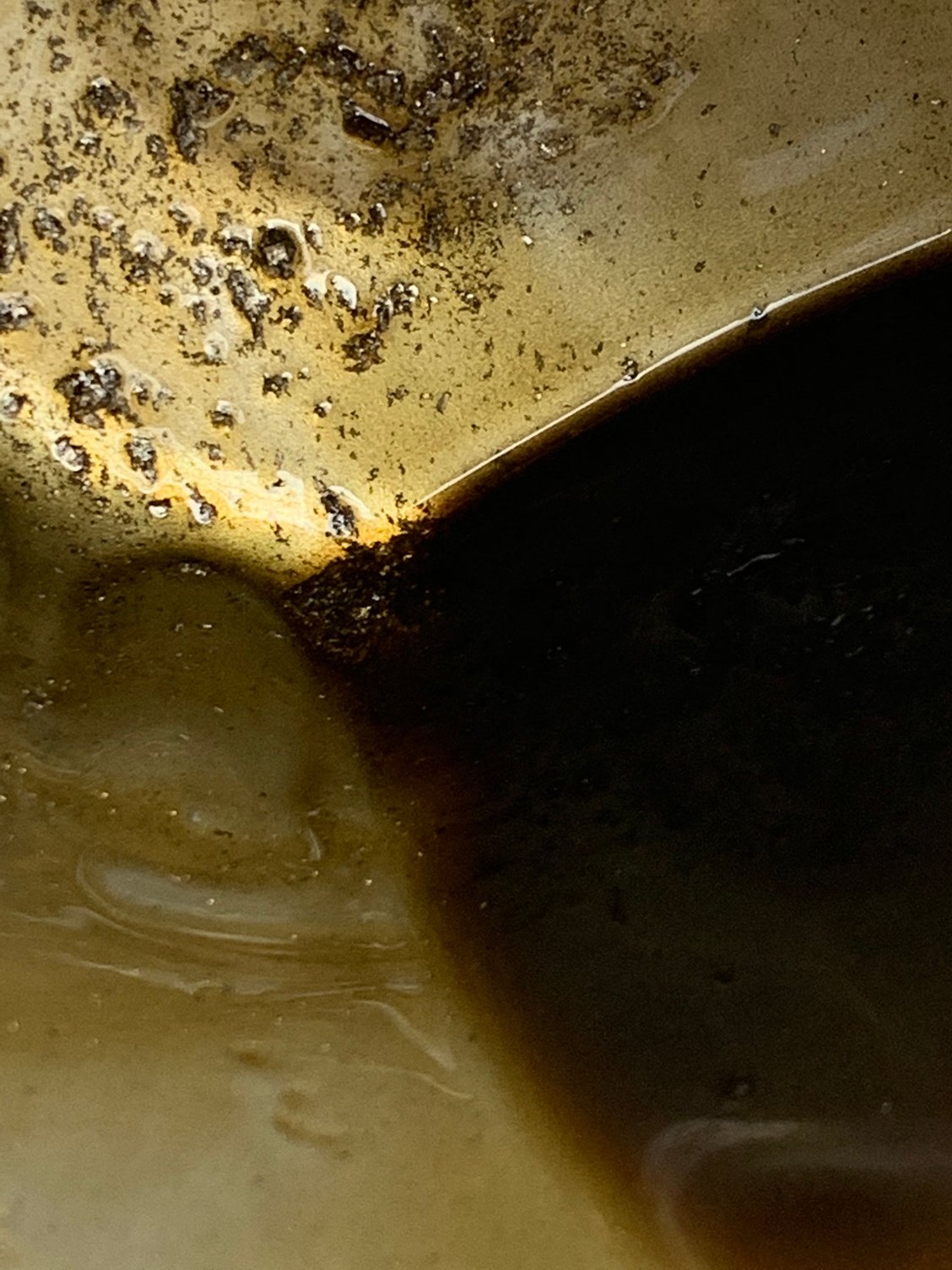

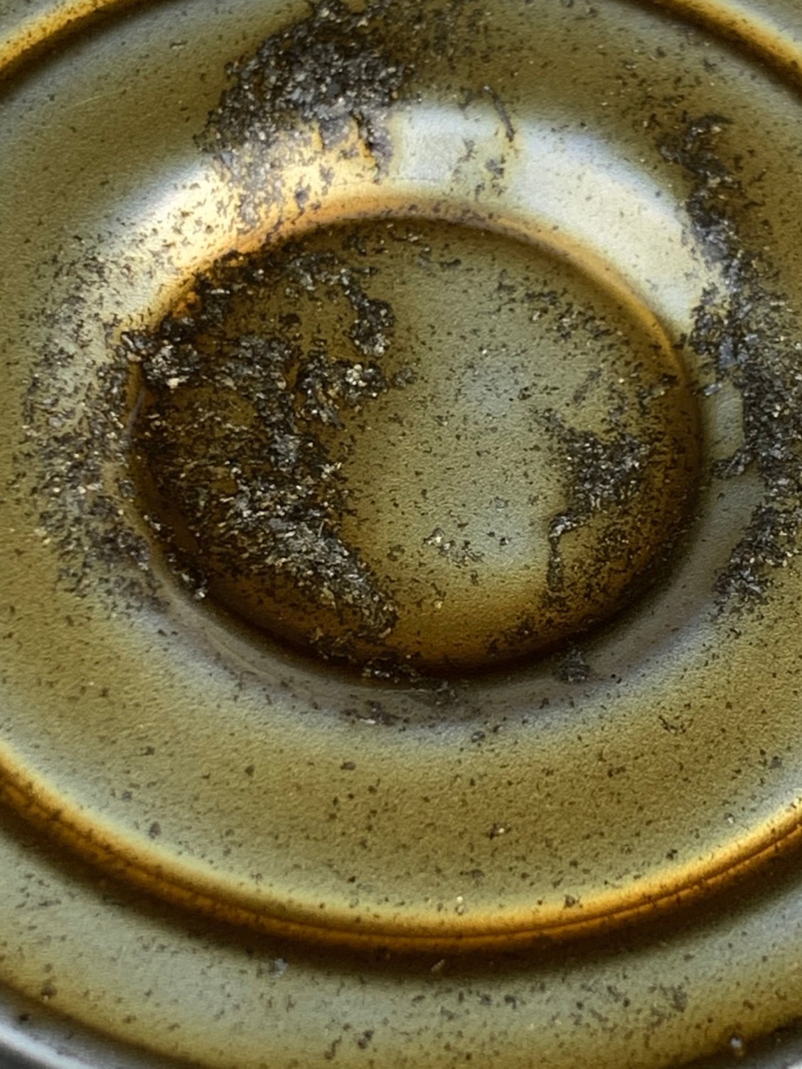

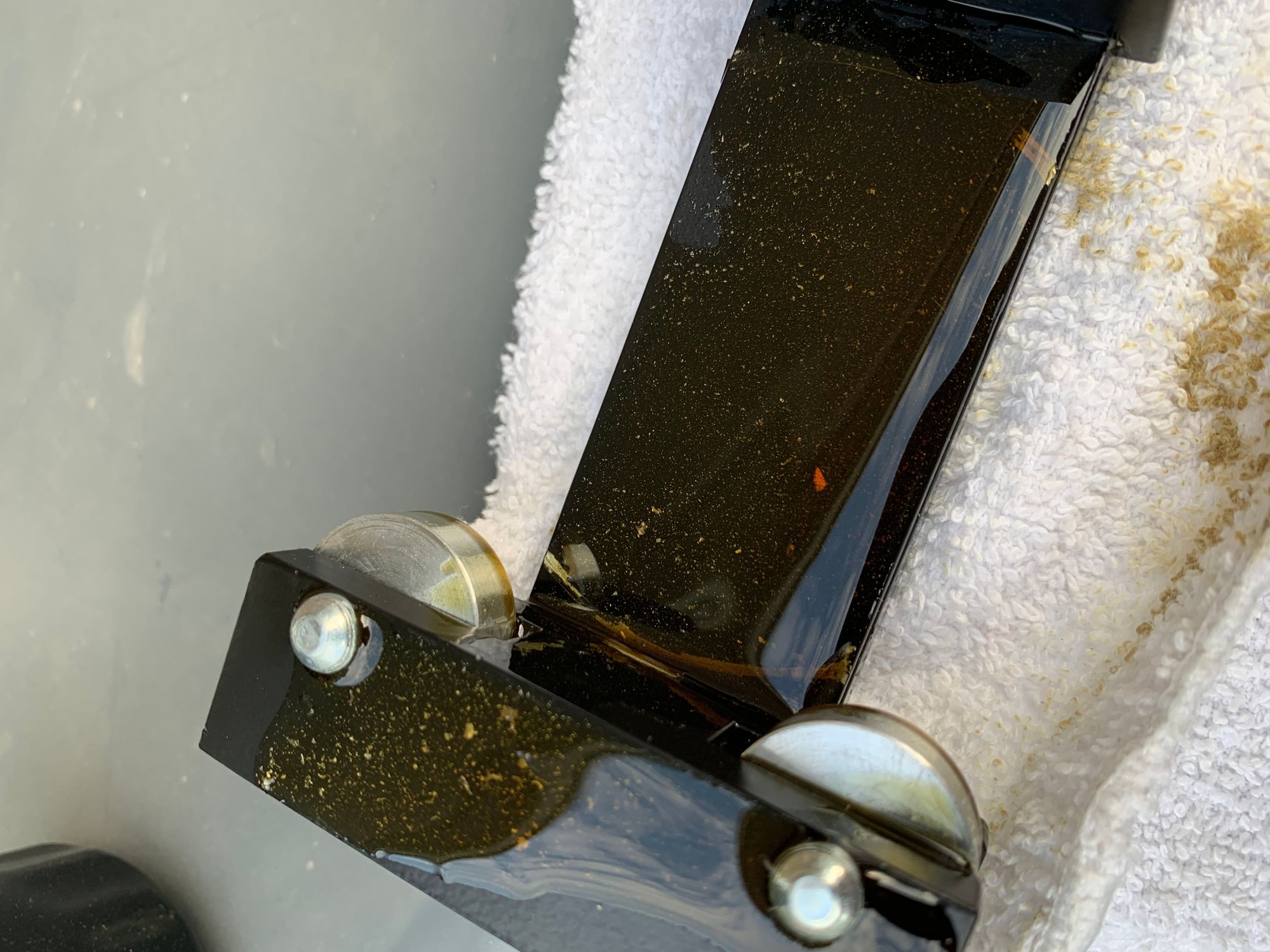

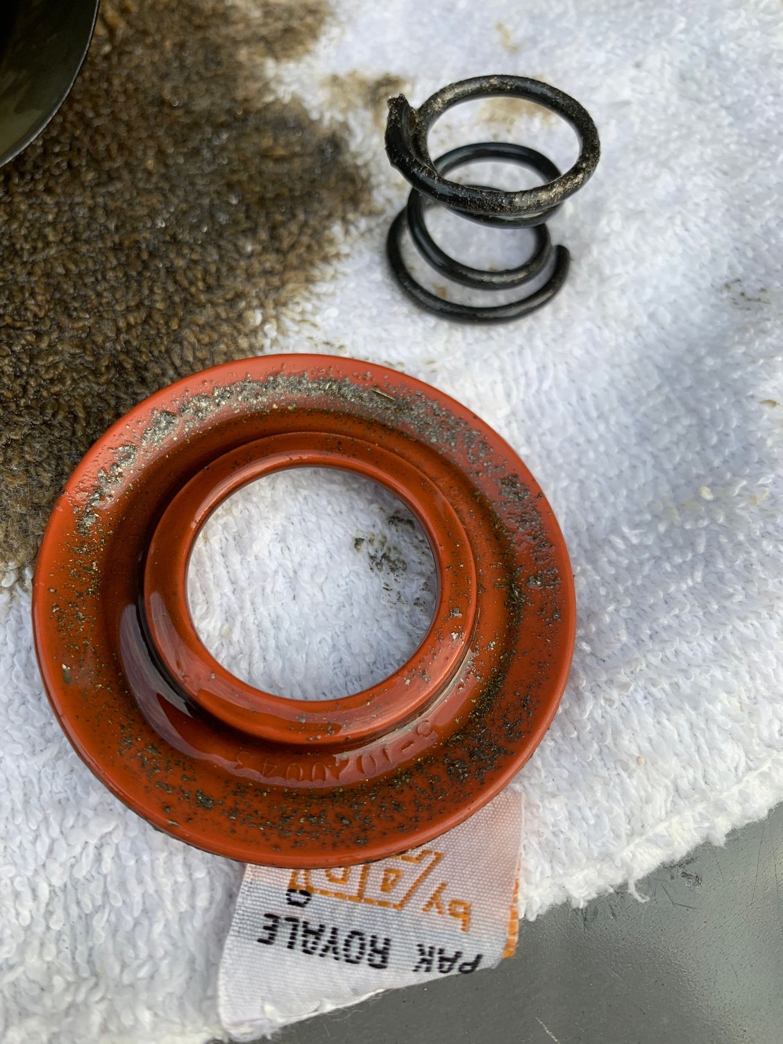

Pictures show cut open filter following a lifter failure after 600 miles following H/C/I upgrade
Residual oil from filter after lifter failure
Bottom of element
Back flow stopper and spring
Bottom of filter cup

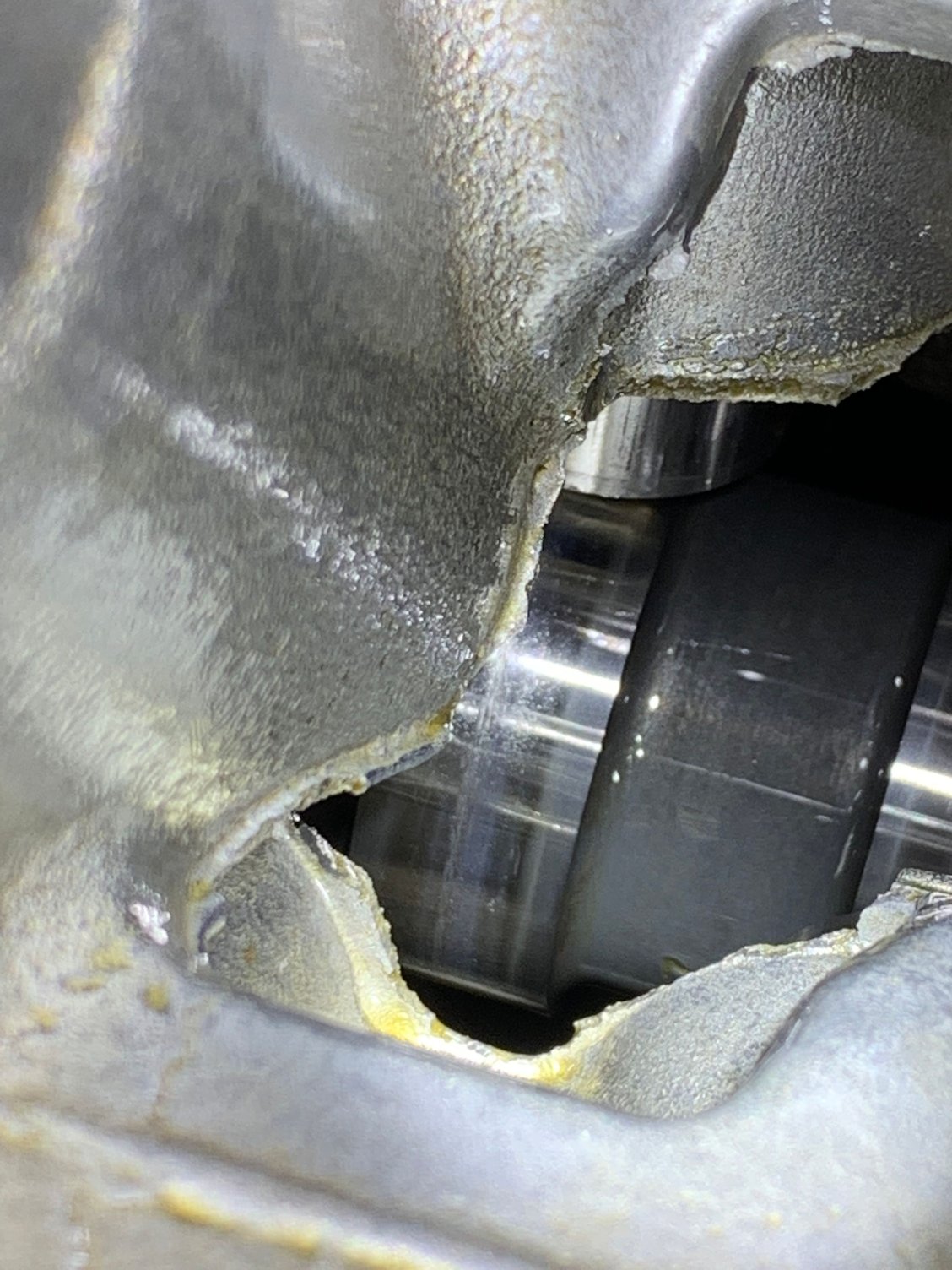

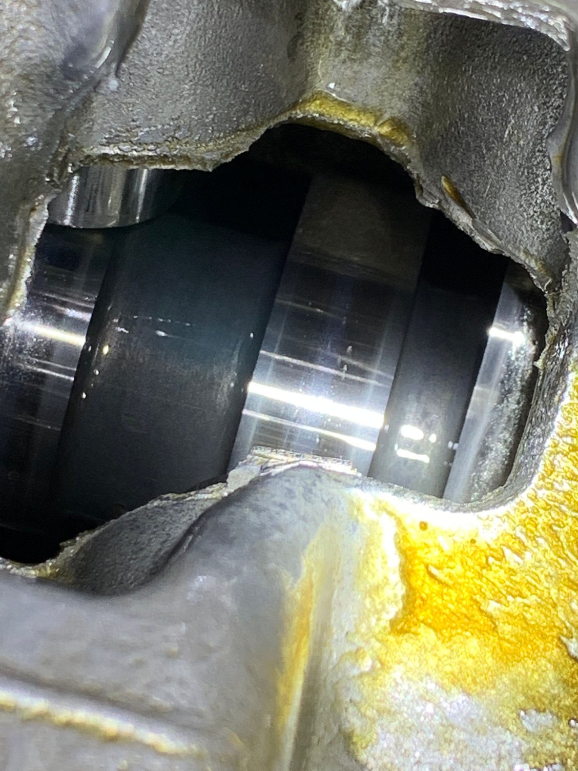

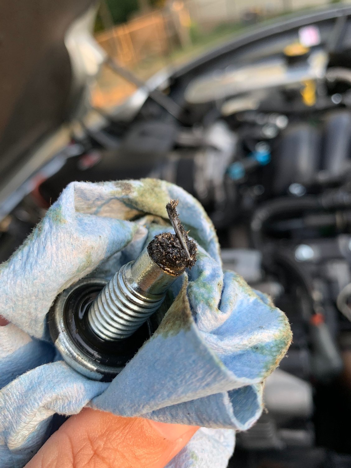

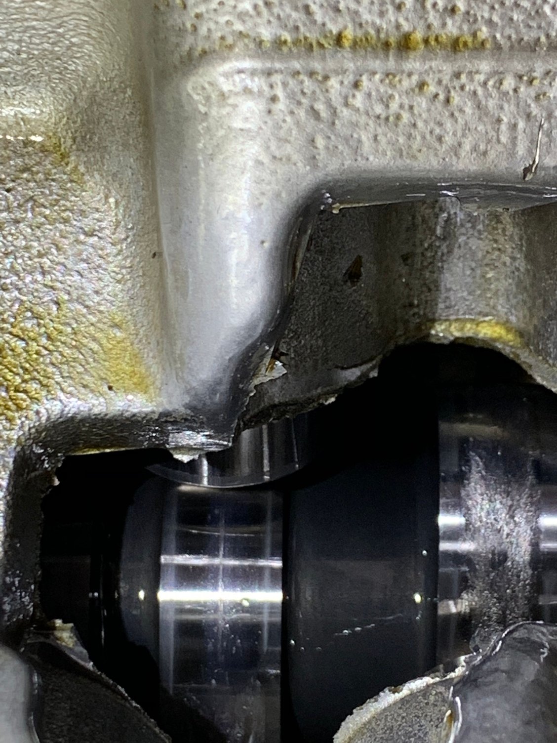

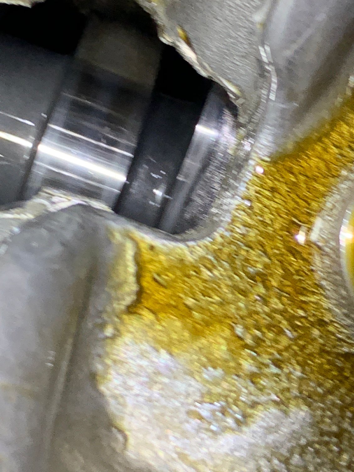

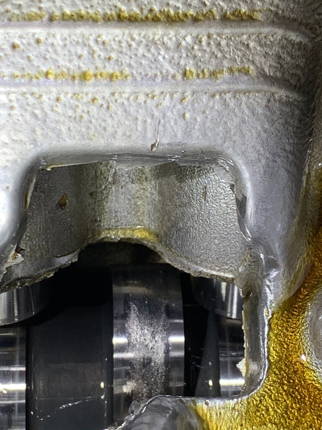

Here is the current view from the valley cover and what the oil plug had on it

Wait a minute... Is that a flat tappet cam? No rollers?
No that is a TSP 228R with LS7 style lifters
Old Oct 2, 2019 | 02:36 PM
frodo84's Avatar
frodo84
Uneducated autodidact
Joined: Feb 2001
Posts: 5,410
Likes: 250
From: West of the Sabine, Texas
I can't see the roller part.

Well I can at least assure yall it has or had rollers lol
If you say so!

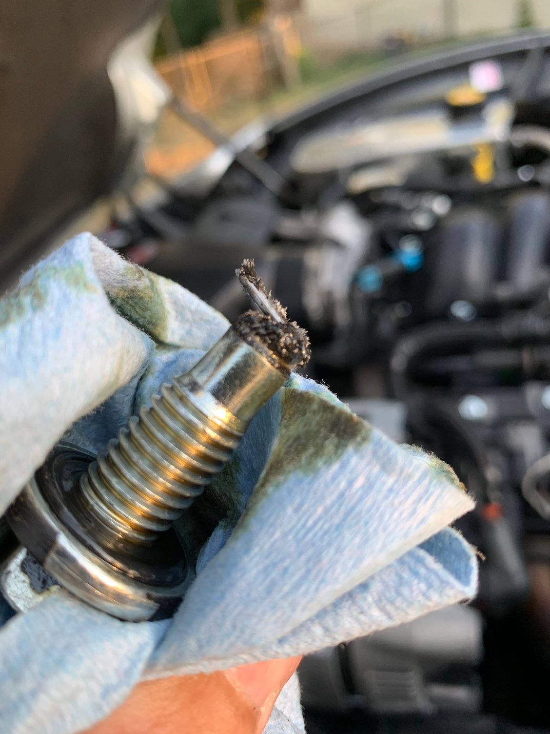

I see a needle on the drain plug. But it looks too big to have come out of a lifter. And those lifters sure seem like a plain ole bottom to me.
Very strange.

Care to share any details of what happened and what made you start digging in to see what was wrong?
sure does seem to be a lot of metal for a wiped cam lobe.
Sure, it started ticking and it at first sounded like an exhaust manifold leak. Then it changed from that to loud knocking. That was only 600 miles after getting it all back together and tuned. Dropped the oil and found the shavings and the needle bearing, so by size it had to be a lifter and that is what it sounded like knocking, so I pulled the valve covers and valley cover.
