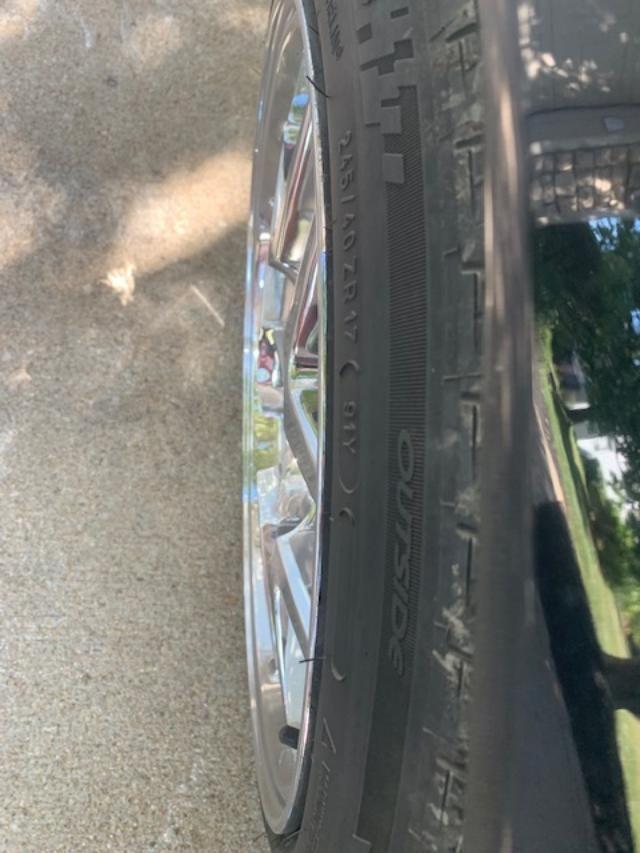

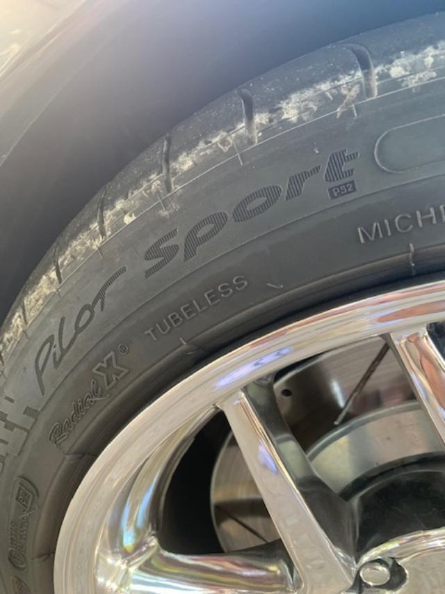

It is my understanding that most if not all tire manufactures have stopped making the correct size tire for a C5 ZO6 wheel. I am looking for suggestions for somthing close for the front wheel that will protect the wheel and not have the side wall fold in as seen in the attached photos.

A 275/40 will fit but some say the sidewalls look a bit tall in comparison to the rears. I'd find a set of 18" rears put them on the front and go with 18's on all 4 corners. 275/35/18 front, 295/35/18 rear.

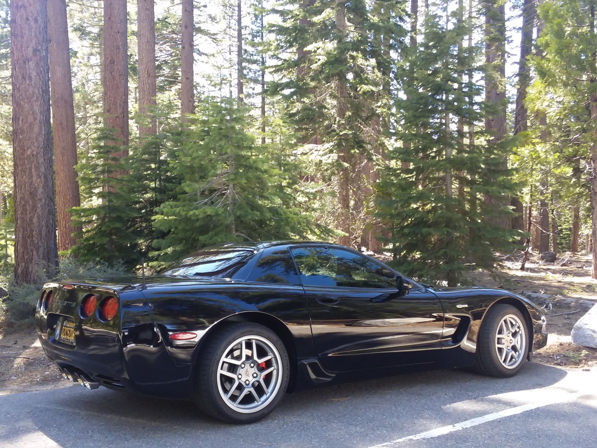

Here is my Z with Continental Extreme Contact Sports, 275/40-17 front, 295/35-18 rear. Great tires!
Steve
