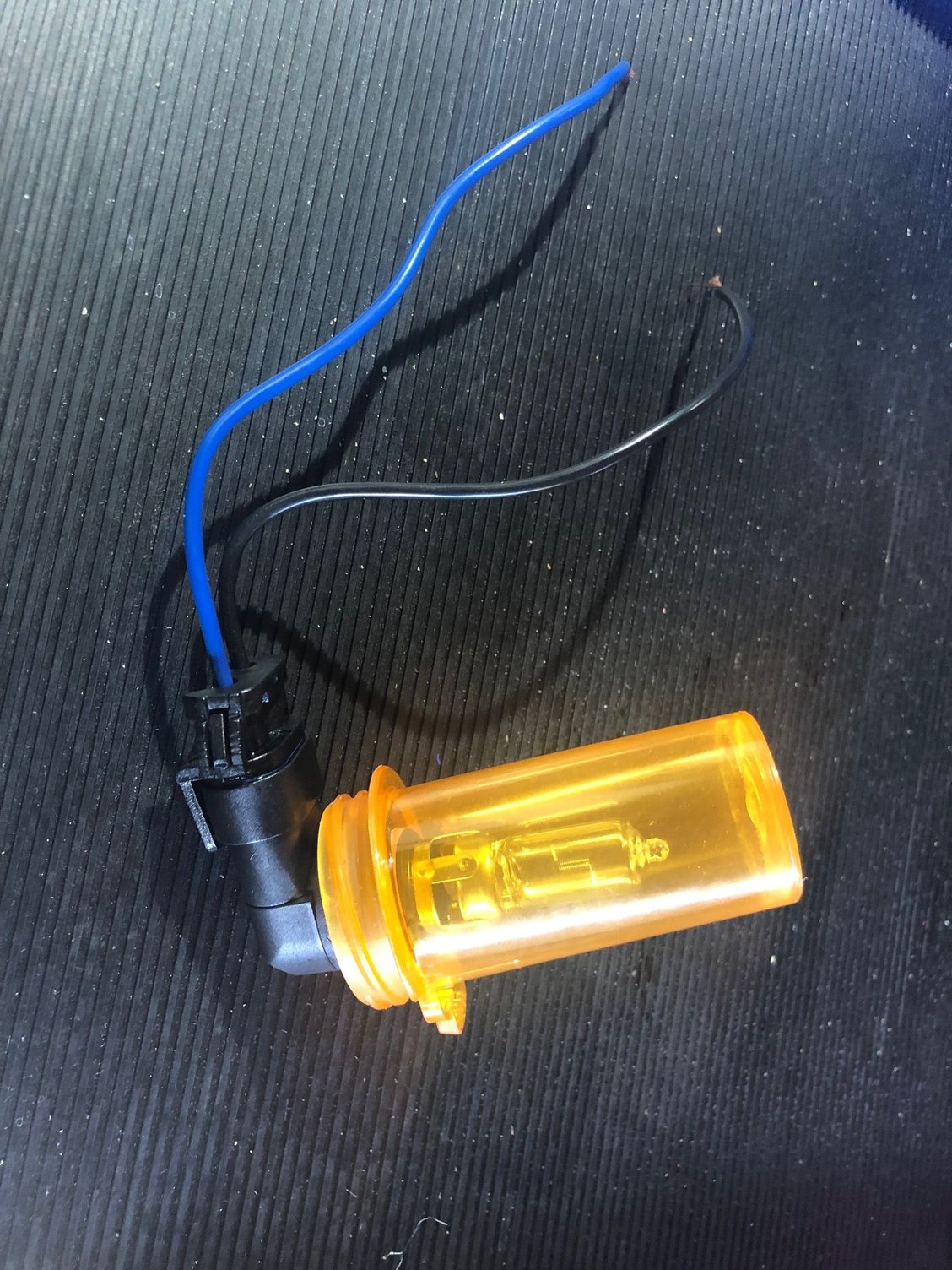

OK, so it looks like we have a Bank 1 Sensor 1 heater circuit issue ( left front)...first get underneath and see if you might have some wiring damage. The brown wire on the harness side is your 12 volt feed and the black wire is a body ground. With an ohm meter and with the sensor cold see if you have 3.5-14 ohms of resistance on the O2 sensor side...if good you need to check power and ground...see if you have 12 volts at the brown feed wire key ON...to check the ground it is best to LOAD the ground circuit...the O2 heater draws around 1.556 amps (on my car anyway pictured) so get yourself a 55 watt headlight bulb with the wires attached (see pic below)
and now attach the power wire of the bulb to the power feed of the sensor harness (brown wire) and the ground lead of the bulb to the black wire of the harness...if the ground can carry the current the headlight bulb will burn bright...if the bulb is dim we will need to look at the ground circuit !!

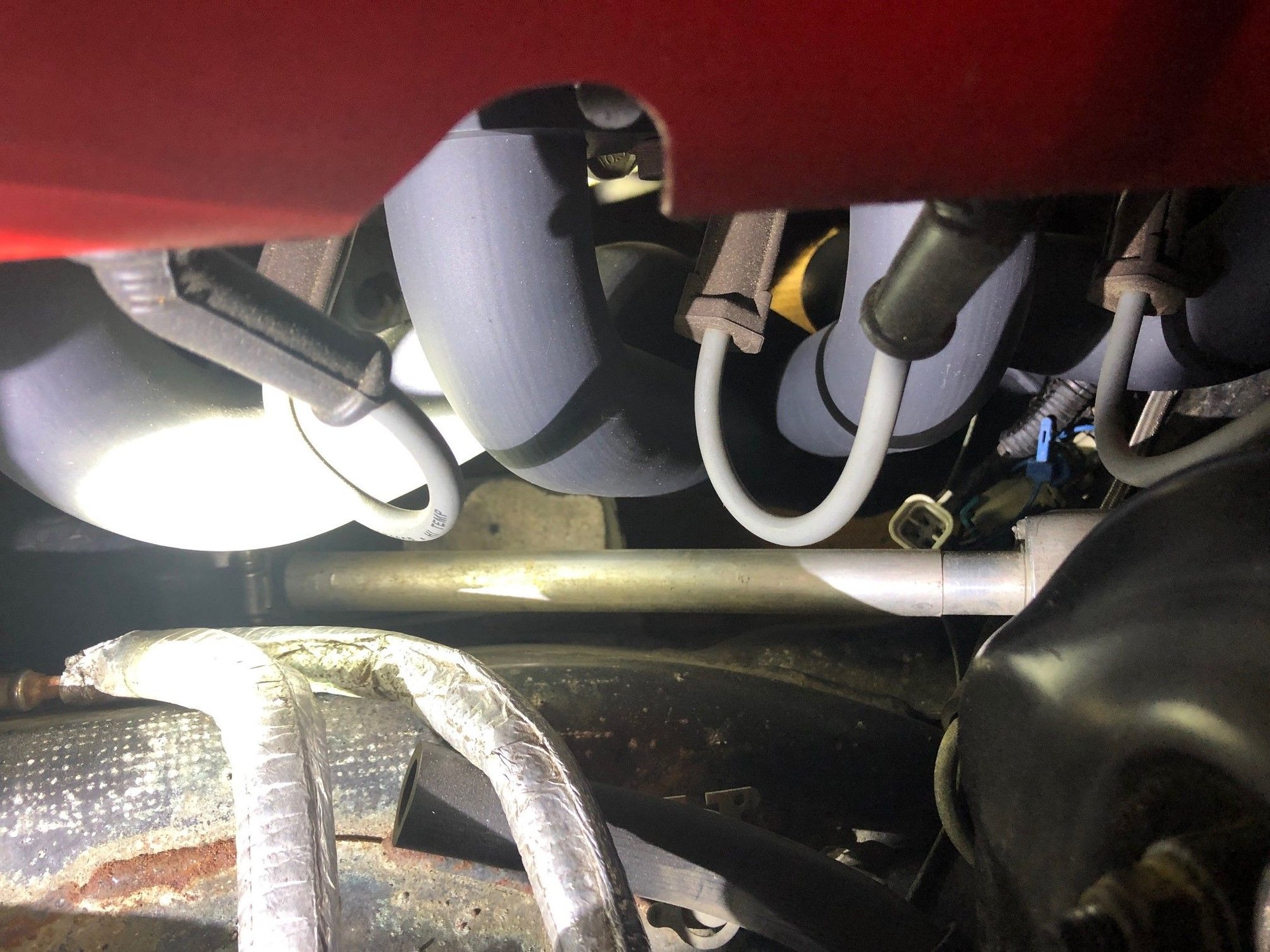

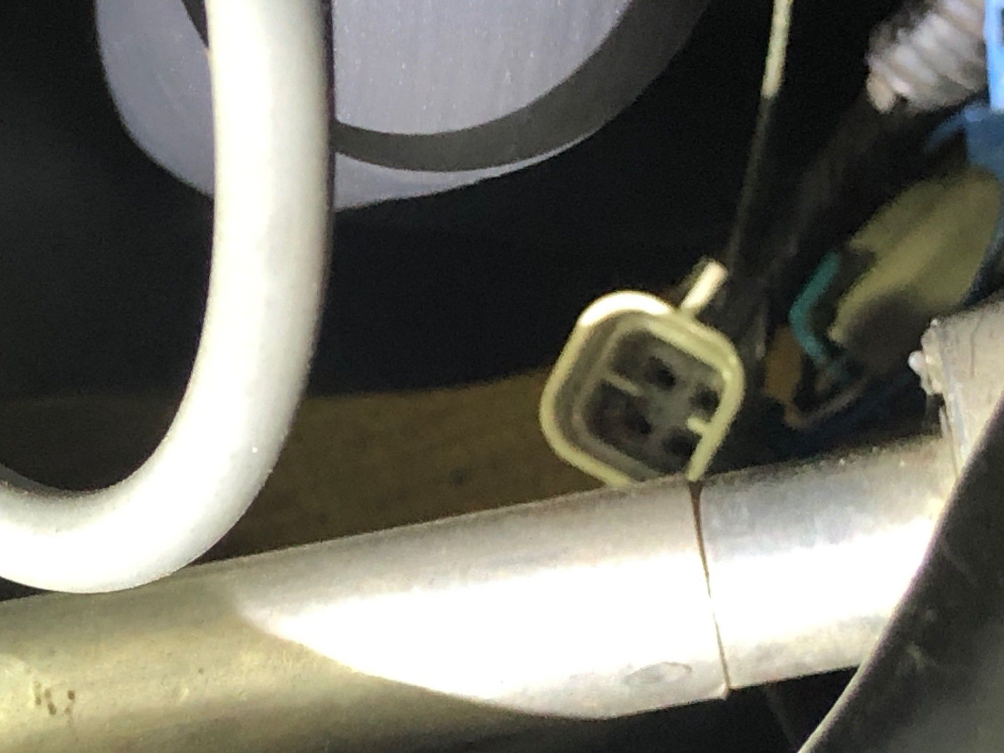

Here's another hopefully easy question I ran into while researching the O2 sensor issue. These pictures show an empty socket near the steering shaft right above the O2 sensor which can't be seen in the picture. Could this be related to the rear O2 sensor which was presumably removed when the long tube headers were put in?

The rear O2 sensor connector is square as in the picture...the front are an elliptical shape I guess you can say...the wire colors for the rear would be tan, purple, black and brown !!

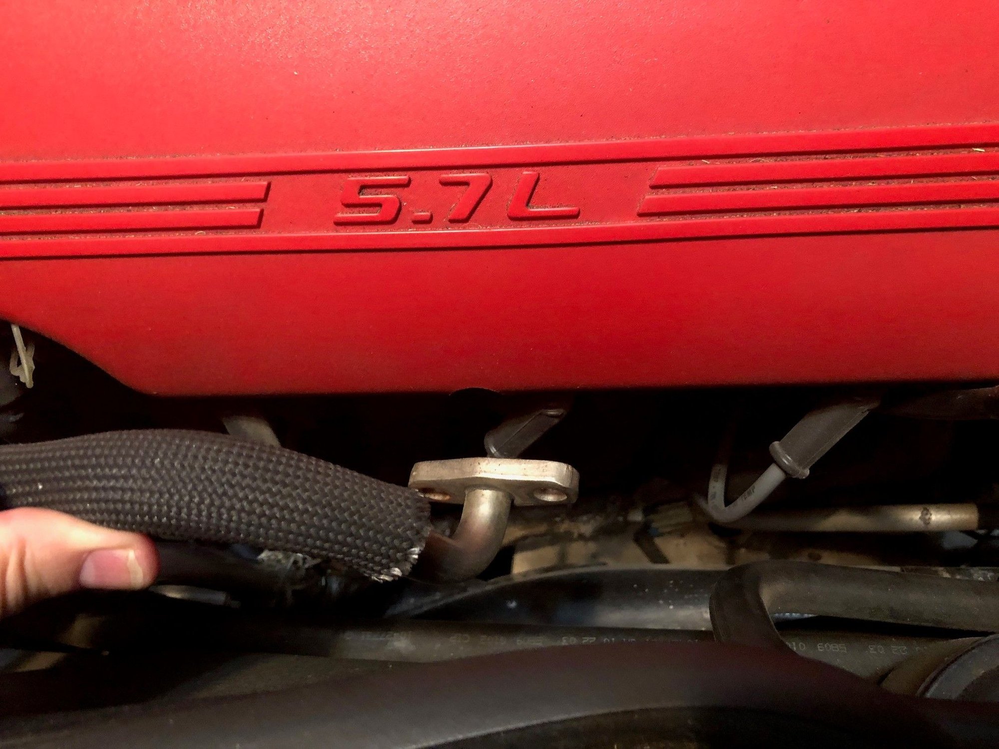

Amazing! How do you know all this stuff? You can probably tell me what this hose and bracket that aren't connected to anything on the passenger side of the engine are too:

That is your old AIR (Air Injection Reaction) tube that would have connected to your old exhaust manifold on the passenger side !!
