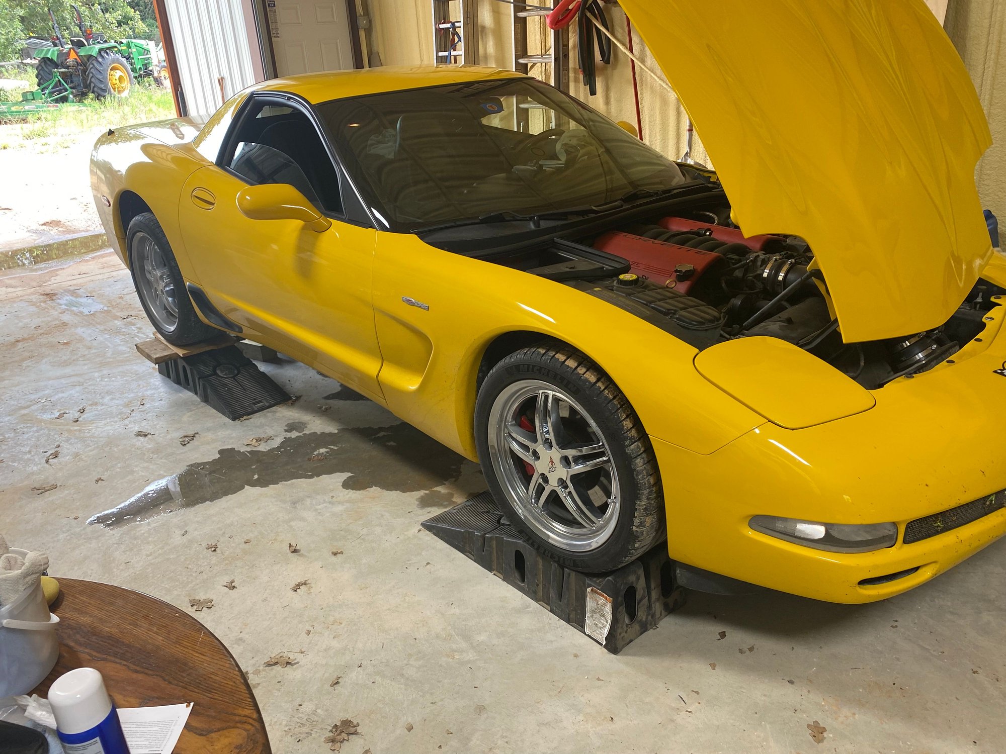

Just did my first oil change on Valerie.
2001 Z06

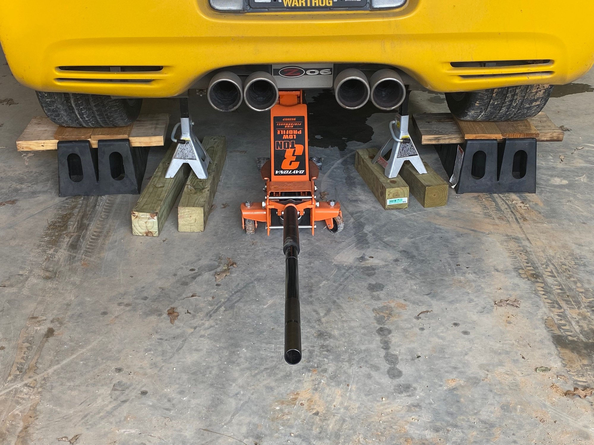

that oil filter is so little ... why even bother! I had to go get more tools! But I primed it anyway because that's what I do, unless (like the ford escort it's oriented sideways! smh)
so that remaning quart emptied. measured 1/2 quart on the next one. put that 1/2 in the trunk. then five more full quarts. ran for leak checking. it took me about 5 minutes to get the car off the ramps ... but ran it again. engine shutdown. sticked it. barely at the ADD mark. 4 times.
Oh ... and resetting the oil minder was easy. ignition switch on. pump throttle pedal 3 times to the floor. "ding"
So, I added the 1/2 quart from the trunk. That made 7. sticked it again. half way between add & full. twice.
So, I added .5 quarts from the 8th bottle and put the 1/2 qt in the trunk (again) ... now 7.5 quarts. right at the full mark.
So ... IDK. I had the nose down to completely drain the pan as you can see here with the 2x12s and fence slats stacked on the aft pair of ramps.
it was very humid today. lotta condensation from the A/C.
When I bought Valerie from @BLAQK , oil level was at the 'full' mark. Drove 2400 miles home to Texas. at about 4000 total, I had Corvette World of Dallas service incl oil change. Again the oil level at the "full" mark. Now over 10K miles I've put on her since the end of Feb. have added a quart/so in this last interval.
So ... I'm gonna go with it. 7.5 quarts total added.

Because of internal baffles, the most oil is drained from the batwing oil pan with the bottom of the pan level. Any other pan attitude traps oil when draining.
Old Jul 5, 2021 | 11:38 PM
shaark92's Avatar
shaark92
Joined: Aug 2018
Posts: 380
Likes: 170
From: Erath County Texas
wow ... well, slightly nose down resulted in 7.5 quarts to get to "full" on the dipstick when it was sitting on level ground.
Thanks.

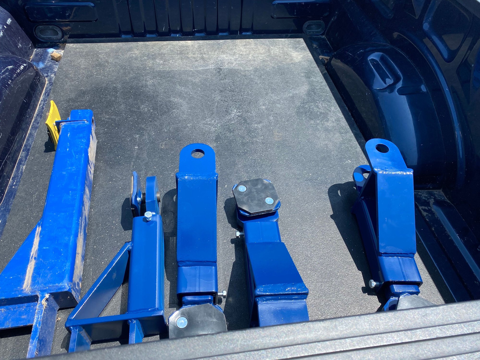

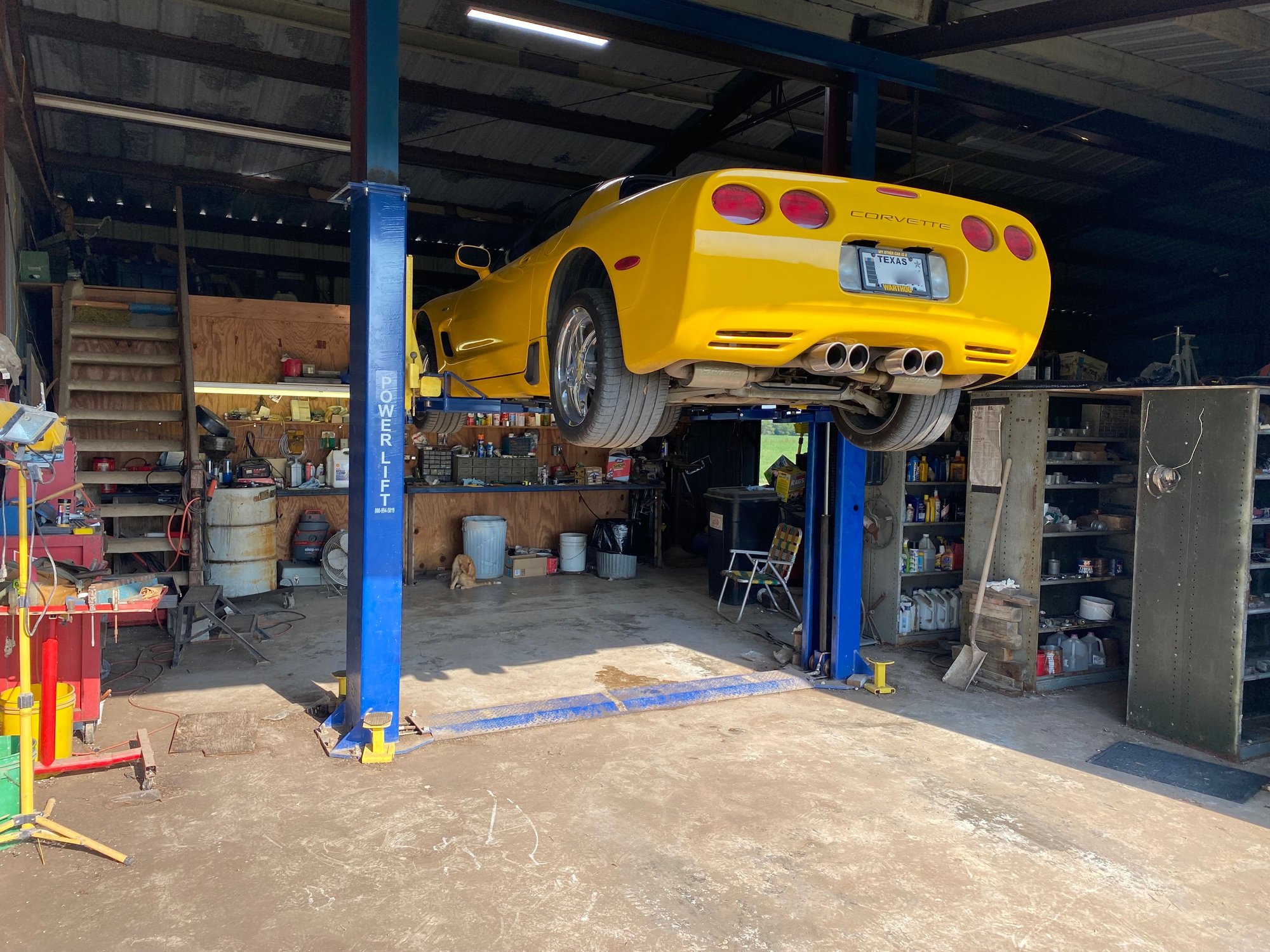

If your lift has removable lift pads, you might be able to remove them and lift the car on just the lift arms. That's how I do mine.

IDK why I didn't think of that! Will check to see if those pads will completely unscrew from the lift arms! THANK YOU!

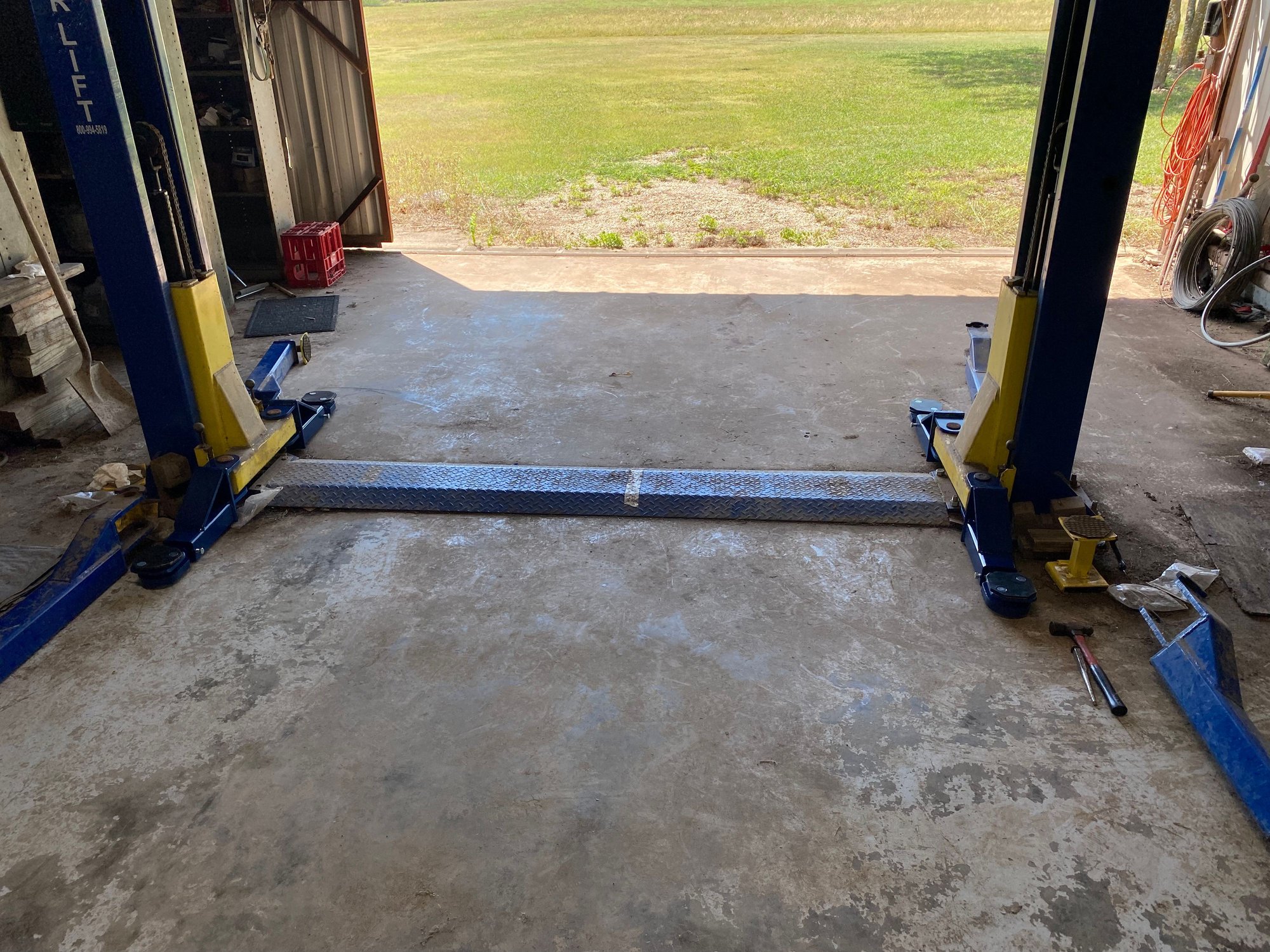

updating the lift arm reference in my previous. Just wish I had this building at my casa. Oh well, provides for a little leg stretching to get there and back.
Custom lift arms ... need shorties for the wide body C5
two post lift with the custom built lift arms
pushing the ground away from Valerie with the new lift arms on our two post lift.
