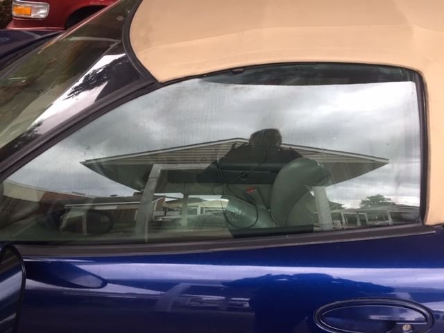

Be patient. Your windows can be adjusted where they don't hit the top and don't leak in the rain.
I assume you have found the adjustments at the front and back bottom of doors.
You can also loosen the two bolts that clamp the window to the regulator then you can slide the window forward or backward.
There are fine adjustment screws under the clamps that allow you to adjust the angle of window front to back.
Back edge of glass will just barely miss touching the top when closing the door.
Tip will nicely tuck under the top when fully closed. Good luck. Don't give up.
Here's a pic of how it should look....
To 2000 Windows
