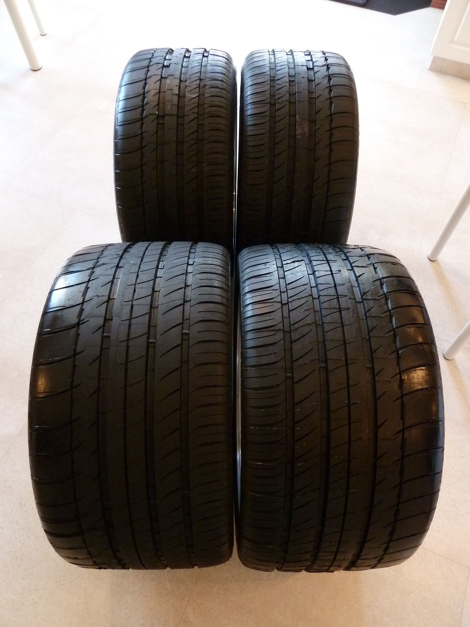

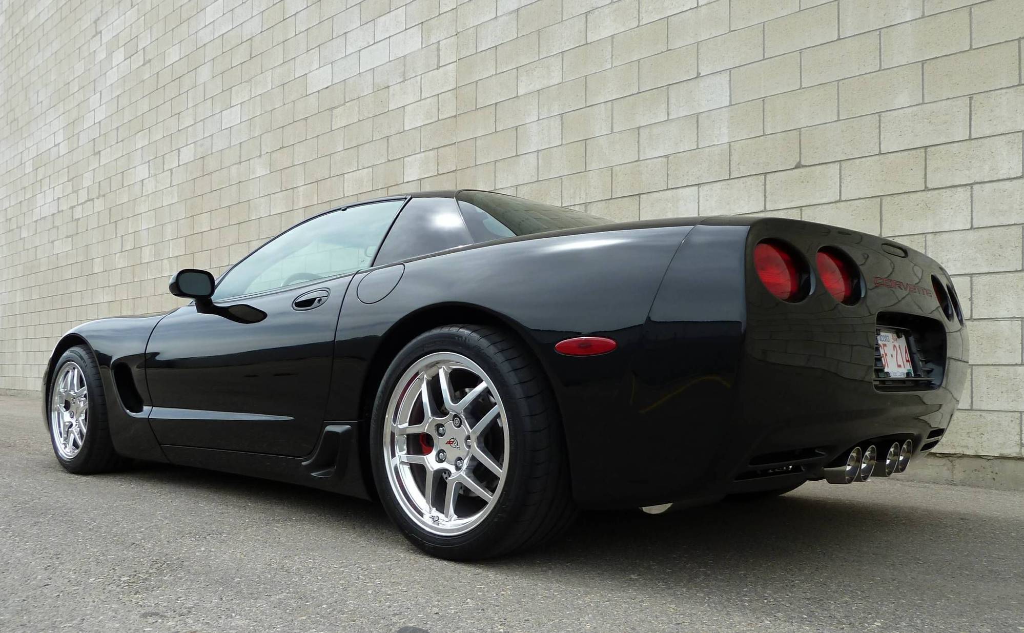

I am running a set of Michelin PS2's - Fronts - 265/40/17 & Rears - 315/30/18
