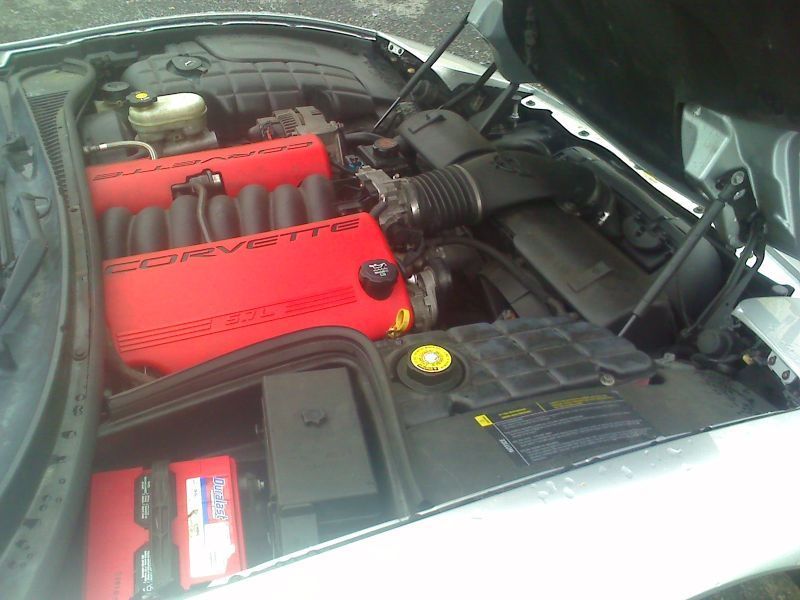

My Stock 03Z with modified airbox, K&N Filter, worked well enough because no budget
And this was the GTO with a poor (relatively speaking) Lingenfelter CAI Kit. I did drill some metal to some aid in Cold Air scavenging (but these cars need OTR (Over the Radiator) Induction for CAI)

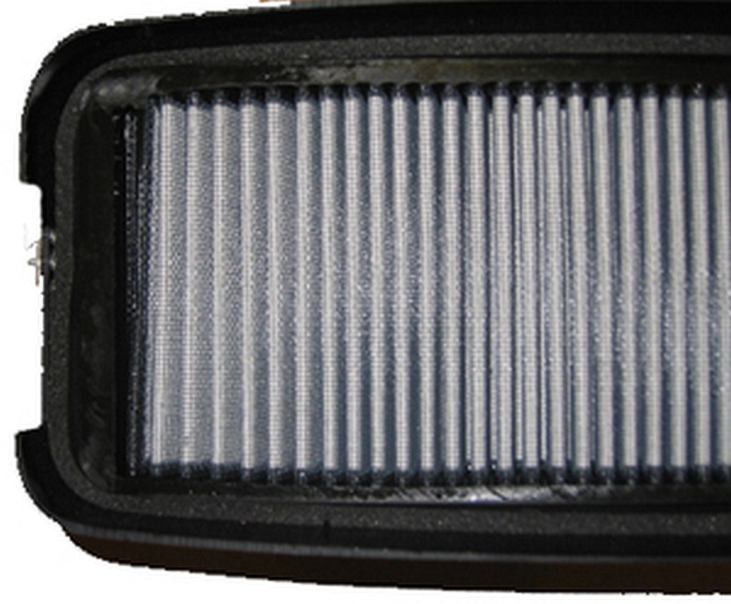

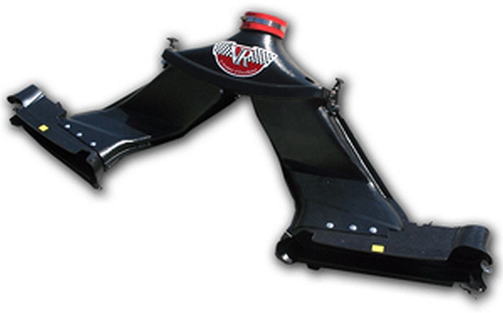

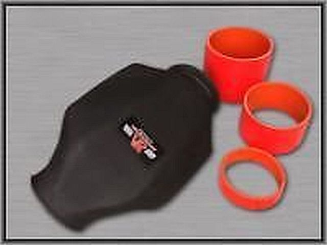

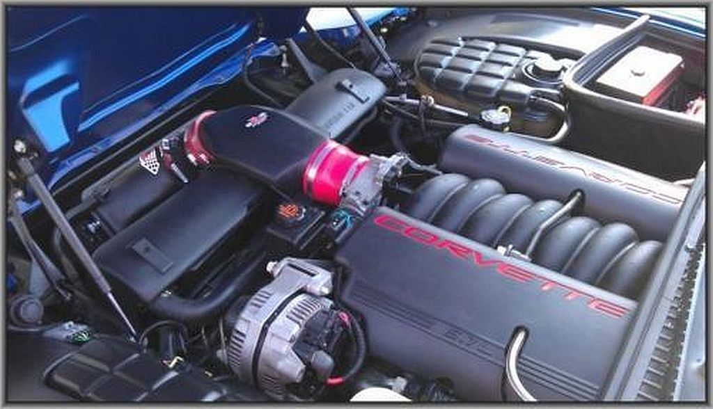

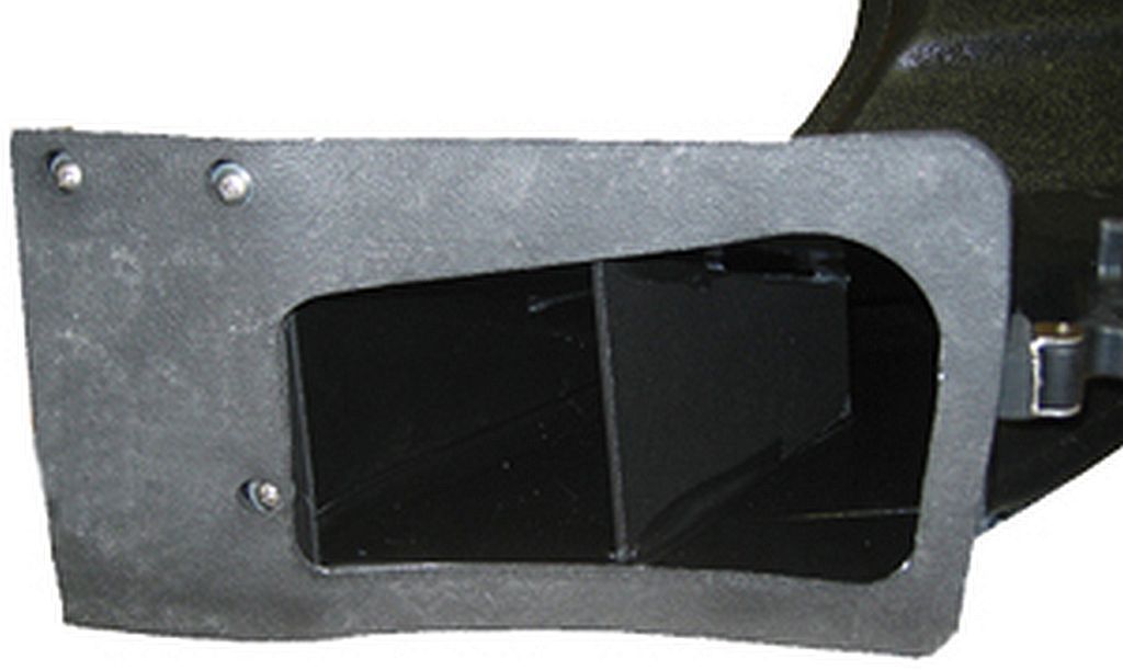

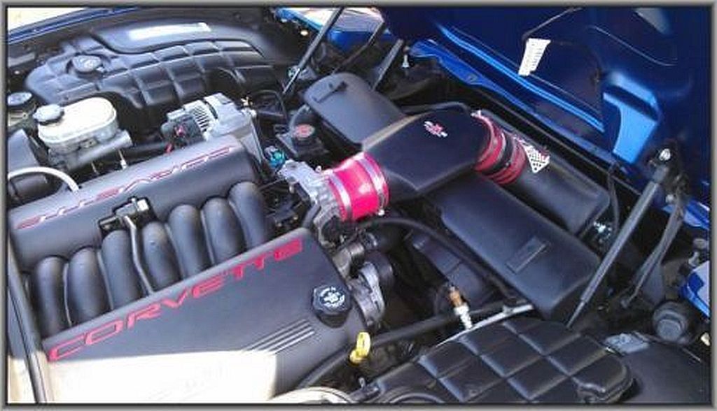

Here's what I have on the VR --->
Clean
Components
R&D
Upper
Shape
Shape
Clean
Front
Lower
Lower
Middle
Filter
Lower
