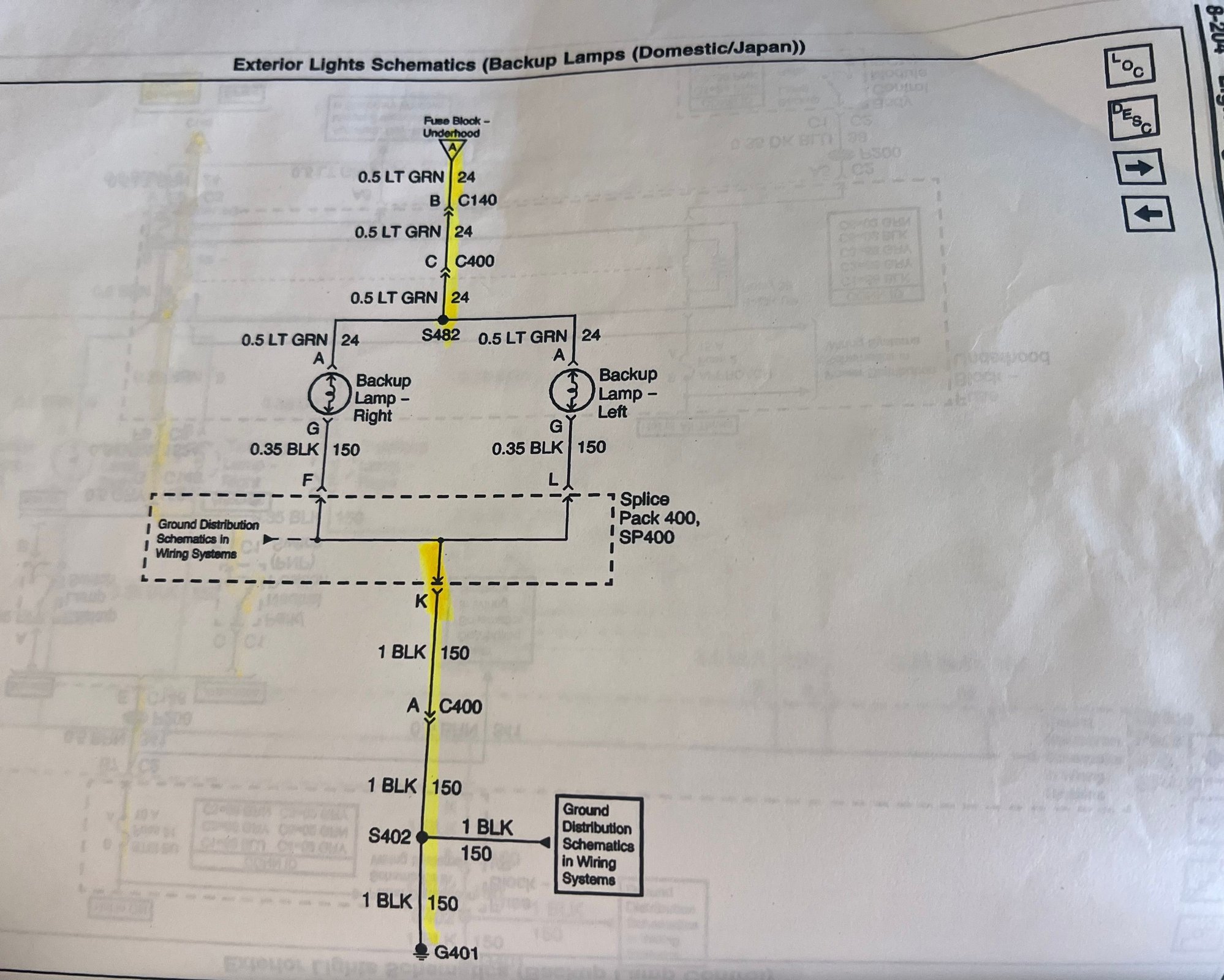

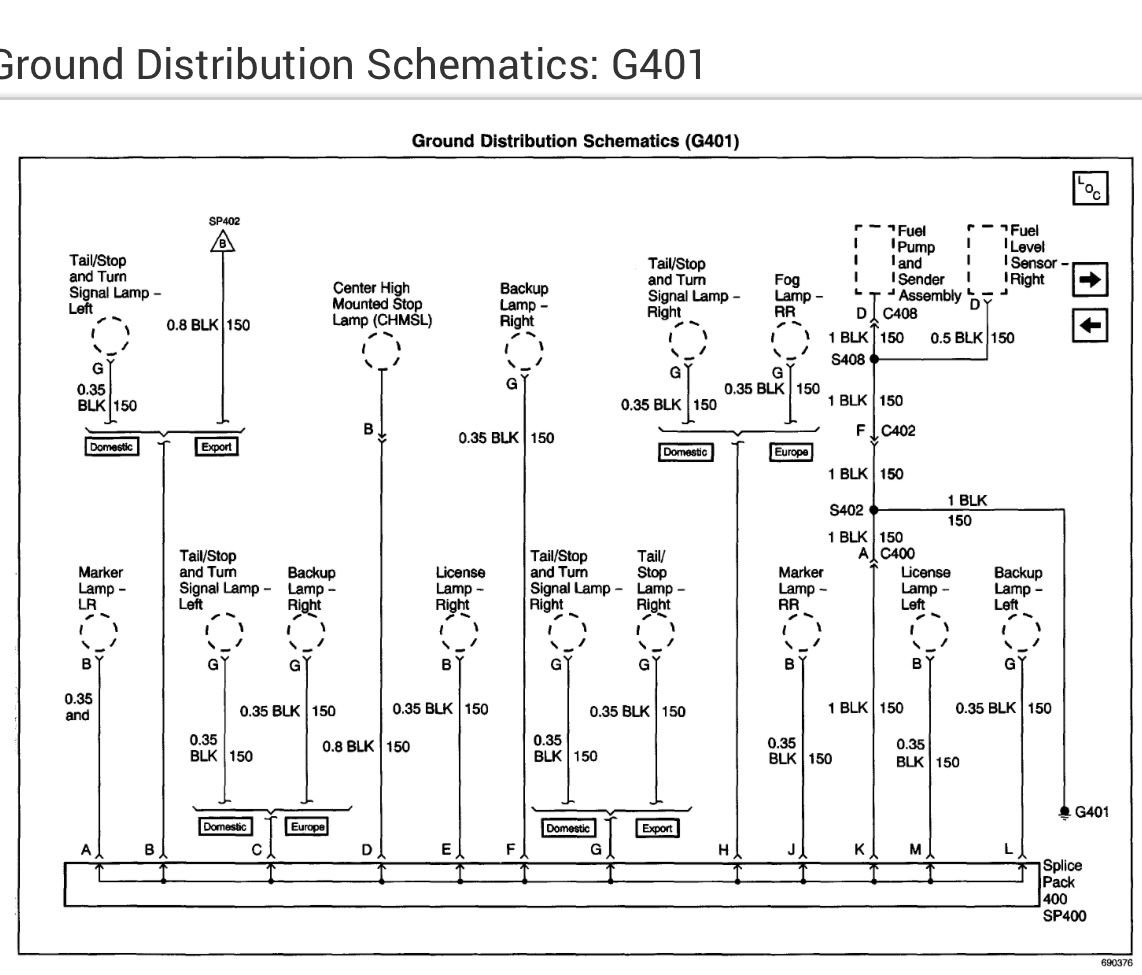

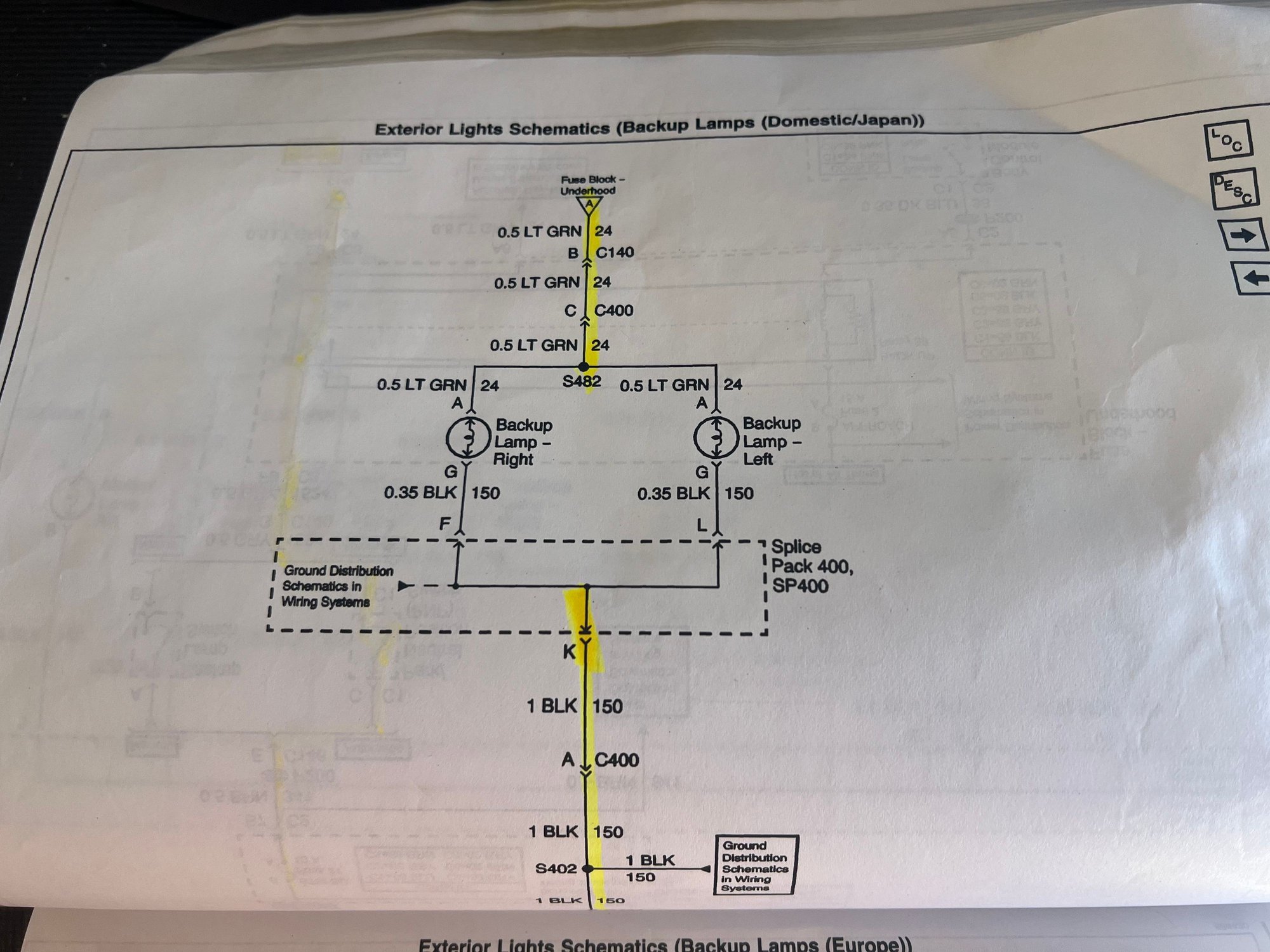

With lights dimming a bad ground is usually the culprit and in your case G401 which is the ground on the left rear frame rail inboard of the tire…to check remove relay 38…one of the 4 terminals is “hot at all times” and is the control side feed of the relay…the control side ground is the BCM so it’s not that one which would be caddy corner from the feed terminal…the load side feed is terminal 30 and 87 is the ground which goes to G401…take a 12 volt incandescent test light connected to battery POSITIVE…when checking those 4 terminals one should light and that is the ground for G401…if test light dim you have bad ground or splice pack 400 needs some cleaning up…you can see G401…you can see ALL the circuits that use 401…see if any of these are applicable to what you’re seeing.

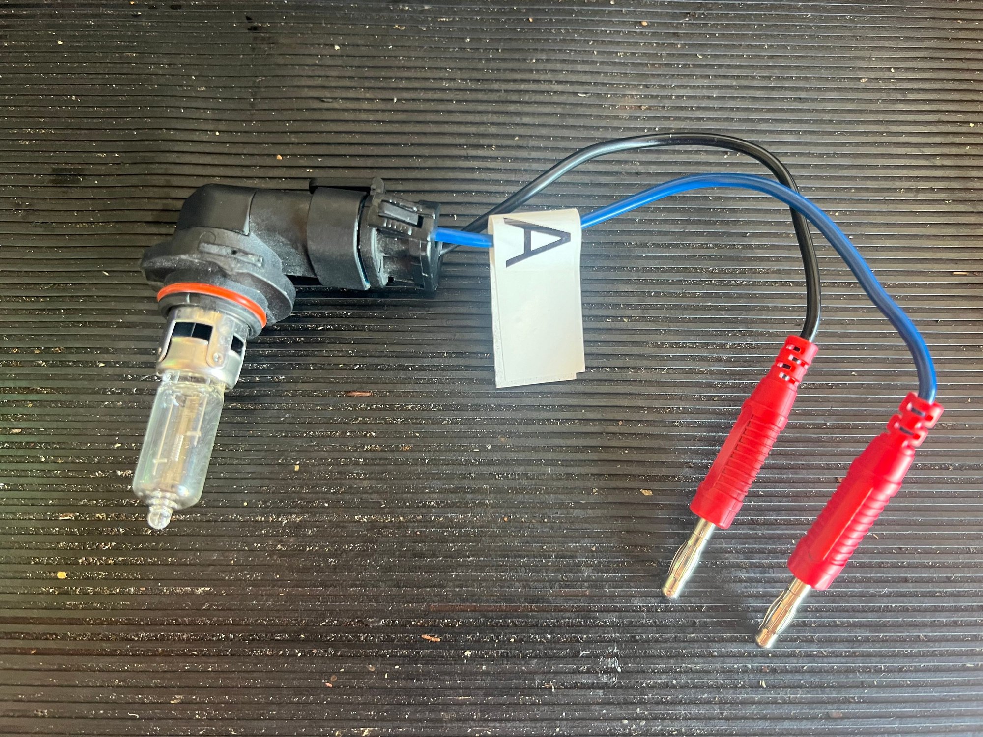

BTW, better to use an old headlight bulb to test the grounds…incandescent test lights only draw about 300 milliamps or so…this bulbs draws about 5 amps but one than draws 2 amps would work just as well…you determine the bulb to use by how much current that circuit draws.
