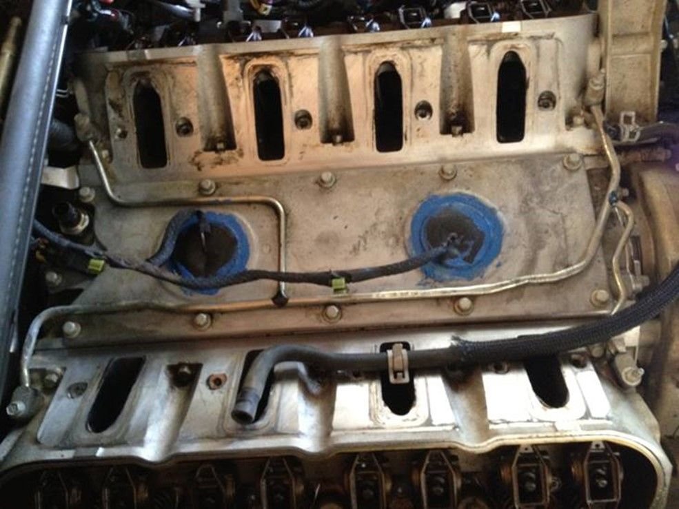

I don't know if it's related to the above, but I have the doubt if my engine looks or like the pictures published in the note or like the one attached at the end of the thread, and if so, should I do some extra step?

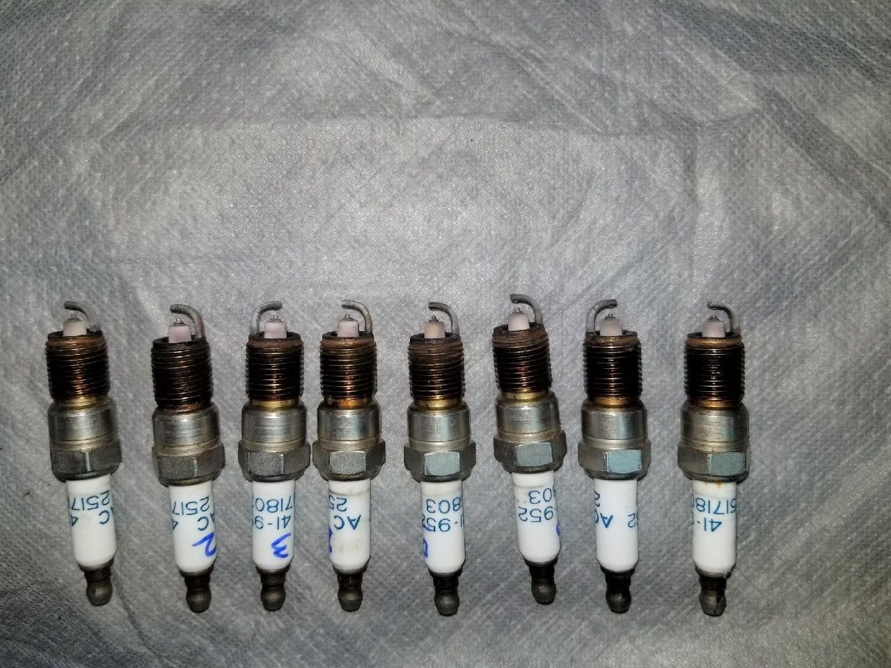

On the other hand, I am pretty sure that I have no piston rings problems. No smoke from the exhaust and original spark plugs look really good for the miles (picture attached also). No leaks either.

In fact, my biggest question is whether when I disassemble, I find myself with something different from what the pictures indicate in the link. The one I attached looks different, there are some small pipes that I suppose are from coolant and I and I don't know if these are easy to disassemble and put back or if I need new ones.

Here is a better visual of how it looks below the cover and what you need to modify.
There are other videos in better detail on the plumbing of the hoses and what you need to block off on youtube. Anything I find I'll share.

After searching and reading several threads, I will rephrase my question.
If I install a LS6 valey cover keeping the original intake on my 99, can I also keep the old style coolant crossover or should I update this to the LS6 style too?

You should be able to keep your 4 way coolant crossover that way. The reason the LS6 and later LS1s went to the new style coolant crossover was the flat bottom of the LS6 intake doesn't allow the 4-way crossover to fit.
the 4 corner crossover will not fit in it's original form, one of the tubes will make contact with the fitting on the ls6 valley cover... you can gently bend it and form it to clear that fitting but it is a pain in the @ss to do and get the coolant fittings to line up properly without being in a bind
Possibly I wil take the risk and bend the crossover so I can use the ls6 valley cover because I don't know how and what part I should buy to change the original lines.
