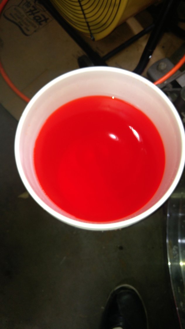

Tonights mix of 2 gallons concentrate and 2 gallons distilled Didnt expect the concentrate to be thick and maybe i should of poured the water first lol
Color looks good
