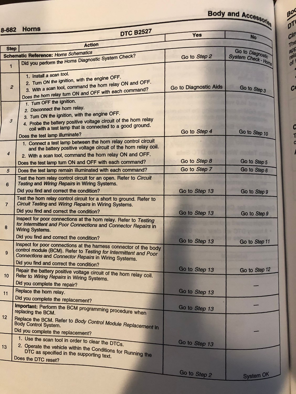

I checked my codes. My code I got for the horn is
B2527. Where are the areas to check for the grounds? My relay and fuse are good.

The B2527 condition for setting this DTC is the BCM detects a short to ground or open in the horn relay control circuit for approx. 2 seconds !!...below is troubleshooting tree for this DTC !!
so do you think I have a bad ground somewhere?

Troubleshooting tree enclosed in my edited post !!!...problems with this car are NOT always bad grounds !!...you must diagnose the circuit !!
