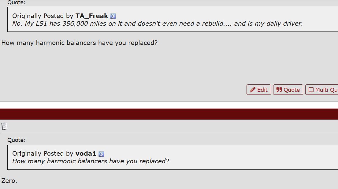

Vhttps://ls1tech.com/forums/generation-iii-internal-engine/1928420-swapping-110k-mile-ls1-rebuild-no.html
see post #3, 4, 5

exactly. Sometimes forums create the “oh **** I have to fix this” mentality. I saw a thread a while back where there was only one reported balancer failure that caused major damage and the car was heavily modified and supercharged. But hey, where is the mess hall? I’ll follow. Lol.
