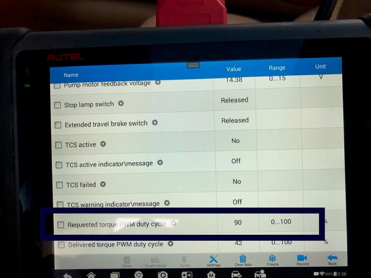

Did you do all these swap out of parts at the same time and did you start having your driveability issues then ??...as far as the 0327 knock sensor DTC did you change the knock sensors ??..if not I would check the wiring and do the easy stuff first...if the knock sensors were changed torqueing them correctly is imperitive. Now as far as the 1571 (TC Torque Request Circuit) do you have a decent scan tool where you can see if you can communicate with the EBCM and check your requested torque PWM duty cycle...should be 90% at idle as in the data PID on my '01...by the way what year is your car ??...ALWAYS helps to put all that info and mods in your user profile...Now the PCM reduces spark timing AND it starts turning off fuel injectors if it's sees an incorrect torque signal...with a scan tool you can also see your spark timing data PID and check it during the loss of power...
that's maybe why the car is dying on you...I don't know if you are any good with electrical but you can see if you have 5 volts at pin 12 of the EBCM (orange/black wire). I would disconnect the EBCM connector and see if you have the 5 volts with the key on...not sure if you will only see 5 volts with key on or with the engine running but you can check that...hope this may help !!
