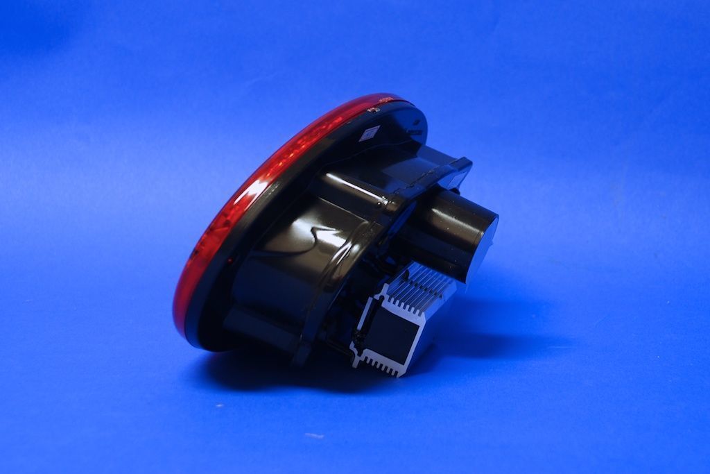

In your case, 2 possible explanations could be that your LED bulbs are drawing just enough current to be above the threshold for hyperflashing when you engage the hazards, or perhaps they have built-in shunt resistors like the Halo tail lights (the aluminum block on their back cover):
I have also seen people installing shunt resistors and later on adding a hyperflash harness without removing the resistors. That would also explain it.

Yes, my tail lights have resistors like the ones in the picture. I installed them first. The turn signals would sometimes hyperflash, but not the hazards. It seemed to happen when the system voltage fell below 14. When I installed new front corner housings and LEDs, the hyperflashing was terrible. The fronts have no load resistors. After I installed the hyperflash harness, the turn signals and hazards work perfectly.

So that explains it! The shunt resistors in your tail lights draw just enough current to be above the threshold for hyperflashing when you engage the hazards
