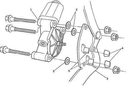

Get a kit like this one (pay attention because there are 2 different kits: one for "97 to early 2000" and another for "late 2000 to 2004") and follow these step-by-step directions. You'll save money and they will last forever.
It would be wise to replace as well the rubber bump stops in both sides (#4 in diagram below). You can get them here.
There is a TSB, that calls for shimming the driver's side motor. The parts needed for this are included in the above mentioned kit (#2 in diagram below).

The bump stops are the only thing mechanically that stop the head light motors; there isn't an internal mechanism that denotes either the full open or full close point. The headlights have four bump stops each, two on the back side of the headlight door to prevent jostling and two on the pivot arm that actually notes the full open and full close point. If the bump stop on the closed side of the pivot is worn or damaged the pivot arm can be moving further that it's supposed to, causing the gear to spin.
If the gear is damaged, the *tat tat tat* sound, then teeth are likely missing. The loose pieces contact the insides of the gear as, again, it's a set amount of power that gets applied to the worm drive not something inside that controls the open and closed points.
Regardless it's pretty easy to service the gears and the bump stops. The only thing you're going to run into is that mid-2000 the headlight motors were changed. You'll need to determine if you have the earlier bolted housing style or the later sealed housing style, with each requiring slightly different steps to service.
