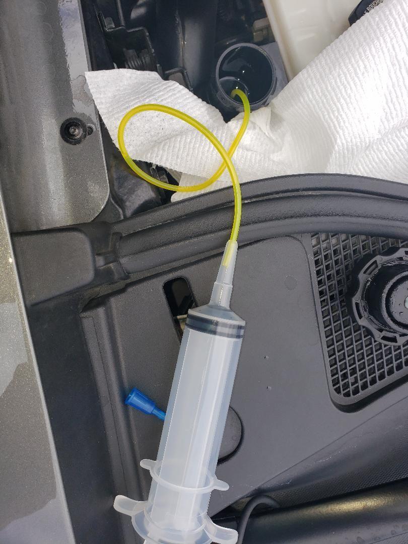

I ordered the MedLine #DYND20325 on eBay and found the 1/8" OD nylon tubing at O'Reilly's, however, the 1/8" OD nylon tubing does not fit in the hole at the bottom of my reservoir, so I found a .080" diameter at Autozone ($4) that does. Only problem is that it is a very flexible fuel line (not very stiff) that is a little bit of a challenge to snake down into the bottom. Moreover, once I start to push fluid down through it, the fuel line wants to squirt back out of the reservoir. However, I was able to hold it down with one hand while plunging with the other. I was able to inject about 120mL of fresh clutch fluid into the reservoir but the old fluid that rose to the top was barely dirty at all. I have been using the Ranger method to clean my fluid a few times per year so either that kept the fluid clean or I did something wrong with Natie's method. Or, maybe I just don't crank very hard on the tranny.
Anyway, I'm going to try to search for a stiffer .080" diameter line and then try again to see if that makes any difference. Images below.
Medline syringe with 0.080" diameter fuel line
.080" fuel line (empty package) from Autozone

At best this is getting fluid from out of the MC and up to the reservoir. This would work quicker than the Ranger method since that only takes fluid out of reservoir each time.
You still have dirty fluid from the MC down to the slave.
If you keep your car for a long time it's worth the money to have a remote bleeder installed to get ALL the fluid out each time.
End all be all will be a remote bleeder and using a Power Bleeder hooked up to OEM reservoir cap.

and how do you get all the crap out of the slave?... it looks like it will do a better job than just cleaning the reservoir but still can't accomplish what a remote bleeder can
You don't. That's why a proper remote bleeder is the ONLY option at properly flushing the system.

This just changes fluid between the reservoir and the master cylinder. It doesn't go into the line past the master, not even one little bit.
Posting about something like this again lets new owners see it, but it's nothing newr. I first read about doing that many years ago.
