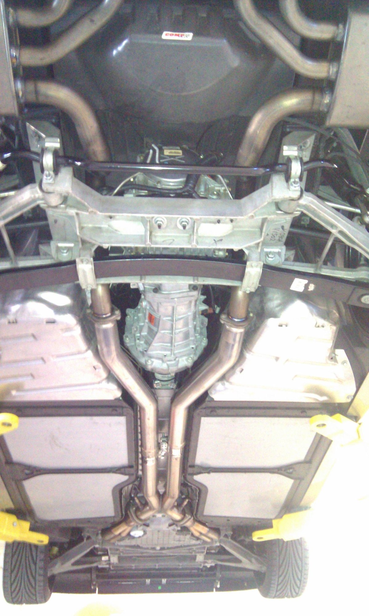

Has anyone put a mid muffler (dual in dual out) just after the H pipe or X pipe?
I had an 05 GTO years ago and by placing a muffler under the car instead of at the rear, it changed the sound a lot.

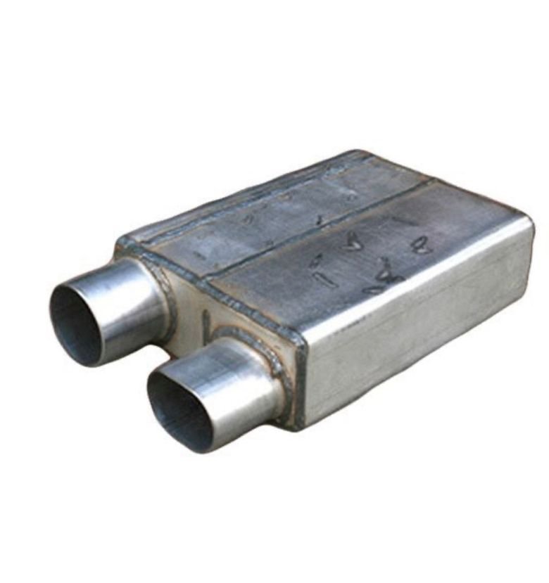

Ive always had to be different when it comes to exhaust and don’t want to buy a typical axle back. I’m currently running Long tubes, x pipe and Z06 axle back. Was thinking of going with spintech for a unique sound like the second muffler below and if it won’t fit, they do make one with inlet and outlet on the same side to put in the stock location.

Could swear I saw a post/pic come up on a search of someone who had a muffler In place or near where the cats were but I can’t find it.

I dont think you have room to put a muffler in the middle of a C5 exhaust system.
