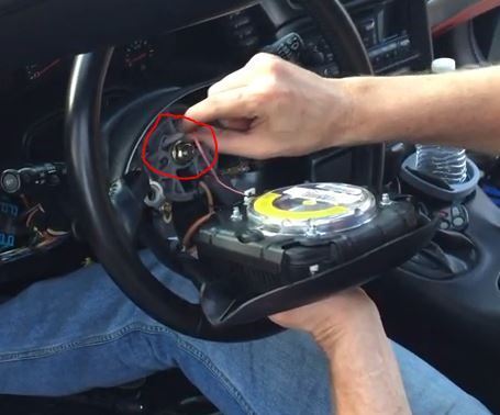

I was wrong. Horn saga continues. Yes I solved the issue of the stuck horn with the new membrane, but as I reinstalled the wheel back I did notice that the positive lead of the horn (the one that is spring loaded) just wouldn't stay fully engaged on the female socket. It's supposed to go into the female socket in the clockspring, rotate clockwise and stay in place retained by a little plastic peg on the plastic sleeve of the positive lead, and it sits and retains itself in a cammed groove inside the wheel slip ring/clockspring. Looks like the cammed grove on my clockspring was slightly worn or broken.
I put the wheel back together and horn works, but obviously and unsurprisingly it's inconsistent, meaning sometimes I press on the horn and nothing happens. Can this stupid little cammed female receiver socket be replaced?? Or do I need to get another clockspring?
Horn lead that won't lock in place
