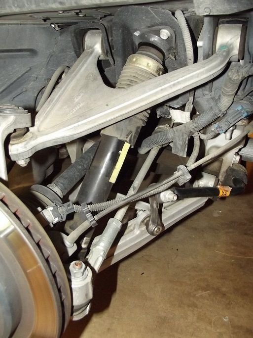

Kurt, since you have the Magnetic Selective Ride Control (F55) option and you say "...My magnetic ride sucks, bumpy no control on the valving." Is it possible you still have the plastic shock stuffers in your shocks?
With that option, the cars were delivered to the dealer with bumps stops - 'plastic stuffers' in the shocks. It wasn't at all uncommon for a dealer to forget (?) to remove them before delivery when new. Soon the customer would complain and someone would remember to check for the telltale flag hanging out of the shock and problem solved. And yes it did happened - more than you might think.
Just asking...
Good luck...GUSTO
