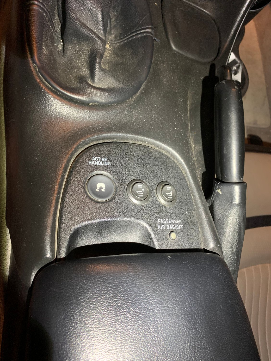

I hard wired mine to the ash tray lighter and installed my switches in the ‘control panel’ right in front of the arm rest.

Originally Posted by 636jesse
I’m thinking about putting them with the active handling button. Road Runner will you post a pic if yours. I don’t want to put then with the ashtray since I did the double din the space is filled.
In this location the switches can easily be accessed by both the driver or the passenger
