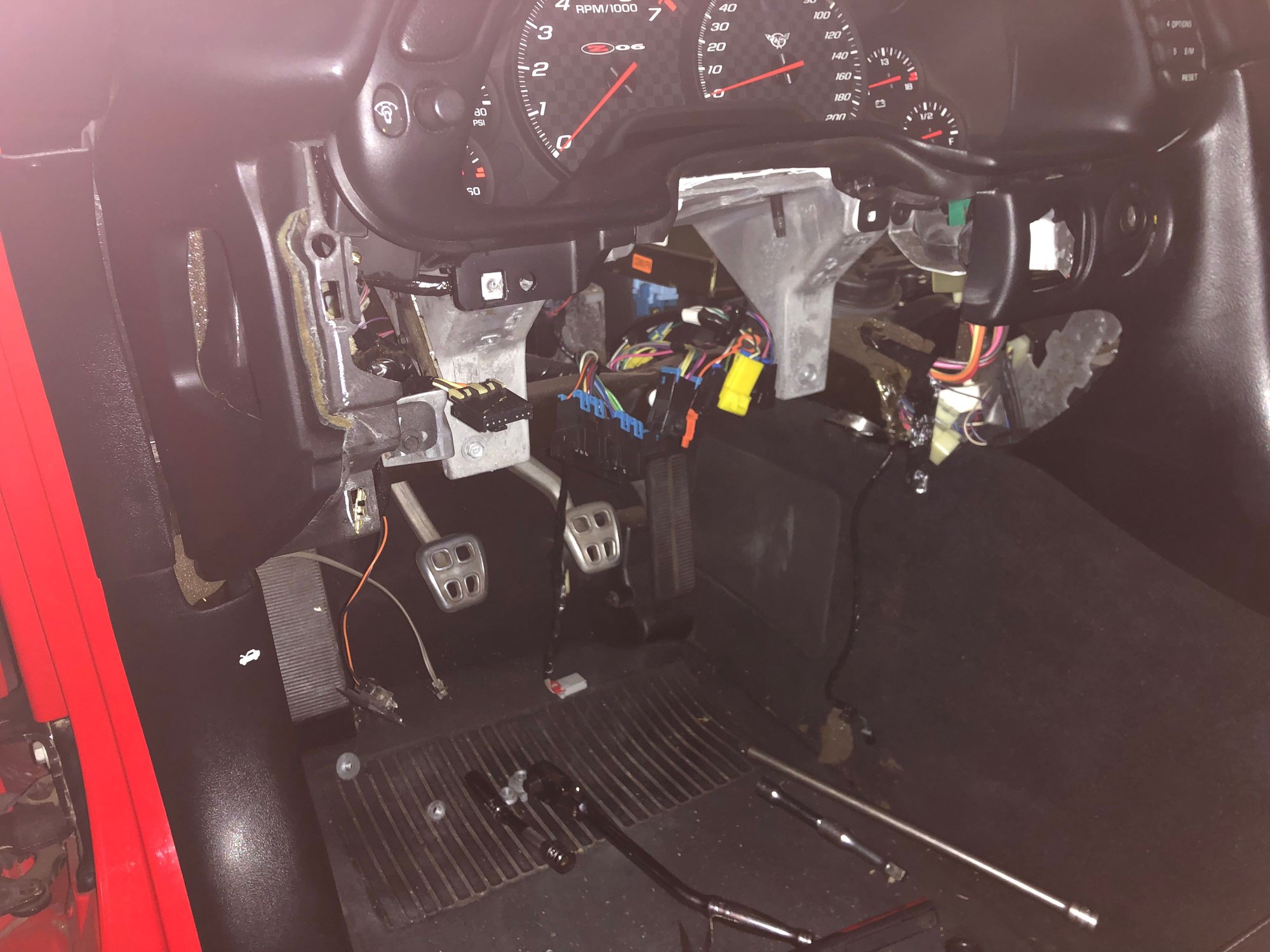

I had the same steering codes. Changed my steering position sensor. Mine is an ‘01 so the sensors are readily available. Being yours is ‘00 it’s only available used and kinda expensive. $425 range.
You have to pull the steering column to change it.

Yes, the steering sensor and EBCM are both pricey for my year. I recall you did your steering sensor. Starting looking for one as I concurrently eliminate other possibilities such as the off-center steering wheel. I found a used sensor for the '99-'000 for $475. Ouch. May also get a new battery if volts stay low and make sure grounds are cleaned up.

Also when changing the sensor, take some sanding paper to the mating surface on the steering column. Where the sensors terminals touch. There were slight burn spots I’m glad I made clean with paper.

Impressive, looks like surgery. I recall you had a major issue with your steering sensor? Did you change it after codes and / or after eliminating other causes? I’m looking for the steering sensor now online.

1287 will click on most likely and you’ll need to change the steering sensor. This is a common problem with these cars. Don’t over complicate it. ~~~josh obviously replaced his himself and he’s showing how complicated it is. Had mine done at the dealer. Cost $650
