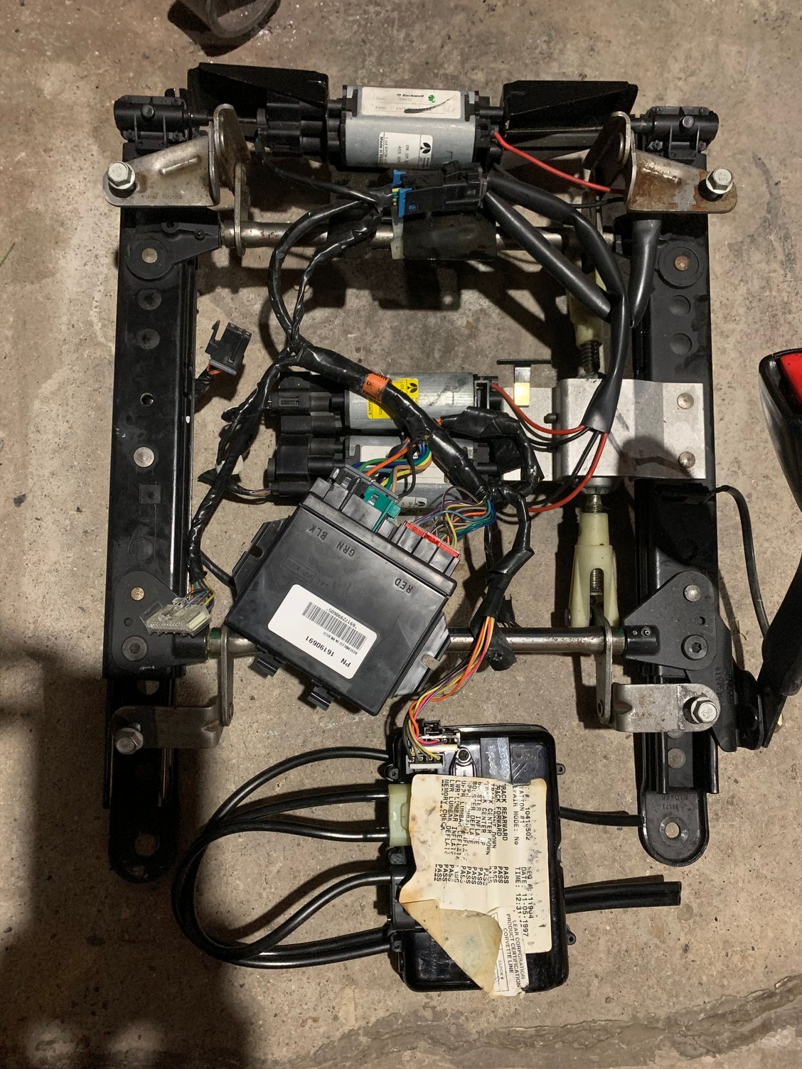

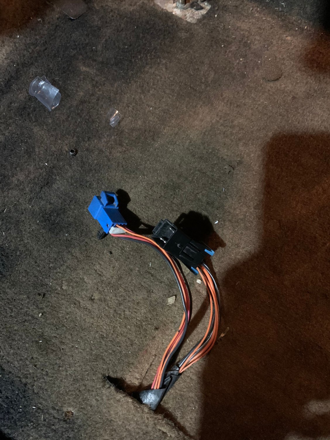

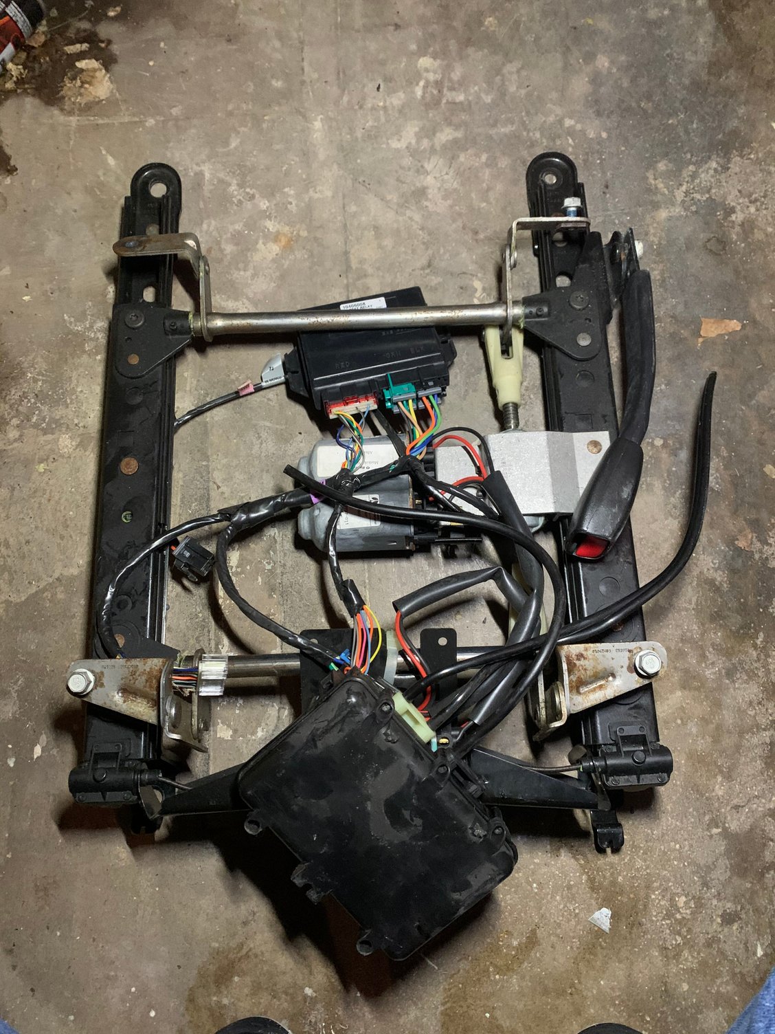

I have a 2000 vert I’m trying to install sport seats in the car came
with cheap crappy aftermarket seats I have since bought two seats they didn’t have any tracks with them. I got the tracks and they came with all the power and modules in the picture what has me stumped is how the electrical connections are made and also where the black hoses hook up. These are the connections I have protruding out of my floor. I know I am missing the seat controls yet the seats didn’t have those either. Any and all help would be greatly appreciated. Thank you.

Hoses are for the air pump for the bladders. Can’t really tell what else is going on.

Cars thart do not have the telescope and memory have a control module that is different than a car with memory.
It looks like the seat frame in the second pic came from a car with memory. the harness with two pigtails came from a car with memory

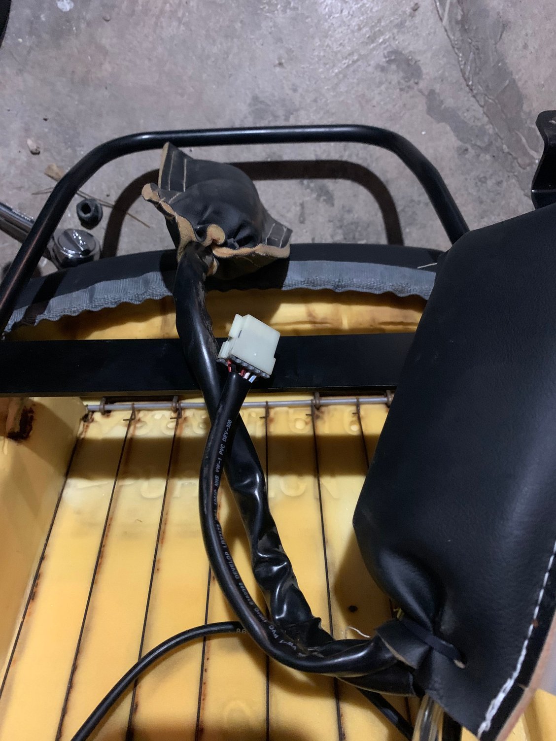

there is a harness that has a white plug on it that plugs into the seat module and goes to the switch assembly the lumbar also will plug into that harness
it should also have a blue connector and a black that plugs into the floor

So I need the controls for the seat and lumbar and it will connect the two together.

Yes you need the trim piece and the switch. The switch has 1 6 way switch for the seat and 3 for the lumbar all in 1 piece
look up vett nuts on this site. he will probably have what you need

If the seats you bought has lumbar in it you should have hoses coming out of the back. the lumbar bag is mounted in the back of the seat
the seat module is held in place by the wires on the seat bottom

From what I seen in your pictures, the drivers seat track is from a 97 that did not have the telescopic column. It will work but the column wont move in/out.
It does have an older style lumbar/bladder pump assembly. The picture of the seat bottom you posted has a lumbar/bladder pump and valves. The assembly on the seat track has different connectors than the seat you have.
I do have sport seat switches available they are $90 each plus shipping. Same one is used for the driver and passenger seats. I currently do not have the correct wiring harness for the configuration in your car.

So the hoses coming off the black box run up thru seat to. The bladder so I need to take the seats apart and attach the hoses to the bladder both seats have the pumps.
