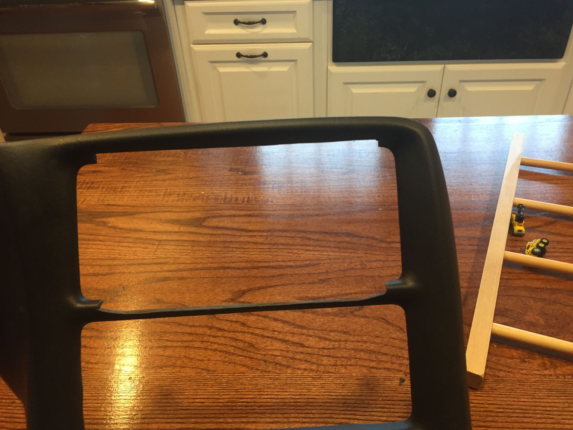

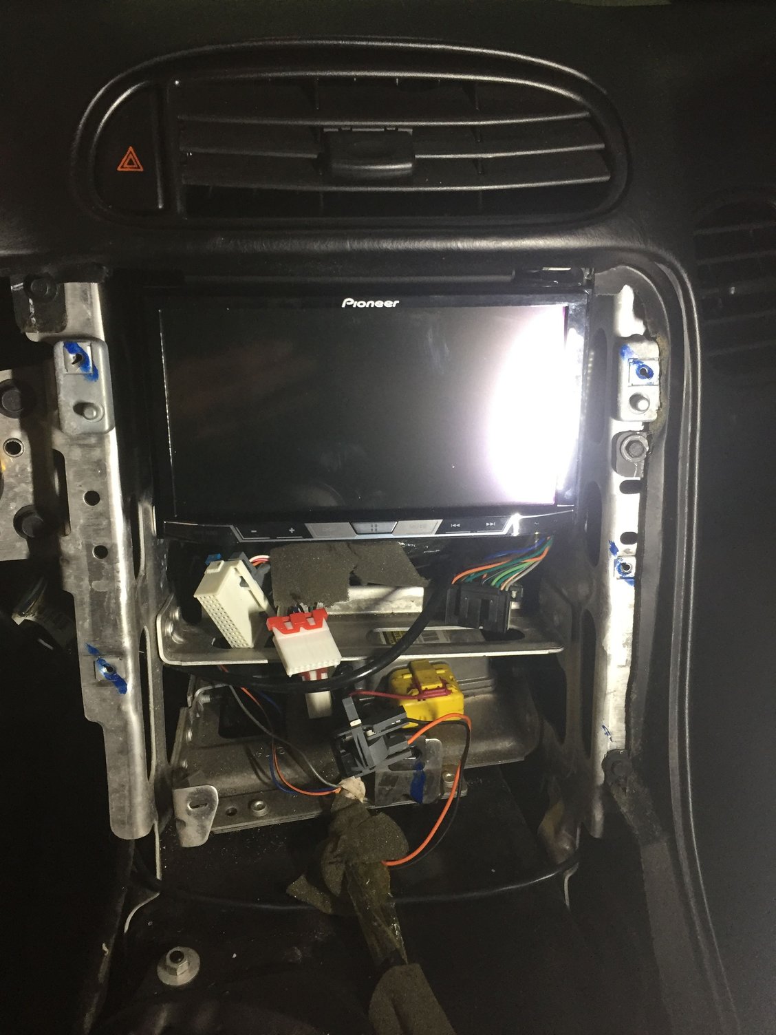

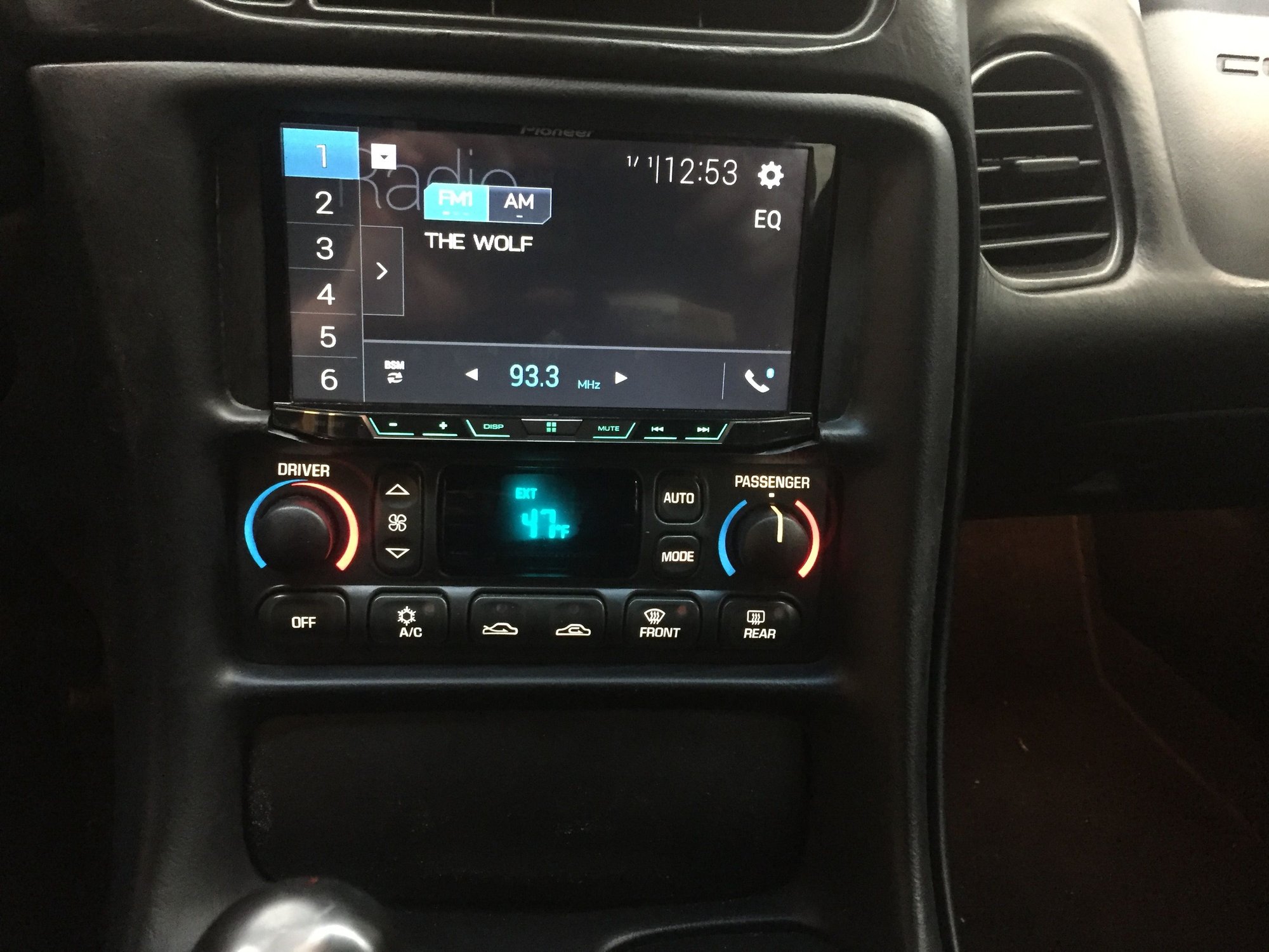

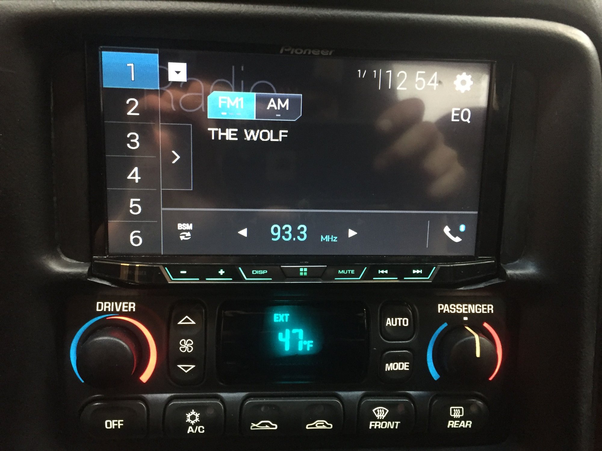

I just wanted to pass along some pics of my double din install that I utilized my OEM bezel for. I purchased a Pioneer MVH3000. I removed the OEM bezel. First I checked for fitment of the radio into the oem aluminum brackets with the oem radio out. The radio fits into the brackets snug until it hits two tabs that protrude down into the opening. I easily

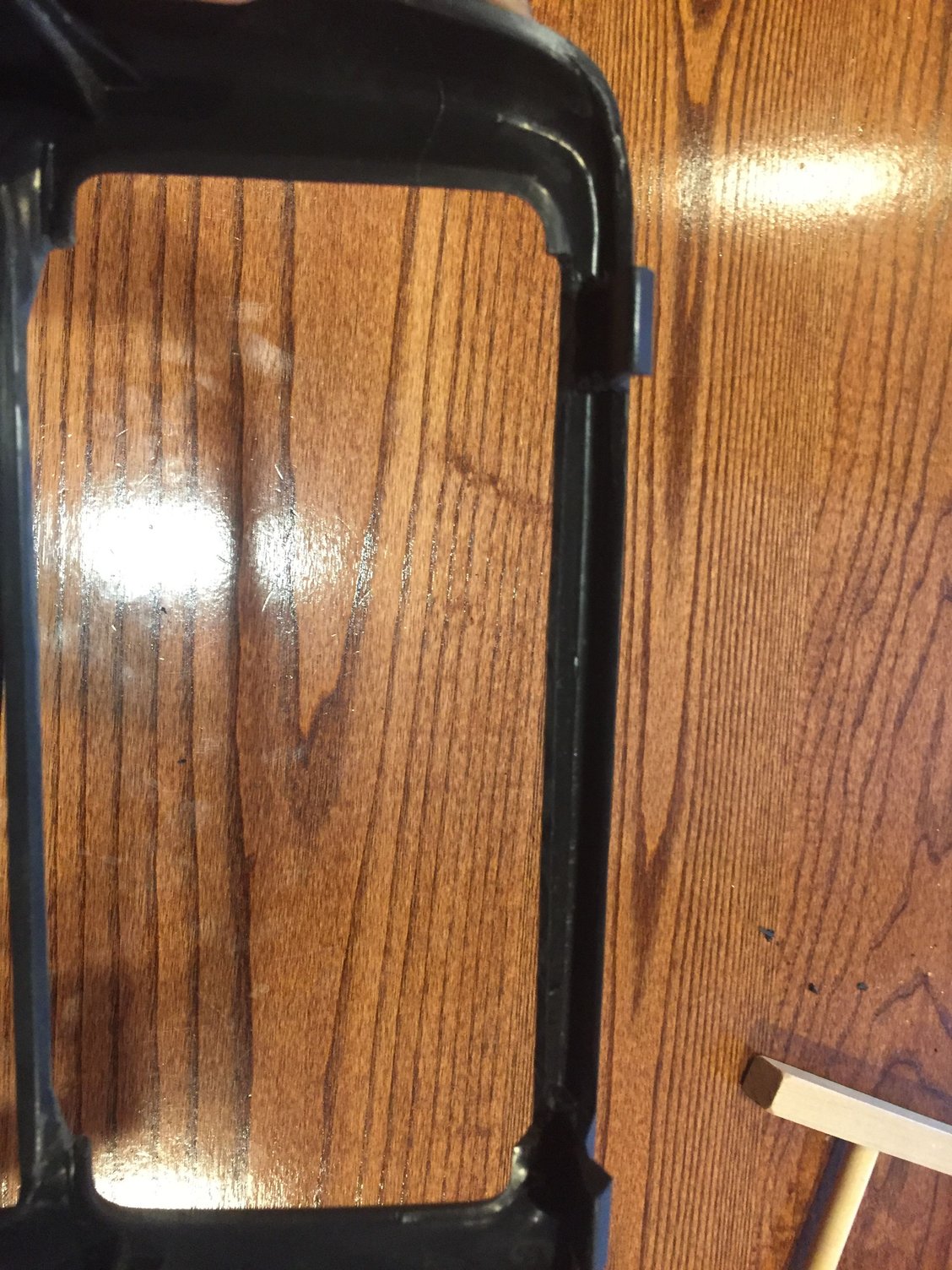

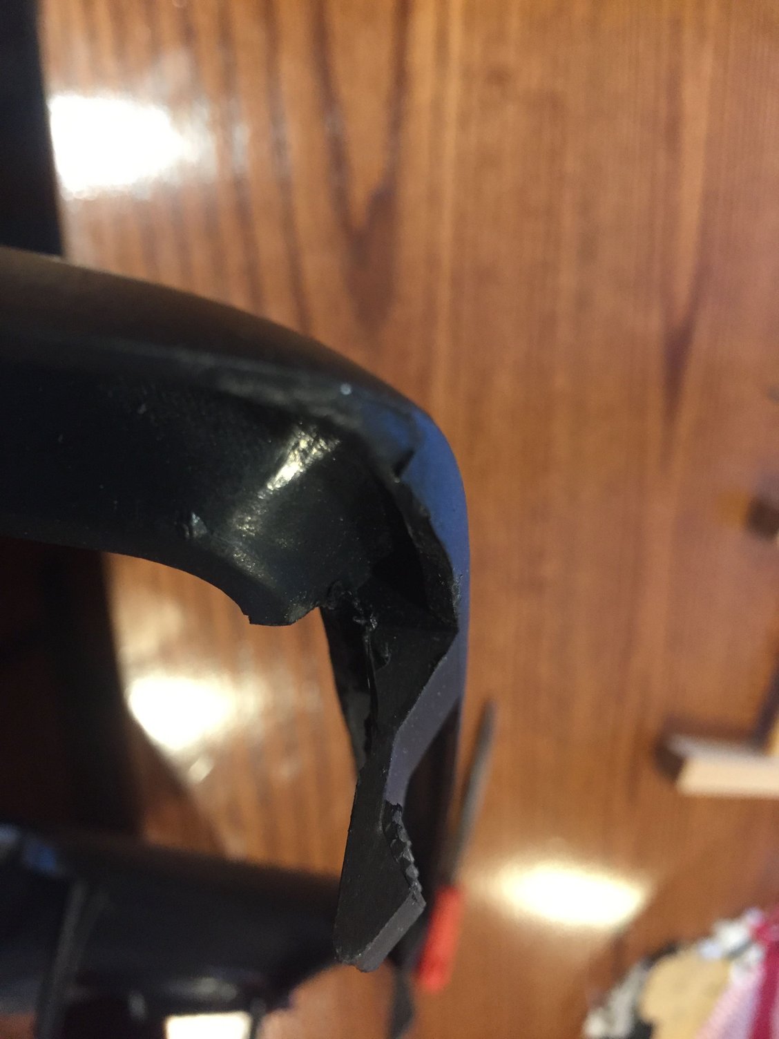

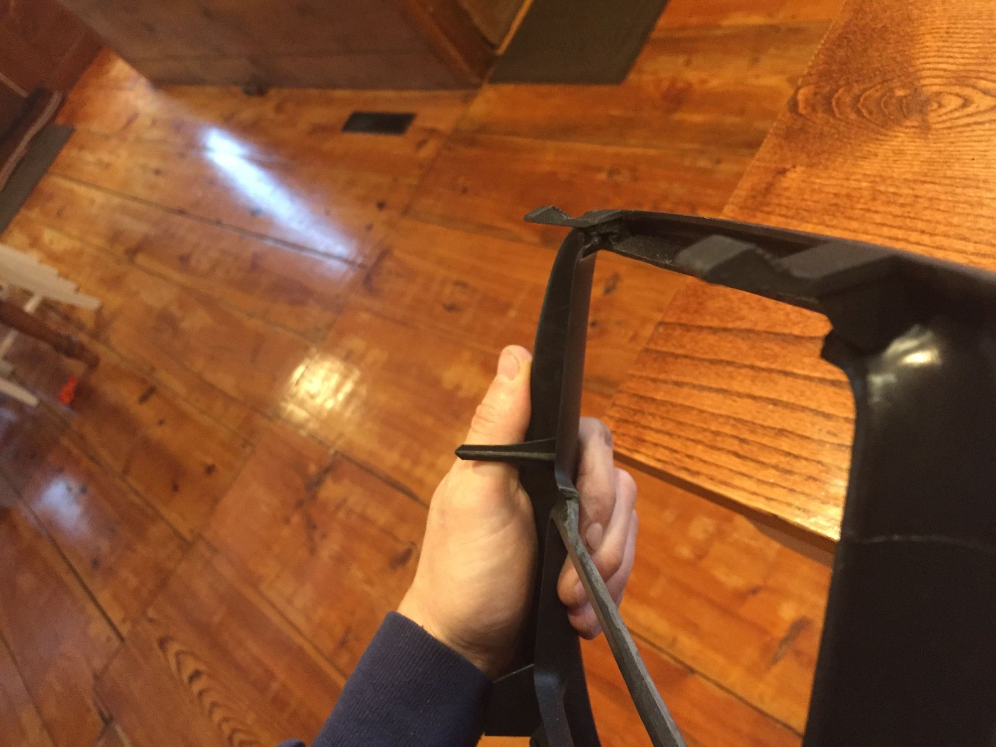

bent these up with some pliers up and out of the way. The radio would then slide back until it hit a lip at the back of the bottom bracket. I took my occisilating saw with a carbide toothed blade and cut that back lip off. With that lip removed the radio could then slide back far enough. Next I made a cardboard cut out of the Pioneer face which would be exposed. I took that cut out and lined it up on the bezel. I used painters masking tape on the plastic to mark where I needed to cut. I then used my dremel with a cut off wheel to cut along the tape lines. I stopped short of each corner with the cut off wheel and finished each cut to the corners with a hacksaw blade. At the bottom you can see the radio tapers up so I matched this on the bezel. You are left with only about 1/3 of the plastic on the bottom. At each corner you would be able to see into the bezel so I used some quick plastic putty to fill this area and then came back after it hardened with a file to make nice clean corners. I Followed with 400 grit sand paper around the whole cut area to smooth everything. On the left and right of the opening I had to cut some plastic fillers since the radio isnt as wide as oem. I attached these fillers with a small amount of plastic epoxy. Finally I used a q-tip dipped in flat black spray paint to paint the cut sections, putty and the side filler pieces. I know that the bezel isn’t as good as the vettenuts bezel. But I think for about 3 hours worth of fab work on the bezel that it looks good. I had to fab up my own radio brackets as well, that just took a bunch of measuring for holes and bending the metal with my vice. This probably took 2 hours alone to do that small part.

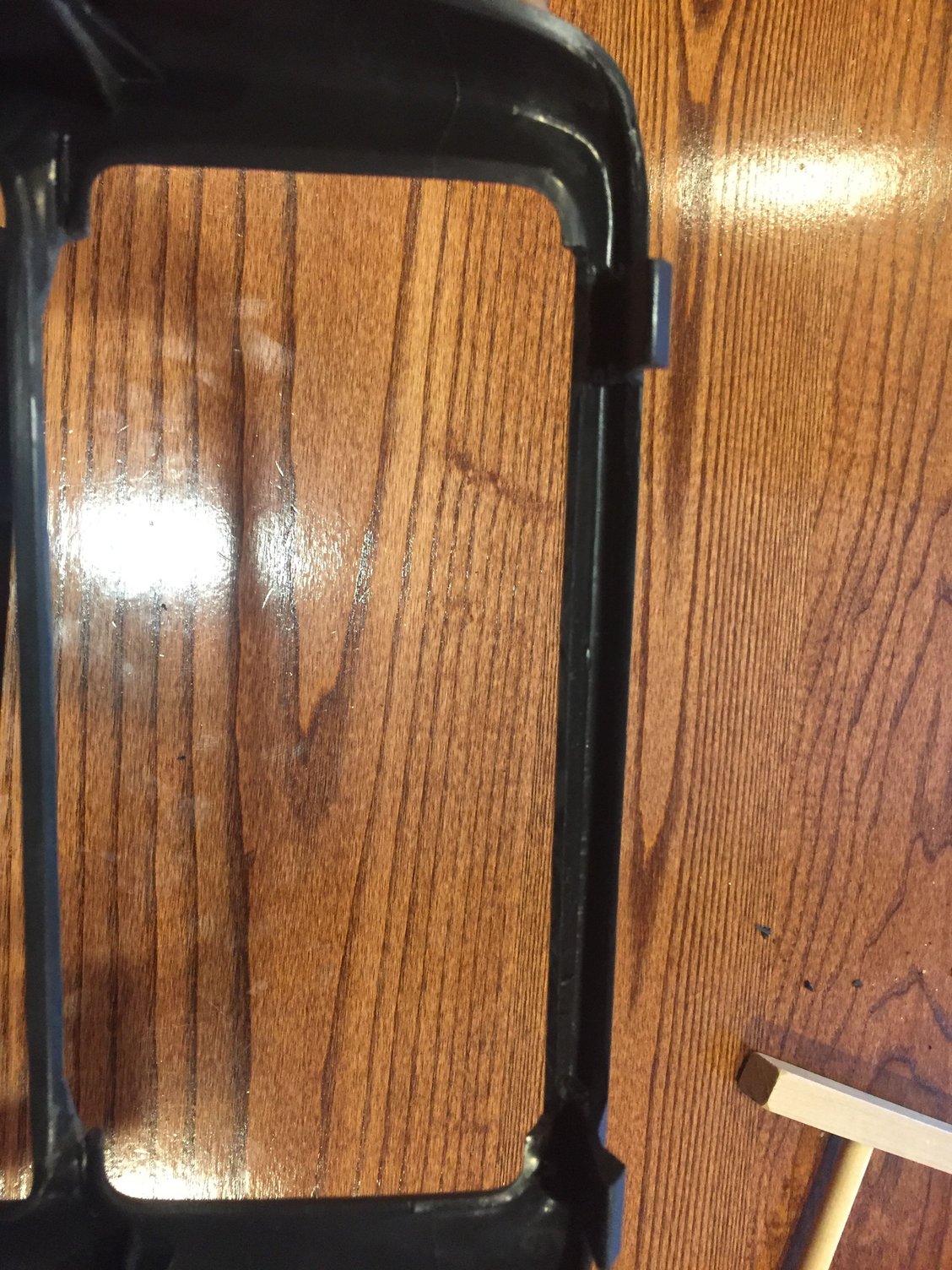

Back side of bezel, I had to cut out some of the bottom support for that upper tab.

Thank you for the compliments. The bottom corners are the area that you can tell that the bezel has been modified even though I don’t think it looks bad since it follows the contours of the radio. I would go out on a limb and say 90 plus percent of people that got in the car would think everything was oem. I really

Looks really good. Just one suggestion. You might want to see if you can move the unit forward slightly. Might fill in the gaps.

Thanks for the constructive criticism. Ultimately that problem lies with the Depth of the units face compared to the oem bezel. The radio has a small lip around it that you can’t see because it is butted up to those two side plastic pieces I added. So it is slid out as far as it can go.

If you look at each side of the radio at the bottom you see where the radio face starts to angle back in. If pioneer had decided to just run that straight across then there wouldn’t be that issue at all. Oh well.
