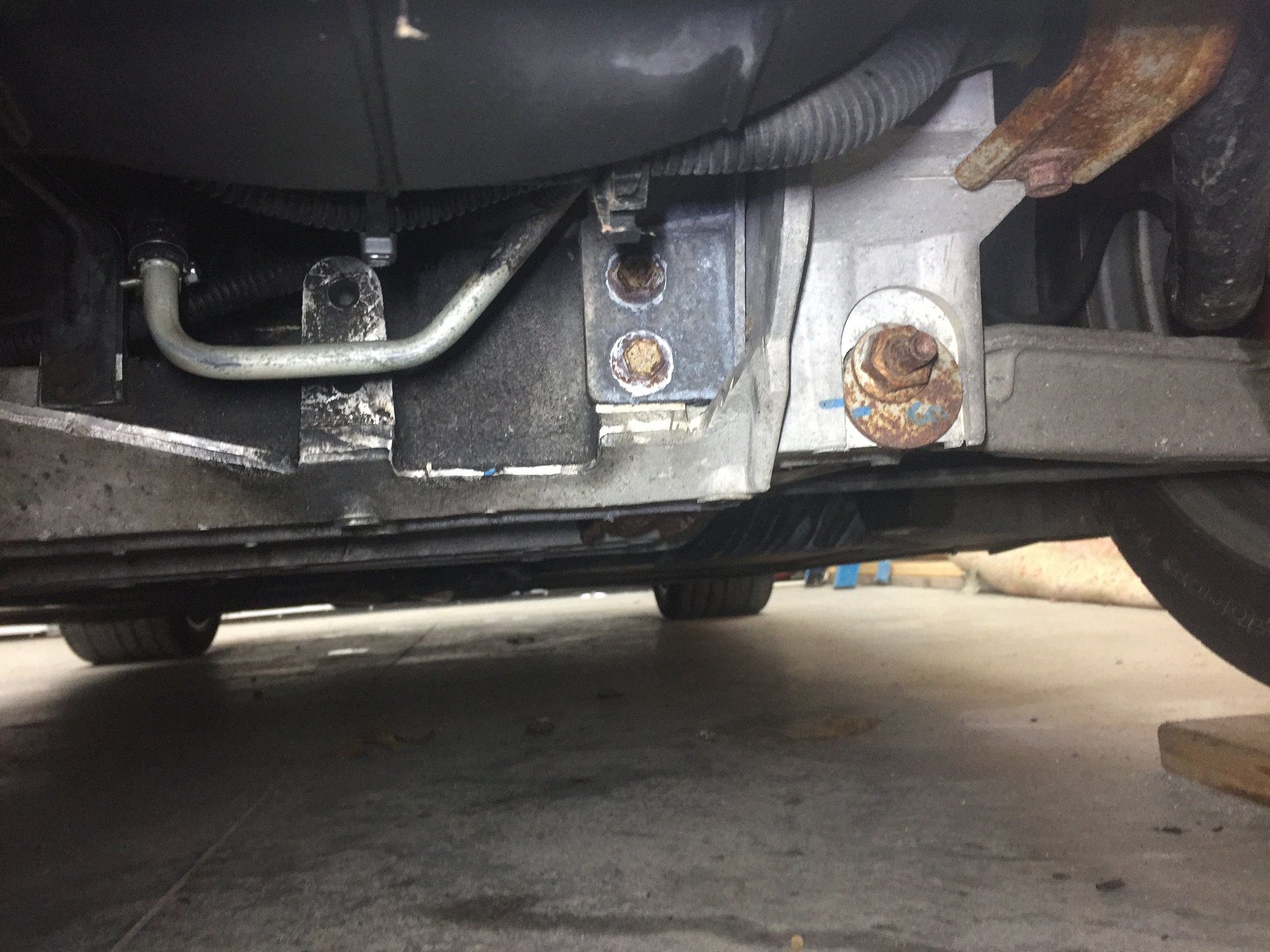

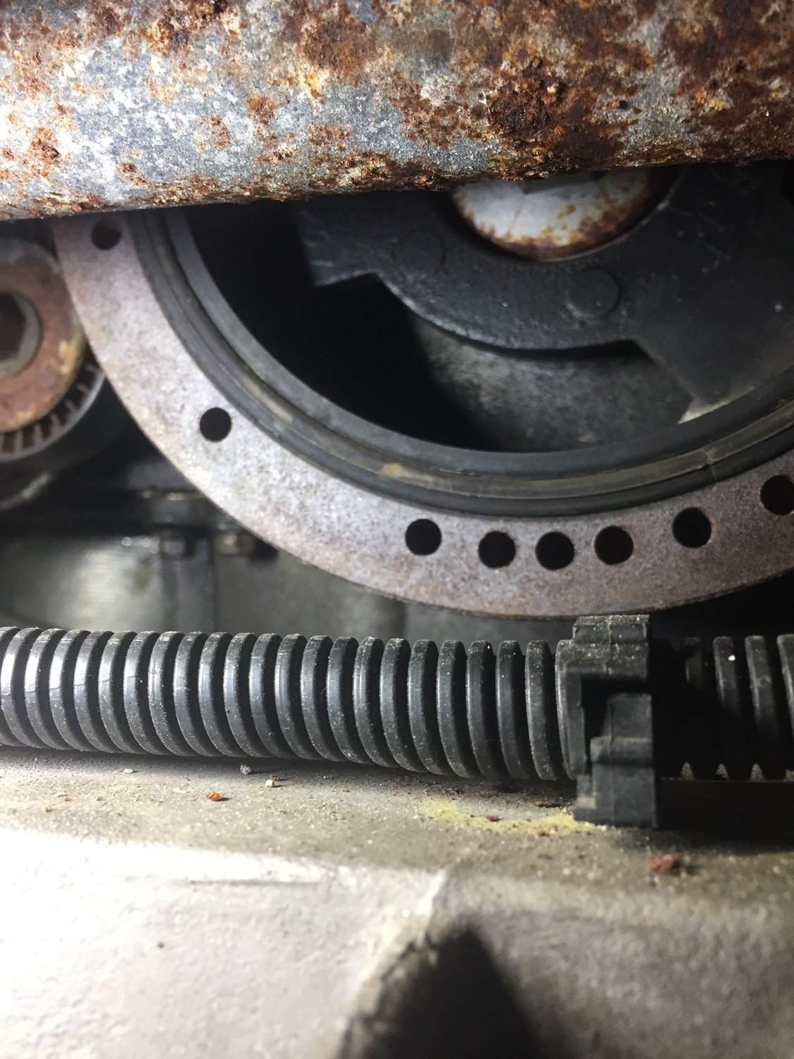

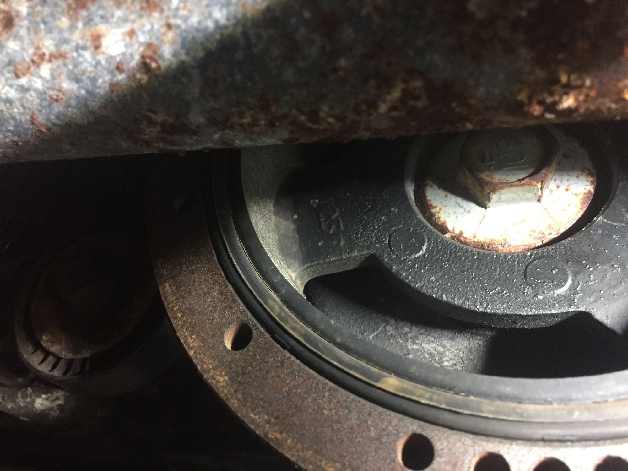

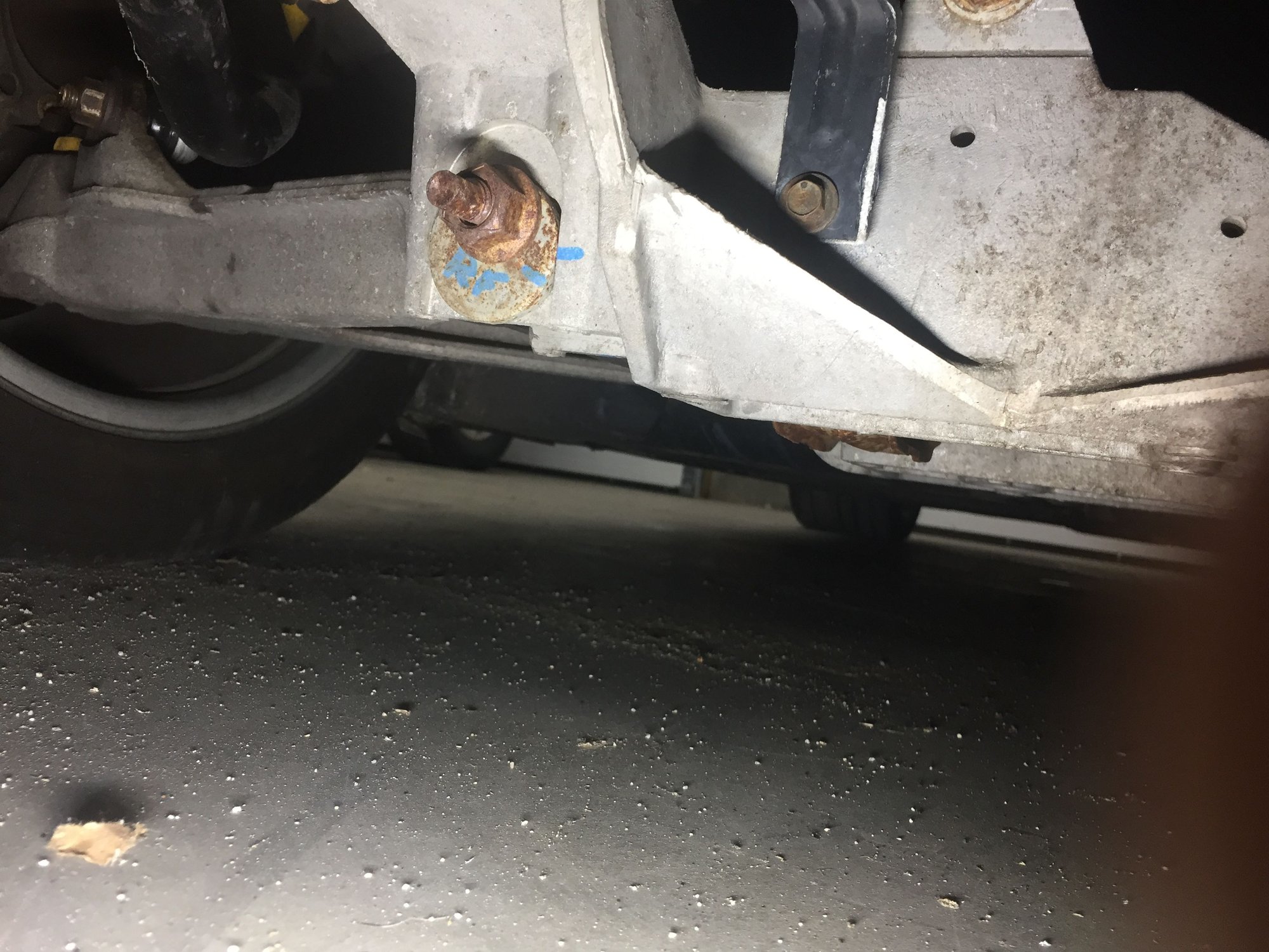

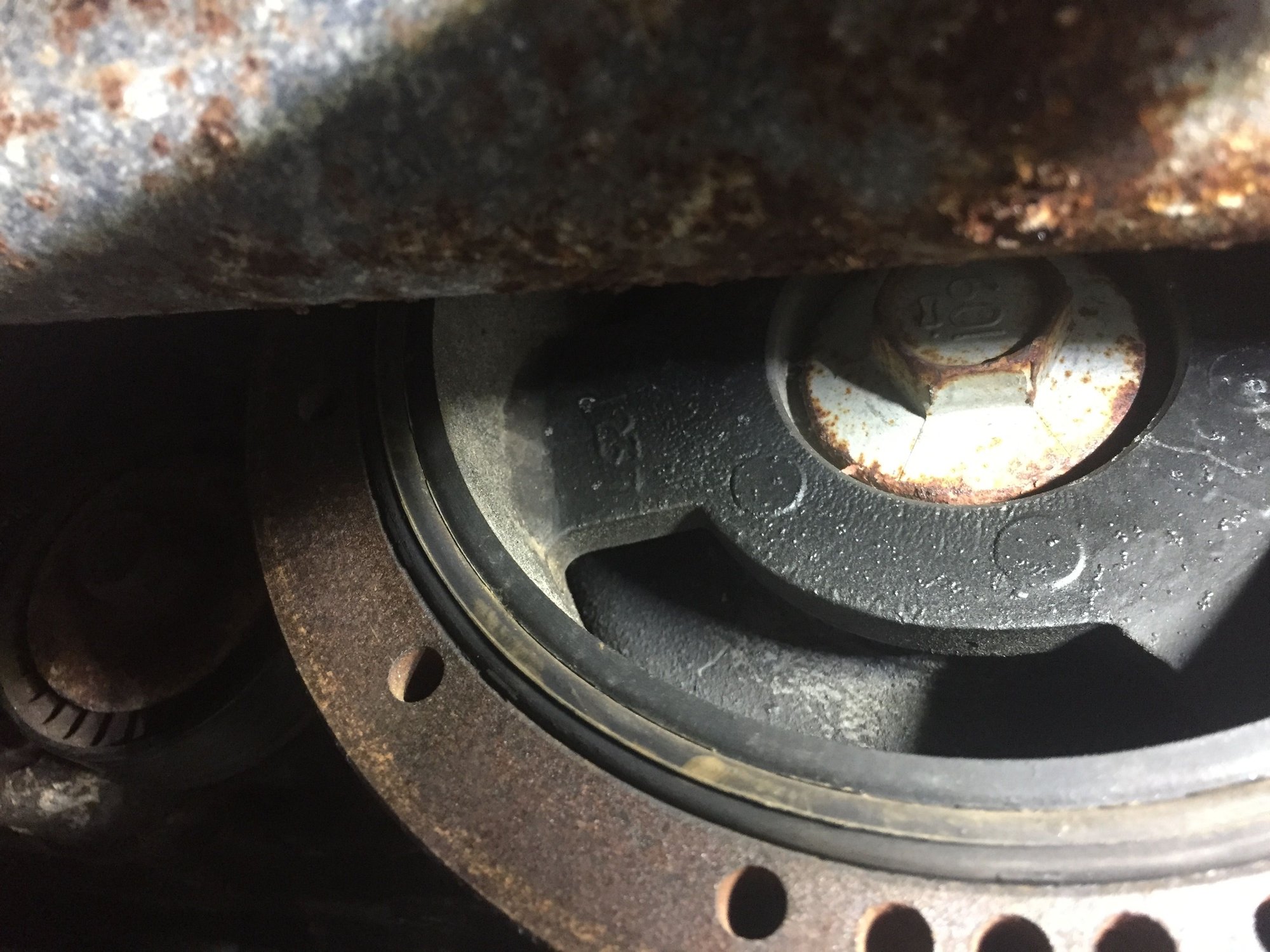

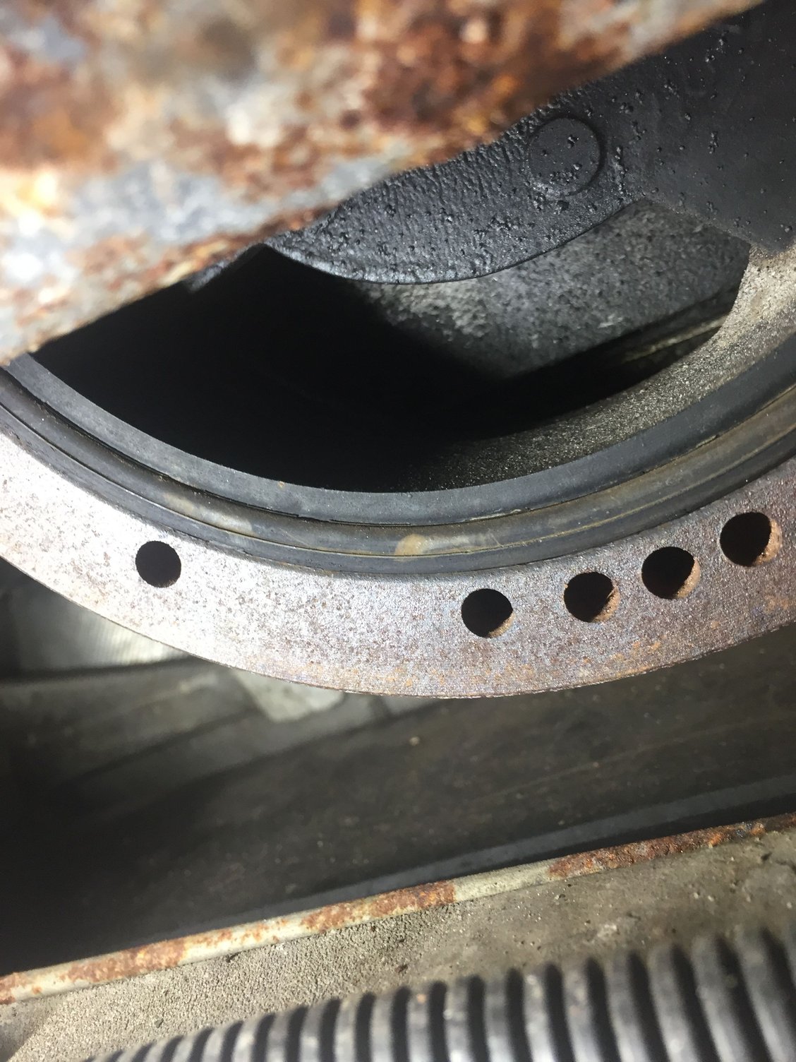

The story is that I don’t have a great maintenance history on the car. It is a 2001 z06 with 44k and has been garaged it’s whole life. My parents owned the car and my mom passed it along to me when my dad died last year. Not having a great starting point to what has been done I went ahead and changed every fluid on the car, did plugs and wires, belts, thermostat and fuel filter. Obviously the balancer is a high failure rate but visually it has zero wobble and zero belt noise. The rubber isn’t cracked either. So I was under the car replacing the power steering rubber hoses and noticed someone had marked the front bolts for the lower a arms. I can’t imagine they came from the factory like that or why someone would have marked them unless they maybe took them off with the rack to do the balancer? I have attached pics below and was wondering if anyone could think of why someone would mark them and if they could glean anything about replacement or not from the balancer. Thank you.

Front cradle could have been dropped and marked for several different reasons. Looks to be an oem balancer and bolt. Based on the rust and weathering I would say this is original and never been replace.
i would mark the balancer and see if there is any separation over the next 3k miles. Im actually surprised there is no squeeling. That ac pulley looks like it’s in horrible shape.

Sounds good. I didn’t think it had been replaced but the fact that it hasn’t seemed to have moved yet had me wondering. As far as marking goes, just run a paint pen from the inner drum out and over the outer drum and watch for any twisting which would show up as the lines becoming offset or the outer drum walking in or out on the inner?

If the car wasn't run hard the balancer doesn't really take that much abuse. I'm a firm believer that it's all the wide open throttle pulls and high RPMs that kill them. It's entirely possible it's original. Even if it was replaced it could very well have been done with a stock bolt and a stock balancer. Either way it's no big deal.

And the fact that all rubber degrades with age and temperature swings.

Those paint marks appear to be on the lower a-arm pivot bolts, that are rotated to adjust the camber/caster of the front wheels. They have no correlation to whether or not the front cradle has been dropped, unless if the cradle was dropped, it didn't go back EXACTLY in the same place. But that would most likely affect only the toe-in and thrust angle.

The A- arms might have been marked for a alignment. Not necessary to remove to change the damper

Thanks everyone. Sounds like it hasn’t been replaced. So moving forward I will draw a paint pen line from the inner drum-out and over the outer drum and check it every so often.
