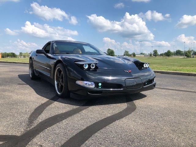

I have installed the 4eyeC5 kit and all I can say is "WOW" I can finally see at night also installed harness for all 4 headlights on at the same time for high beams.
