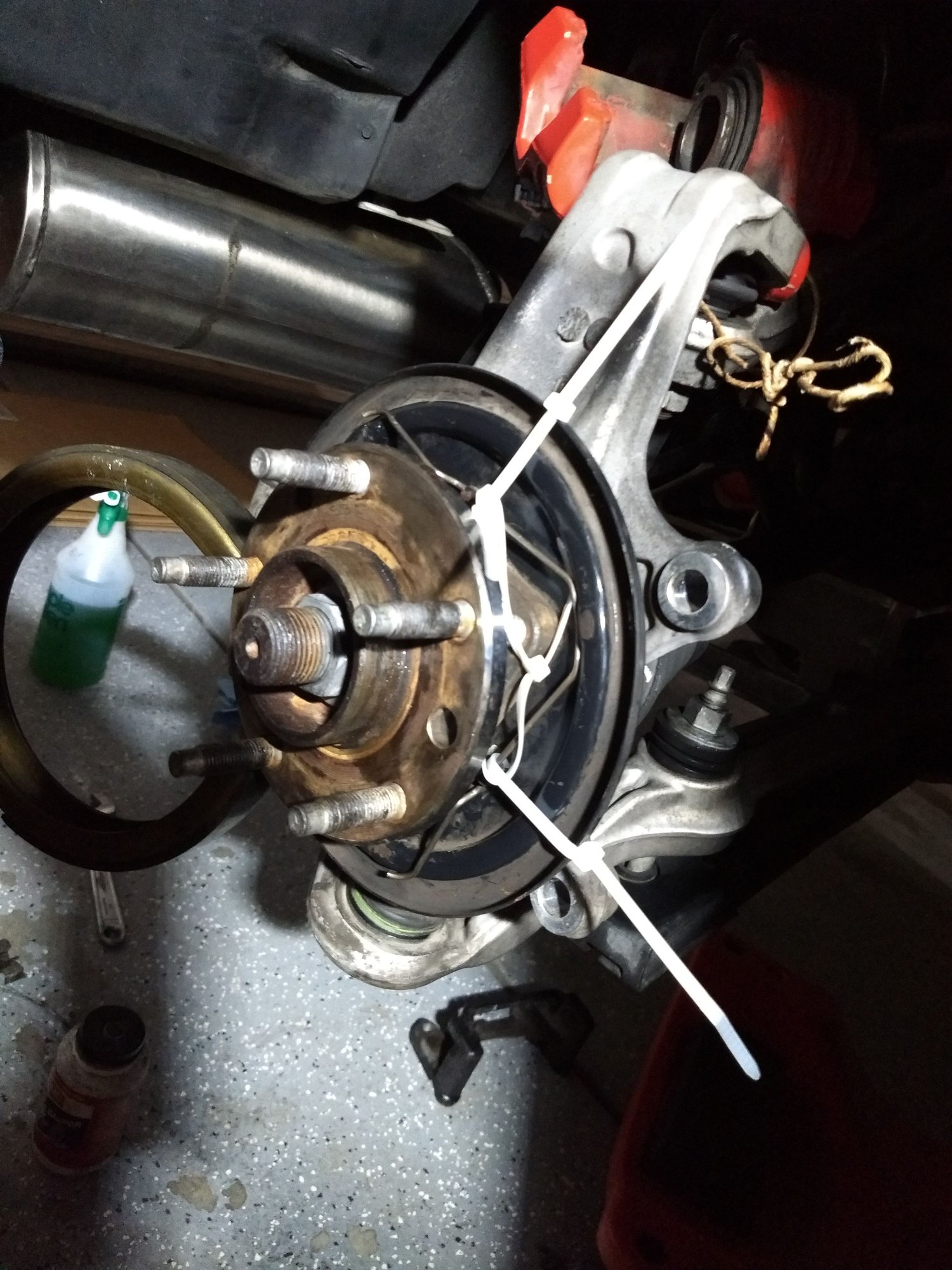

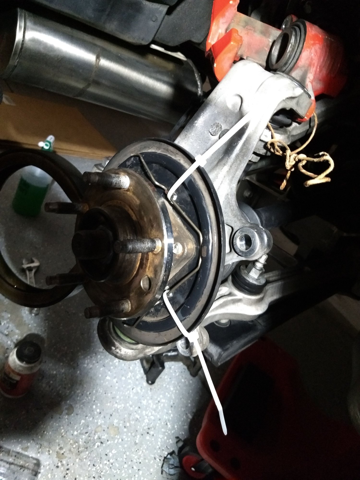

I just thought I'd post these but I did this twice in 10 minutes so I knew I was into something.
The first two hold the clip into the hooks make sure you enclose the clip. You tighten these up as much as you can. The last zip tie is two to make one long one. This double tie pulls both of the zip ties already installed laterally to make it almost impossible to budge. You then just close the shoe as close as you can, reach in and pull the clip towards you NOT to the side. It just pops right in after that. Pull out towards you and outward to pop it into the shoe. NO TOOLS NECESSARY!
You then cut the outside ties and pull them out. Lastly the middle tie which pulls right out. I thought a piece might fall into the shoe but it didn't. You could fish it back out pretty easily if it did but I did it twice with NO problems. I hope this helps someone because it's REALLY easy!
Here's the two hooks with the snap ties anchoring the clip down.
Here's the double snap ties providing lateral force to keep the clip rock solid to the backplate.
Here's the final product after you pop each end of the clip into the brake shoe. At this point you cut the outside snap ties pull them out and then pull out the middle one. It worked beautifully both times.
