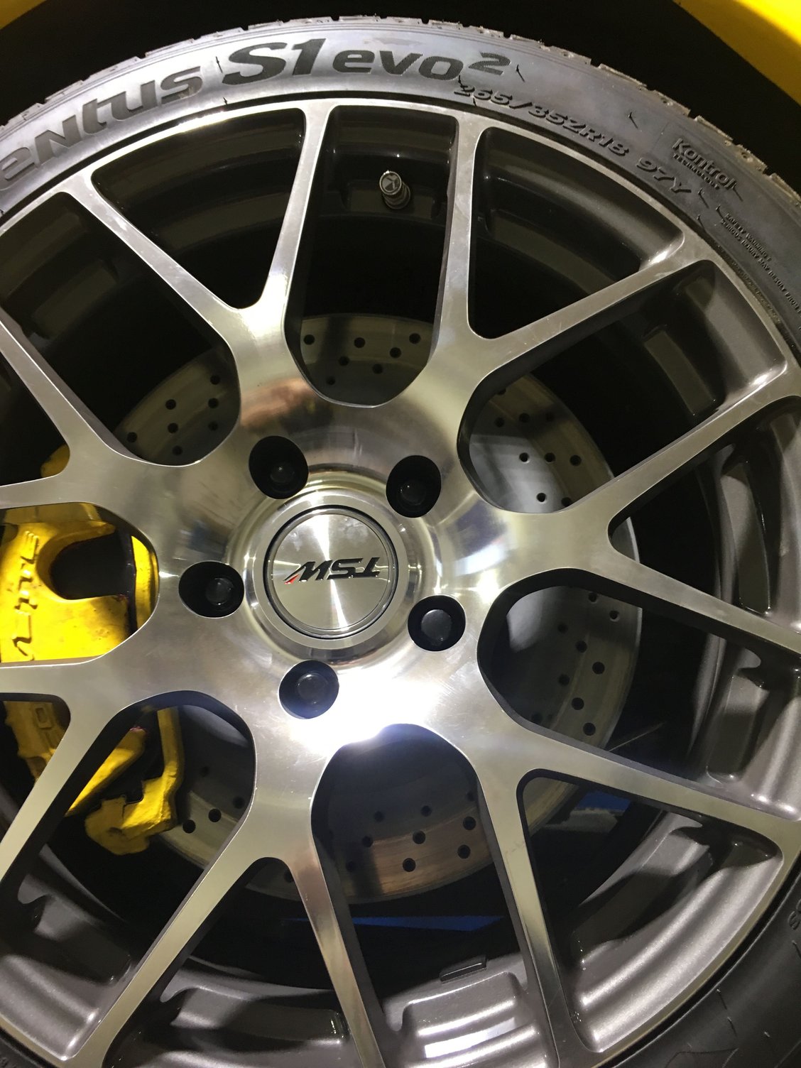

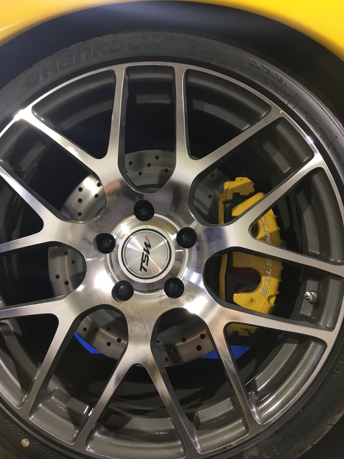

C6Z51 front brake rotor 13.4 inch on C5 18 wheel
C6Z06 rear brake rotor 13.4 inch on C5 19 wheel with retained hand brake, front C5/C6 caliper switched sides, modified front bracket.

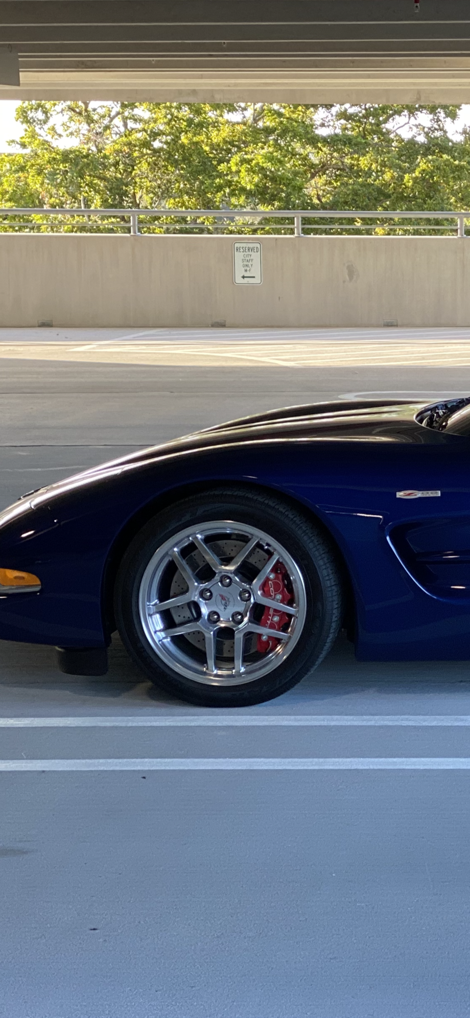

I vote for C6 Z06 brakes as well. Here is my 04 CE Z06 with stock 18” Speedlines front and rear.
Bought pads/calipers/rotors/pins/fluid on Amazon, brake lines from DRM motorsports.
Great visual upgrade and very good brake feel for a street car. Can you do better, sure, but for the price and basically direct bolt on...hard to beat.

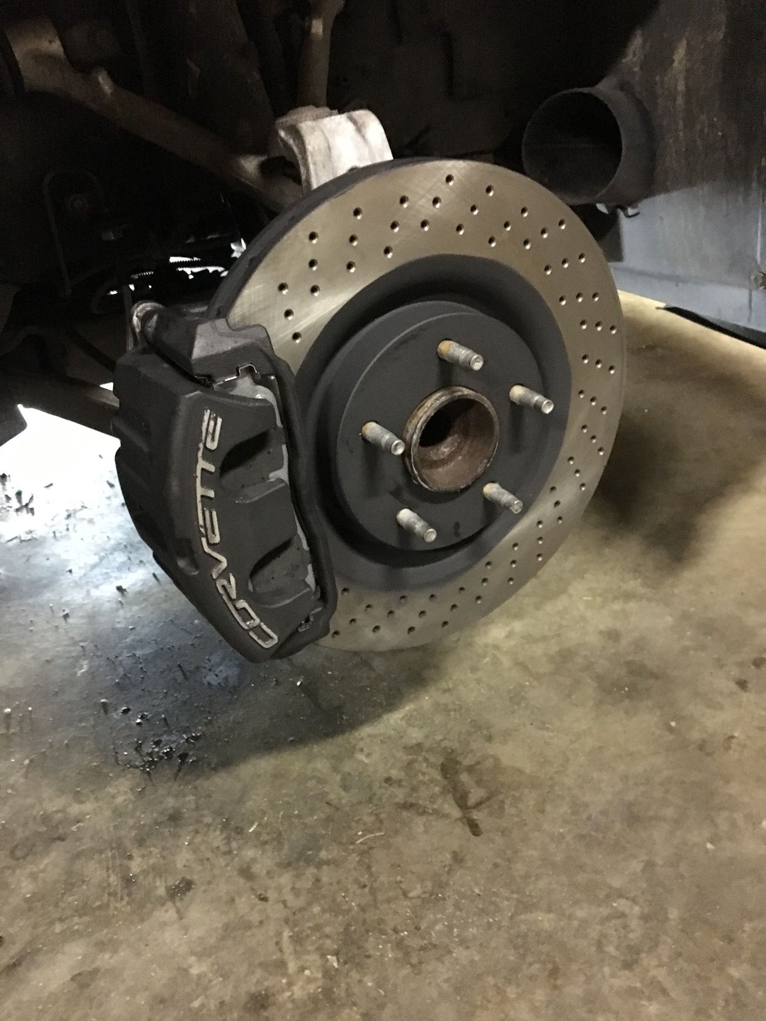

First a word on brake bias i have a 2002 where there are the updated brake bias controlled by the computer this update on 2001 and later.
Front is just the brackets and rotor C6Z51 no hardware modification.

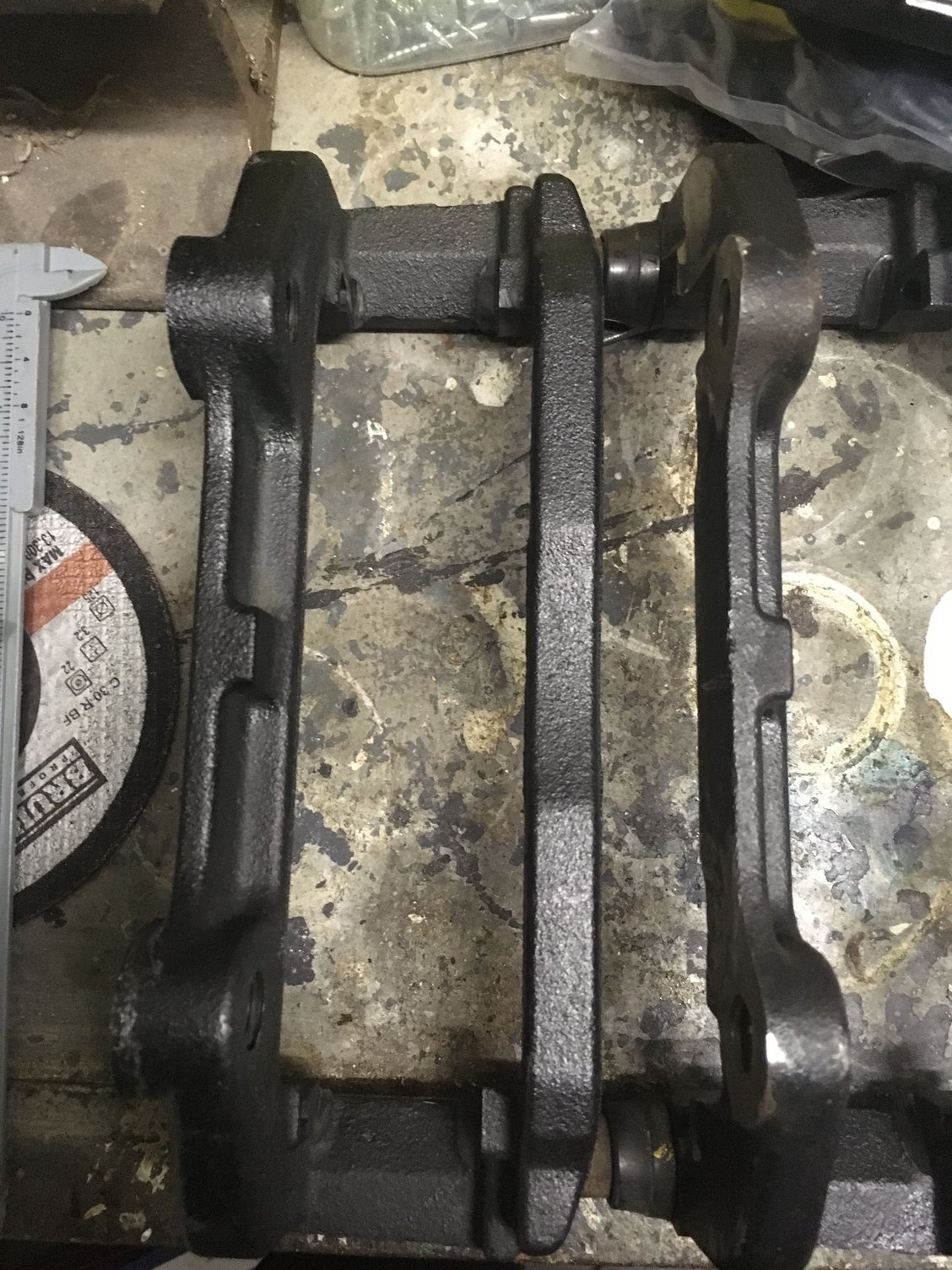

Back is where the hardware work is needed first of all get a pair of C5/C6 front calipers any will work, get the same brackets as for the front so you need 4 brackets in total, the rotors in the back you need is the C6ZO6 this will retain your hand brake function, slightly longer brake line could be needed but if your car is lowered and no advanced driving jumping standard length is ok.
Work to be done is switch side of calipers RF in BL and LF to BR, the bracket needs to be cut like this see picture where one is cut and one is still stock this will line up the caliper, with this mod you will then run stock front brake pads in the back also, i use my car on the track and this setup is great and no problems with braking bias but observe only on 2001 and later otherwise you should change the spring in braking unit.
I can get you part numbers if you need.
