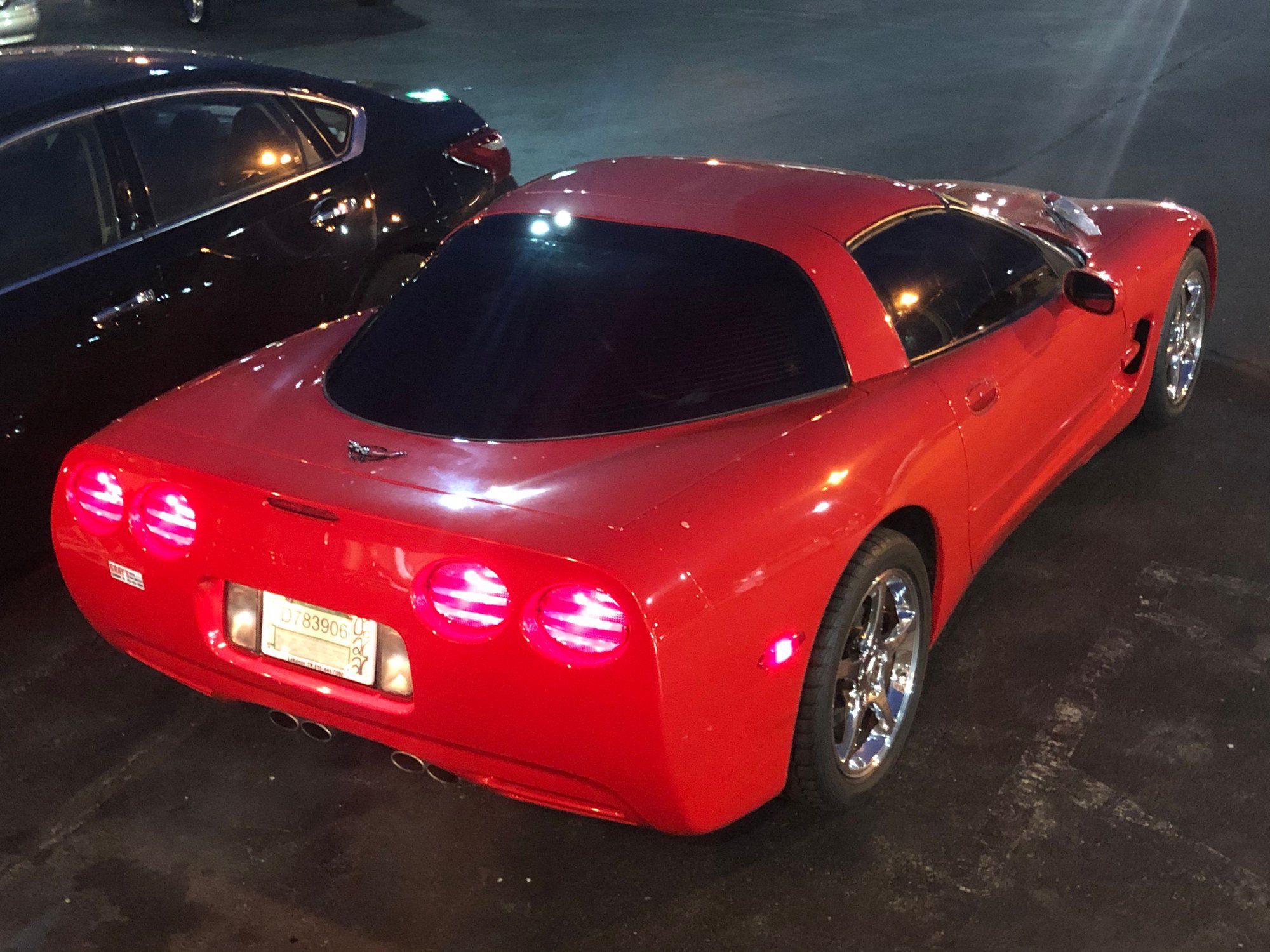

Just got a Torch Red 2001 C5 today after work. On the way home, my gas gauge plummeted to the empty position and the CHECK GAUGES lit up. I’m going to try Techron, maybe that’ll help.
First and foremost, I was almost home, tried to turn on the high beams, nothing. Not even a click from the turn signal stalk. Bad dimmer switch in the column maybe? Any and all help will be appreciated. Thanks.
