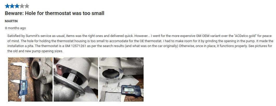

Straight from Summit review on the 251-744, the review confirms that the 1 piece integrated T-stat will not fit in the 251-744. Written 8 months ago.
I'll report back if the 252-846 works with the 1 piece.
