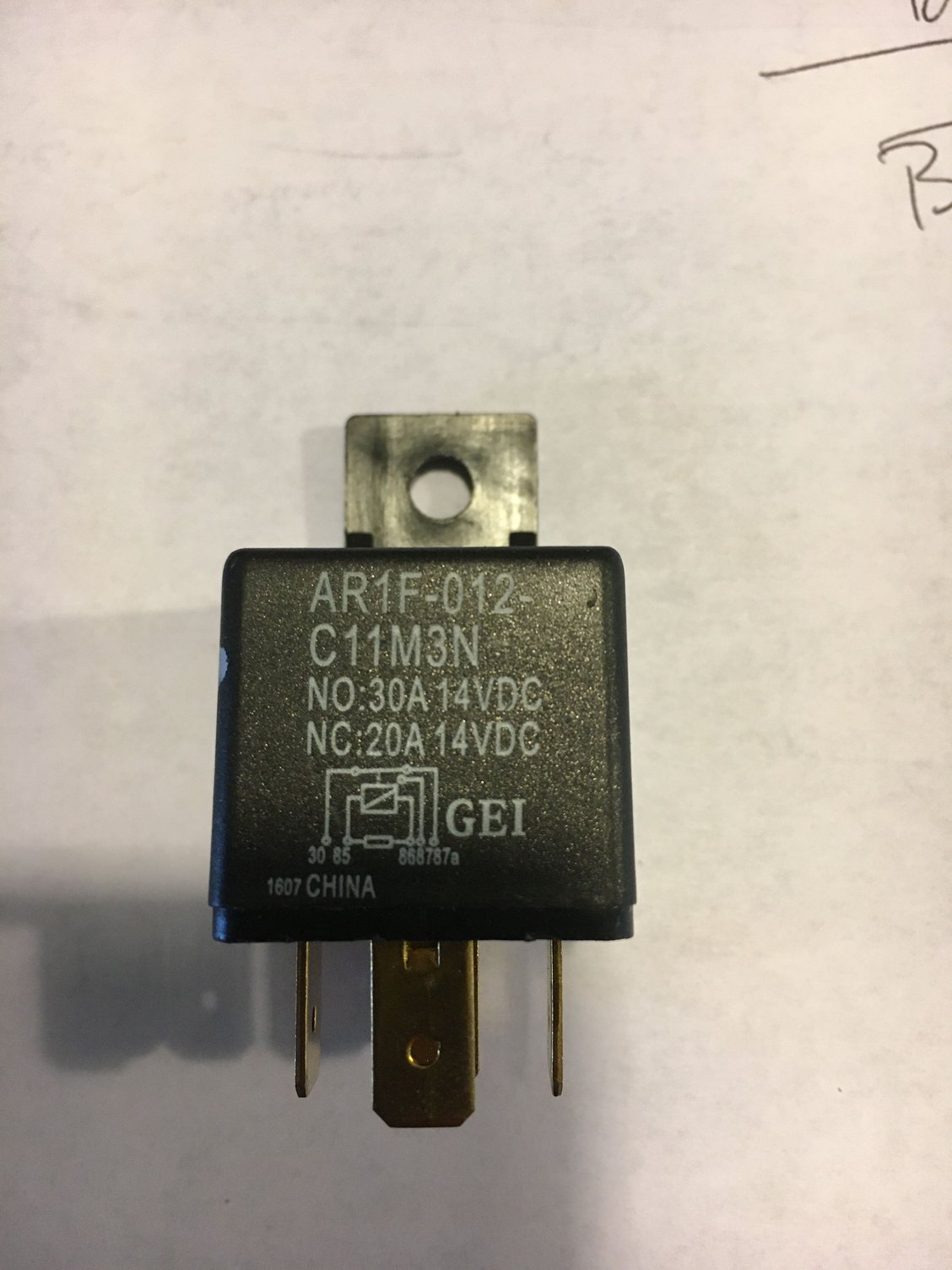

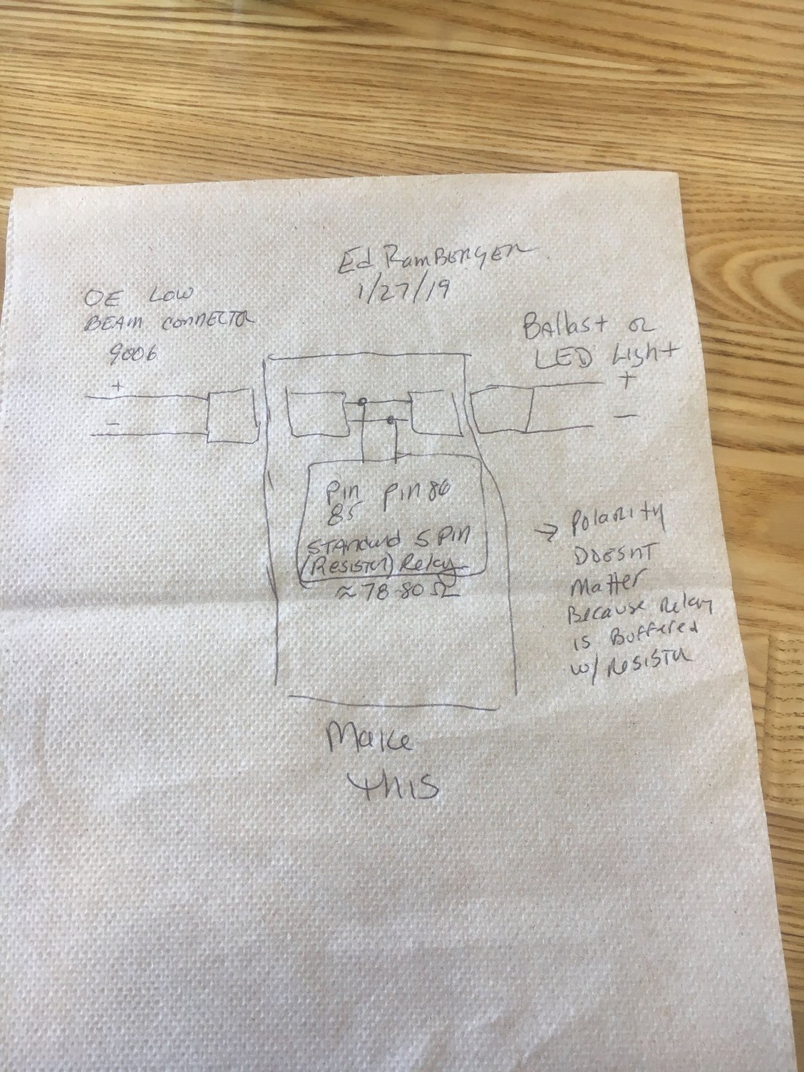

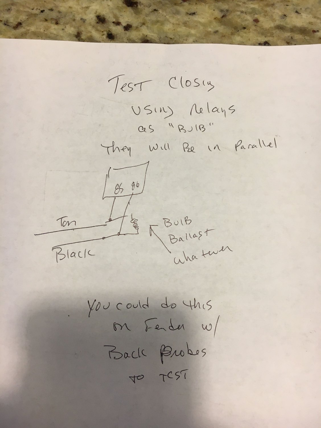

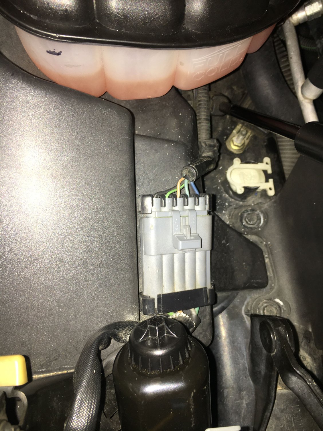

It's an easy fix, people go through this all the time. A hyperflash harness will not fix this - that is for turn signals.
I recently provided the solution to SharpLight Innovations / Radioflyer because this happens when people install ballasts wired directly to the relays.
Everyone thinks that it's because the bulb or ballast does not draw enough current. It is actually that the circuit that closes the headlight doors needs to see CONTINUITY not the high resistance of ballasts or LEDs. When it sees the high resistance of a ballast or an LED bulb it, it thinks that the bulbs are burned out and won't close the doors. Resistance and continuity are two very different things.
One solution is to flash the brights, but that's annoying.
People wire power resistors in parallel and that's bad because it draws a LOT of current and makes a LOT of heat. Others wire in anti-pulse capacitors but that's not the proper solution either.
All you need is something wired in parallel that will allow the signal to flow through it when the headlights get turned off. You can do it with a bulb or with pins 85 and 86 of a 5 leg relay. The relay uses a TINY amount of current, makes no heat and is reliable.
You can get the ends to make a plug and play solution, or you can just wire a relay using pins 85 & 86 (or little side marker bulb) in parallel with the positive and negative wires of the low beam headlights. You can wire it in anywhere - even at the flat connector near the fenderwell (just look at what 2 wires run to the low beams).
In the pictures below you see all you have to do is wire pins 85 and 86 in parallel between the power wires for the low beam. You can go online and buy connectors and make a plug and play which is what SharpLight/Radioflyer will be doing, or just tap into the power wires in parallel for the relay. Make sure the relay you use has the schematic I show. Some relays have a diode in them and that is not what you want.
I have a video of my headlight buckets opening and closing with NO headlights installed at all - just the relay to fool the headlight module into thinking the bulbs are good.
In my opinion, light kits should use the car light connector to trigger 85 and 86, then power the ballasts through the relays. That allows normal circuit function of the car and isolates the lighting circuit from ballasts.
After I went through all of reading the schematics and trying this, I came across an old post by TSUMI talking about cutting the wires by the headlight module and putting in a relay. When I came across that, I laughed because he had solved it long ago and I didn't find it before I came to my solution and could have saved some time.

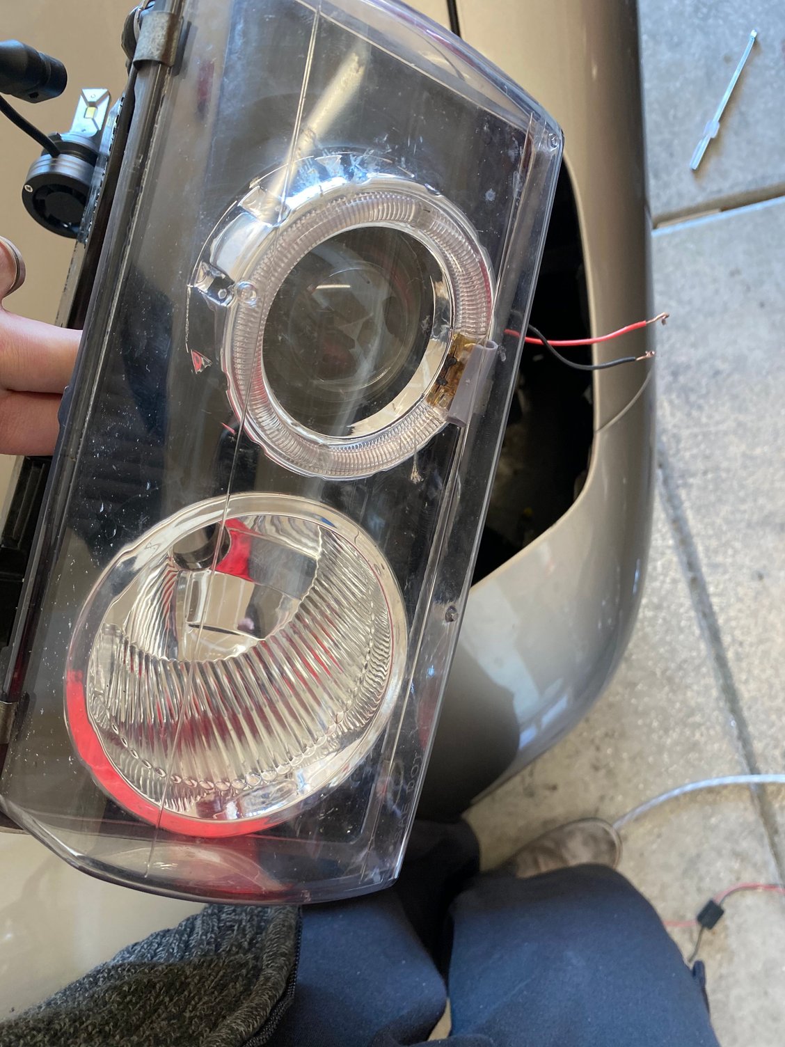

Here is what I had and the old lights housing as well. It’s more of this issue I I will picture where the housings on accept a hid slim h4 ! Plus it’s become a hassle to align the beam one headache after the next!

No idea they were on the car when I bought it! They have halo’s built in! They work but they stock adjusting pieces look bent . U should see the light beam lol its beyond re aligning tried for 6 hours yesterday before I said no more that’s it be gone ! My guess is they were some eBay stuff and the previous owner took out the stock lights because I see they worth a pretty penny online! Hell I would have done the same before I sold it !
The previous person had it rigged it on there one day the stock cover broke in half ! That was 600 bucks for a new one painted ! Also I’ve found another top bracket piece was broke in the back as well. It just added up to like wtf! So I’ll most likely soon list up the assembly and get it gone as I will never need it again or face future motor troubles with them!
